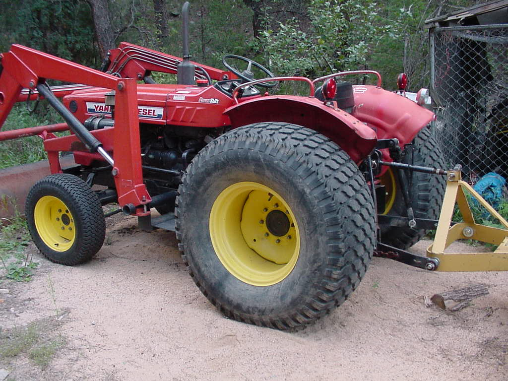

Here's an example on our 336D N&Rs YM336D.jpgNancy's tractor with turf tires.JPG:

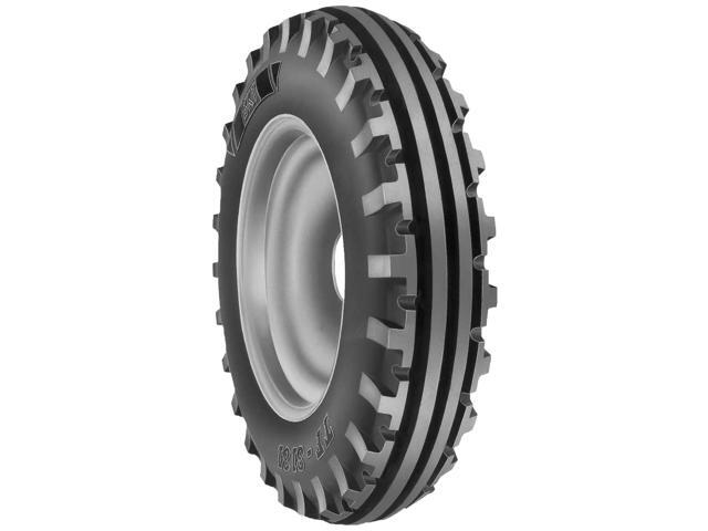

Those ALLIANCE 303 F2 must be very popular because they are out-of-stock at most places or priced thru the roof on existing sites. I can't find the Firestone within a reasonable price. 1X is a mere $118+tax+shipping.
I have a Mavis Discount Tire up the road, but they don't stock the 5.00-15 as normal inventory. Alliance 303 F2 TT | Mavis Discount Tire So it will cost more and there is a delay. :rolleyes:
After much digging, the Alliance tires are on back order out of Korea because they are now Yokohama owned.
A middle of the road tire is I can find presently are:
or
From what I gather, the BKT tires or as they call them tyers, are made in India. India has good rubber resources. Free shipping too!
The ASC tires didn't list a brand. That was troublesome. 2X shipped is $188.
