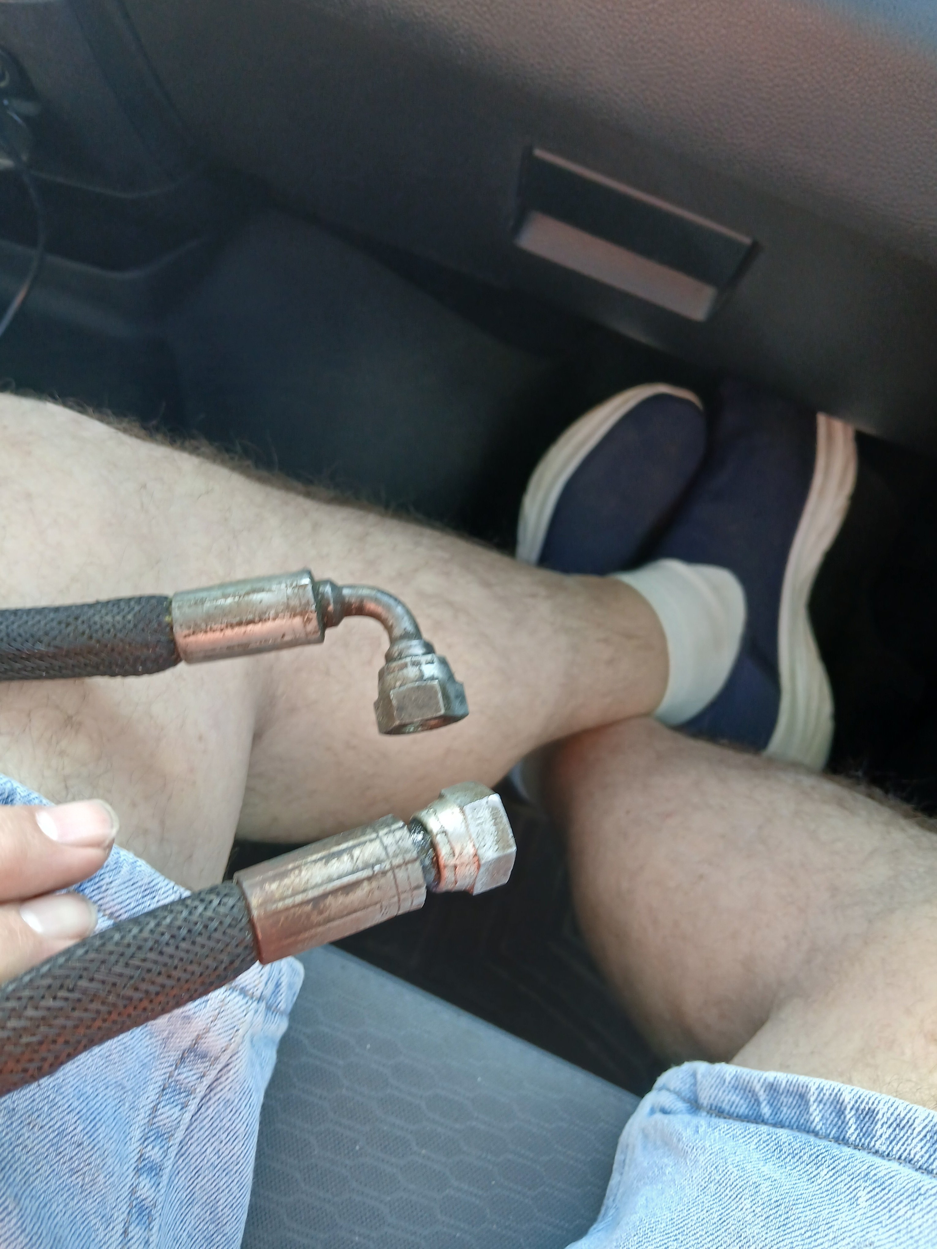

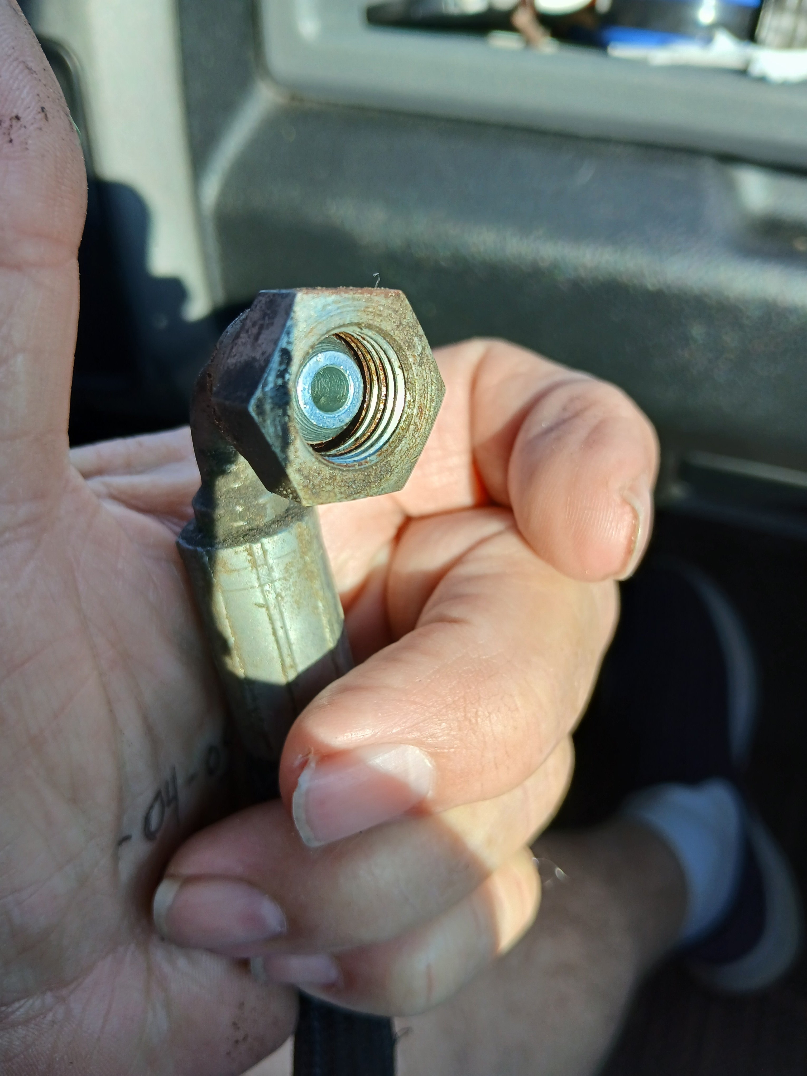

I have an old backhoe attachment for my tractor. I was made in Italy. These fittings are for 1/4" hose and have an inverted flare with 1/2"×20 female end. In other words, the flare is outward instead of inward on a jic connector.
If anyone knows what the term is for these(besides backasswards) or where I could purchase some please let me know.
I will try to attach photos soon
Thanks

1/4" BSPP fittings is what you're looking for. We just really call it BSP because it's a super common type of fitting in this side of the pond but I call it BSPP in the forum so it doesn't get confused with BSPT that has tapered threads and is not really used in hydraulics anyway.
It has a 60 taper that does the sealing. The male end as the taper going inwards, while the female end (with the nut) has the taper facing outwards.
1/4" BSPP has 19 TPI and close to 1/2" OD.

Thank you very much! That's it.
Never thought hydraulic fittings could be this complex.

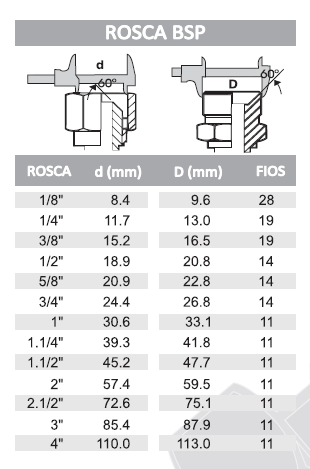

And here is a list of/for confusion....
