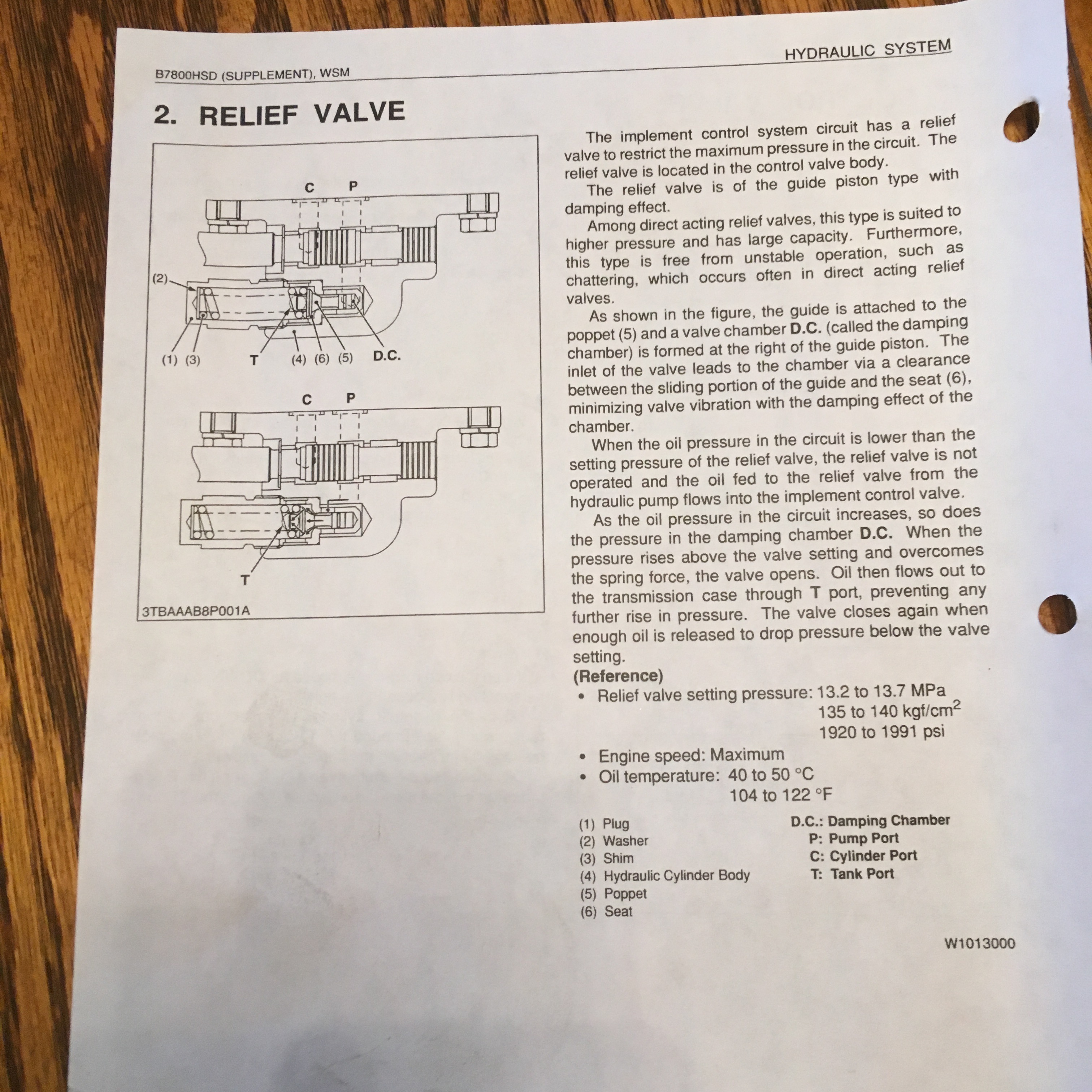

I need to locate the 3ph PRV on my B7800.
I have accessed the Kubota illustrated diagram,
but somhow I am still not seeing it on the tractor.
Hoping someone knows where The PRV is located on this model.
   / Trying to locate the 3ph Pressure Relief Valve on my B7800 #2
In the WSM it says it is in the control valve body.I will try to attach a copy of the page.

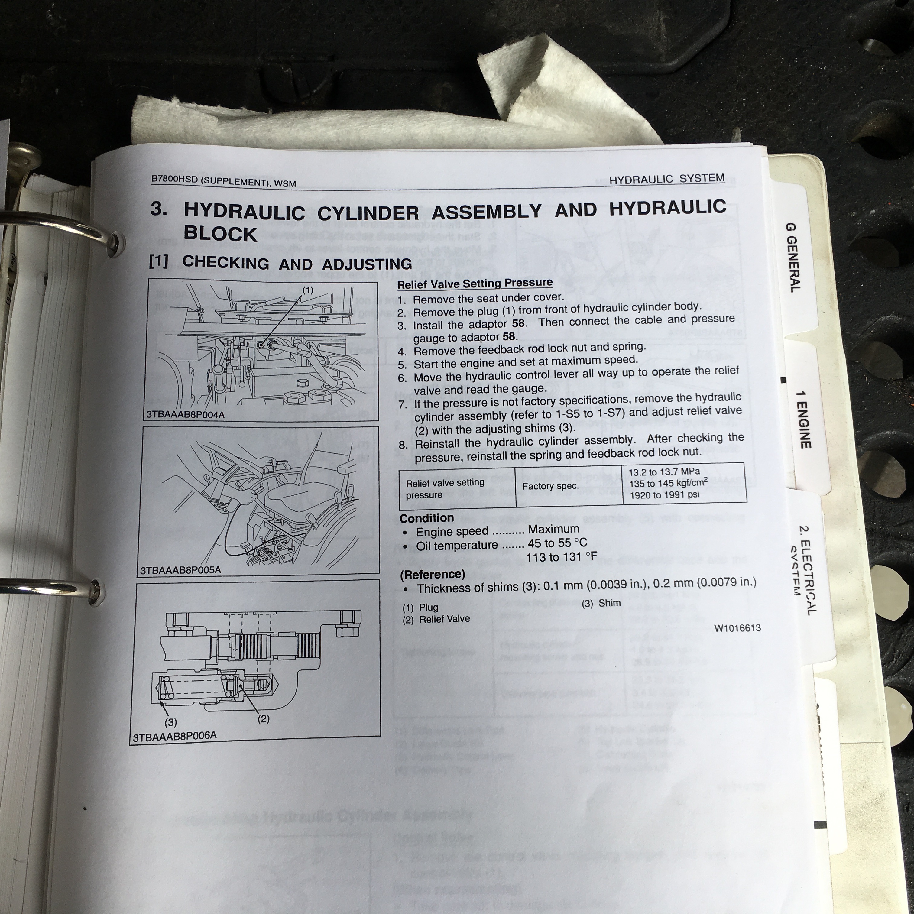

Hydraulic relief valve adjust.jpg I'll try to attach a photo of the page from the WSM on how to access the valve
   / Trying to locate the 3ph Pressure Relief Valve on my B7800 #10
Jim,
That's actually great info ... and shows the value of having (or having access to) a WSM for equipment you own.
It contradicts what I previously told the OP, in terms of the orientation of the hex head plug capping the internals of the PRV.
The problem was that the exploded diagrams in the parts look up appear to show the PRV located in an incorrect location (left side rather than right), with an incorrect orientation (facing forward ... rather than facing right)
In hindsight I should have checked my WSM rather since I think it covers the B7800 as well as the B2910 ... rather than just replying on Kubota's online parts look up.
Too bad Kubota doesn't take greater care when making up the exploded views they use on the online parts look up.
