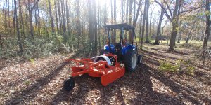

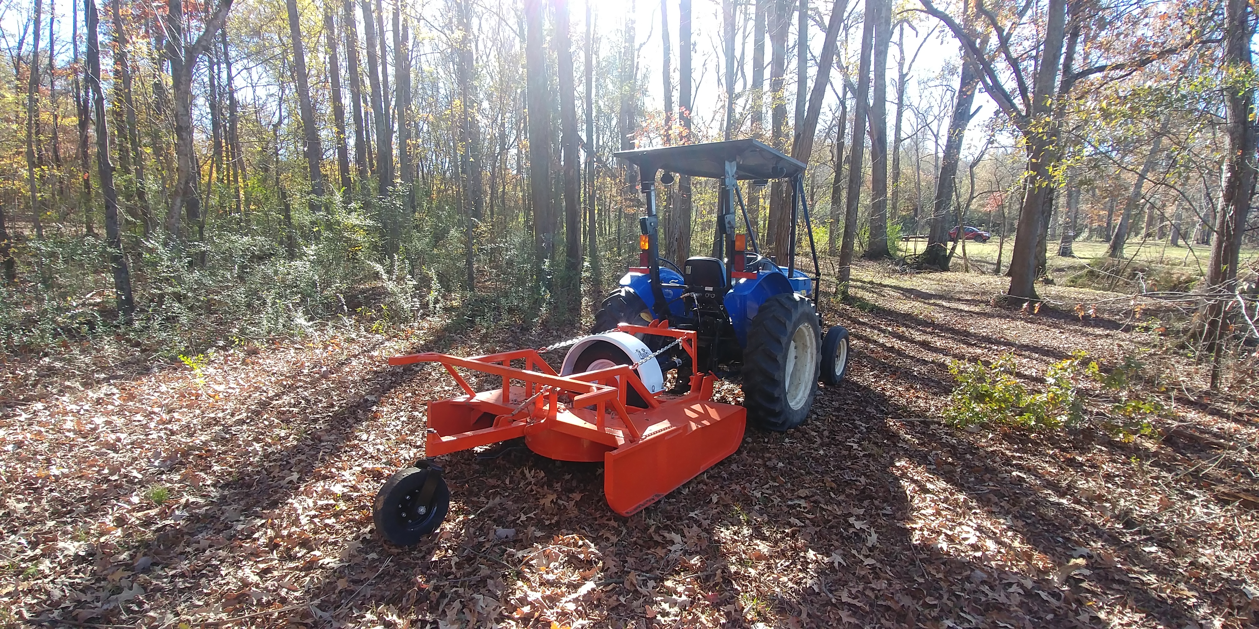

Tire drives are pretty awesome. We run or Brush Beast off a New Holland TT45A (35 PTO hp). 1516585877417.jpg

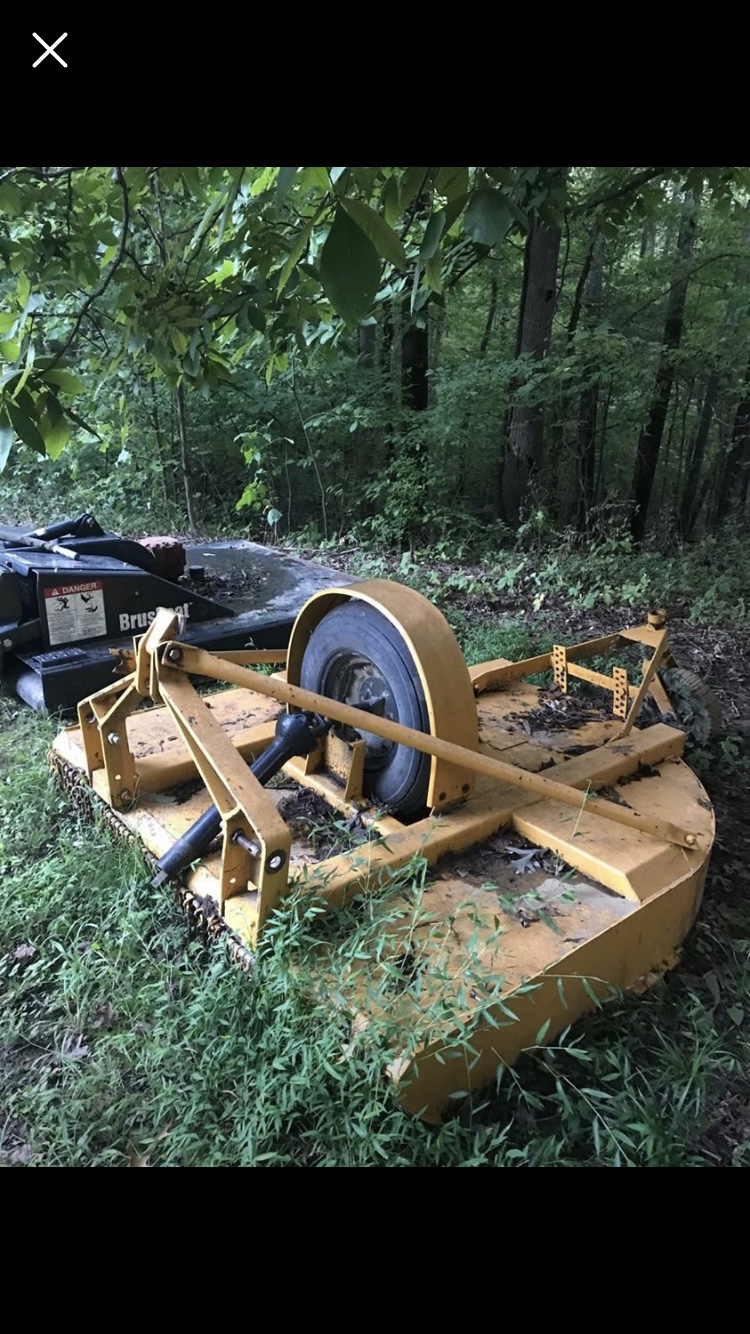

This just came up on local site: good price. Any feedback on it for my L3130? Will my tractor have any issues with it? 6’ ( may be 66” not sure yet)
I have 2 of these. They are Sidewinders. No longer made but parts are still readily available. They are bullet proof. The tire powers the fly wheel, so there is no clutch to worry about. It is very heavy. If I was anywhere closer, I would get it. How much are they asking for it?
$800. Not bad I don’t think!

This just came up on local site: good price. Any feedback on it for my L3130? Will my tractor have any issues with it? 6 ( may be 66 not sure yet)
If your tractor will handle the weight, go for it. :thumbsup:
In thick brush or tall grass, you can mow less than full width.

In the 20+ years I have used my Sidewinders, I have never had anything get wrapped or jammed under the tire. They've been used to cut some pretty rough terrain and over 100 acres of pastures each year and still have the original tires. There are shims under the bearing blocks that are removed as the tire wears. Don't have to worry about clutch plates or shear pins.

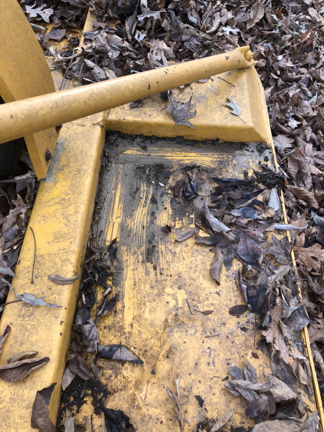

Went and looked at it. Would be too heavy and too wide for my 3130. But a dang heavy duty brush cutter though! IMG_0810.JPGIMG_0809.JPGIMG_0808.JPG
