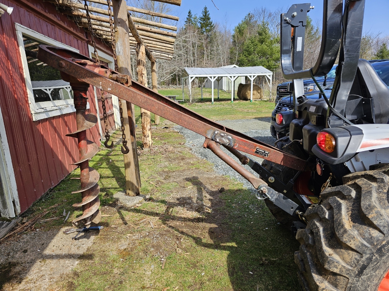

The brackets for the U piece are welded on.
Just make your own brackets and fasten them on underneath. Don't drill any holes just bolt then on with a clamp system. It doesn't even need to be overly robust as you can brace the clamp up against the top brackets.
I don't know how many holes you have to dig but it's almost sounding easier to go and dig the holes by hand.

Haha. Yeah, he is my wife's great uncle and lives over 100km away, and hist tractor is likely 10,000lbs, so even a car hauler wouldn't get it here.
I thought about building an extension...
I couldn't stop thinking about it, so I went out and took it apart and flipped the gear box so I could get more lift. But at 90% lift it over centers. Even if I was careful not to go past 90%, that geometry puts a lot of strain on things. The frame is so bent on it, I could barely adjust my lift arm enough to get it vertical. By the time I got it straightened, I only had about 70% lift before the one arm over centered.
While working on it, I also noticed that the gear box is cracked. I could try and weld it, but welding cast likely wouldn't take that well or be that strong. With my luck it would fly apart on the first hole I dig.
If it was mine, or he'd sell it for $100, I'd build a new frame as mentioned before, and take my chances with the gear box. But I think for now, I am officially done with it.
I did my best to save a buck, but I am just going to buy the Princess Auto (Canadian Harbour Frieght). They are $1000CAD which is half of what people are asking for used Frontier/Woods/Land Pride augers. For the 200 holes I do this year, it will be good enough.

Which leads to the next question. The owner hasn't used it in 30 yrs, will it attach to his tractor?:unsure:

You could get the digger as high as it goes. Then a scoop or two with a shovel and you could pre-drill the hole by 6" and give you adequate clearance. A bit of a pain to use, but perhaps possible.
The cracked gearbox is another issue though. I wouldn't use it with the crack. So, a repair is probably in the future. Reinforce it too?
