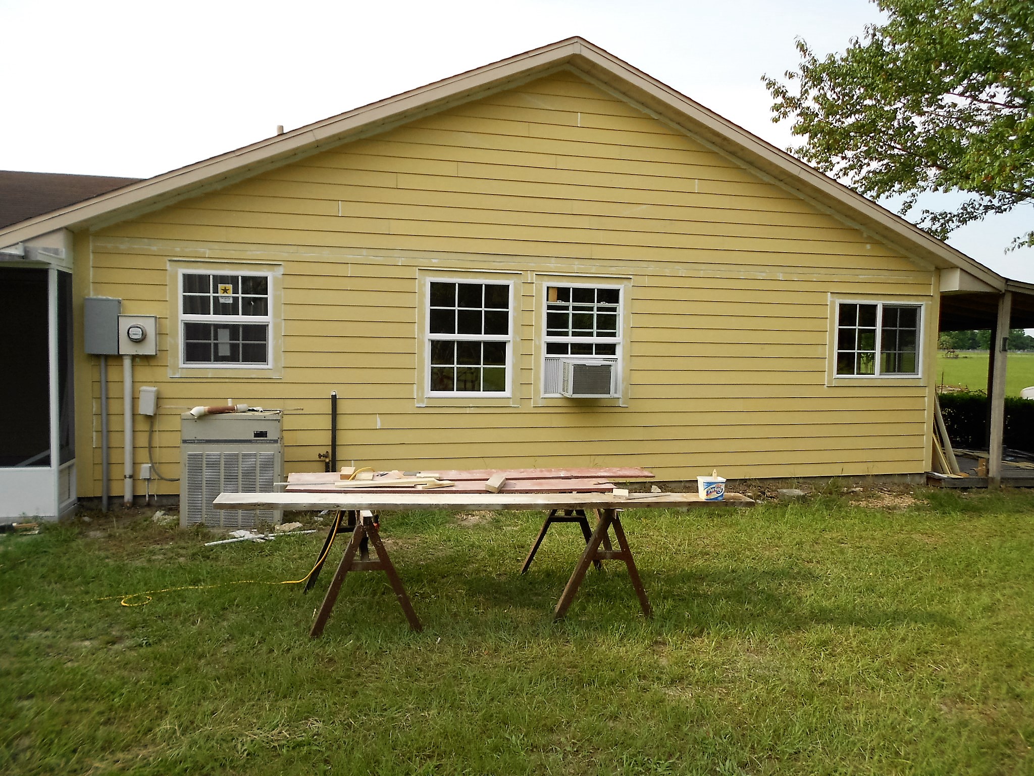

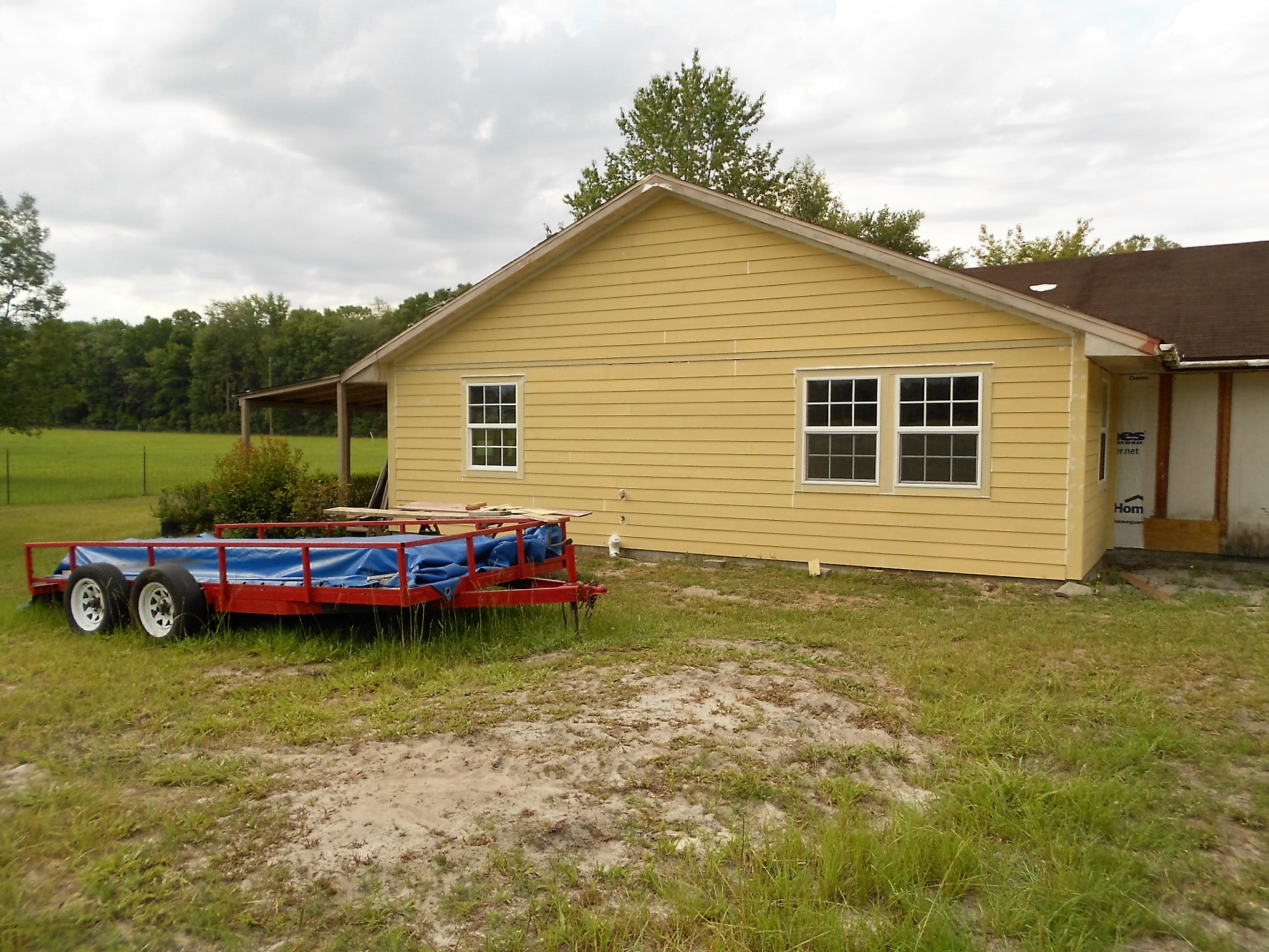

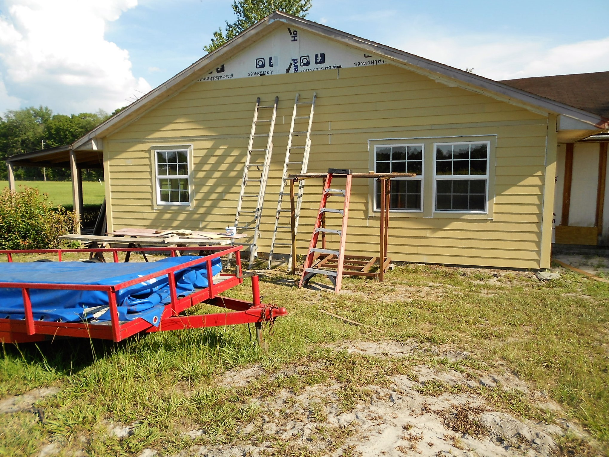

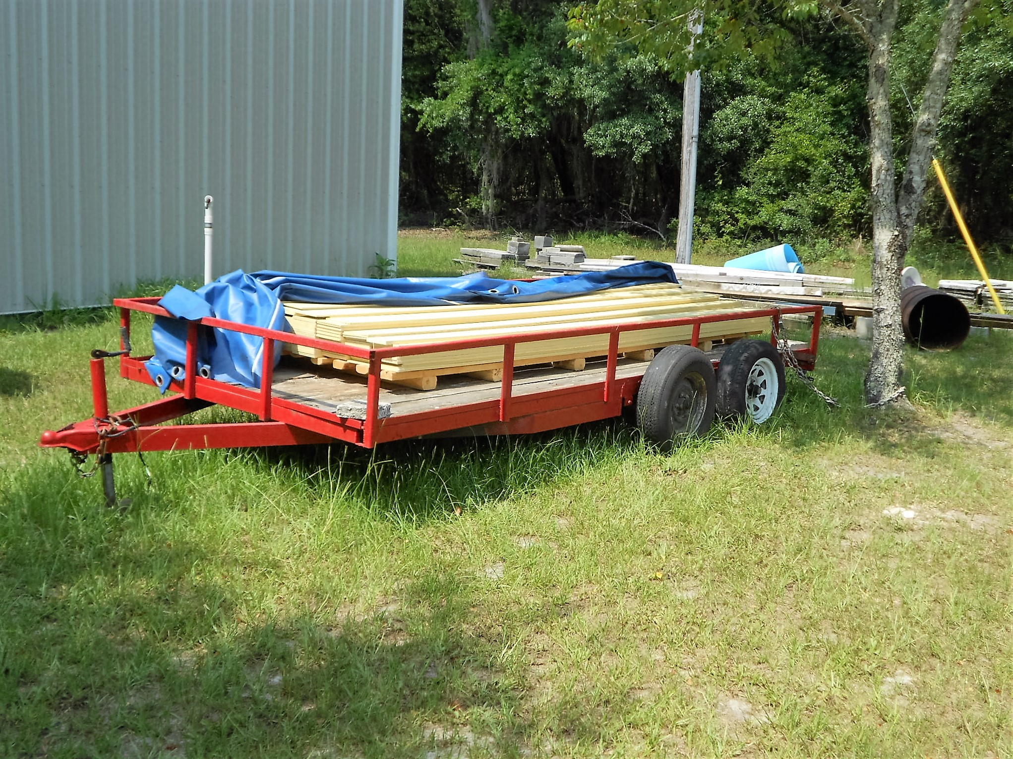

Up dating this thread and my progress with the Hardie siding.
I have been replacing old windows and installing Hardie Plank Siding on my 4 bedroom ranch house.
Pics are before, during and after doing a complete side of the house.
I have been cutting with a 4 1/2 grinder and found that a diamond blade with notches in it cuts best and I am still on my first blade!
I am also using an old table saw with notched blade to rip lengths of the board.
I have had to use Hardiebacker square head screws to fasten because the house has metal studs and I am fastening the siding to T1-11.
The screws hold so good that they will pull all the way through the siding if I don't stop!
I bought a whole pallet of the siding and had it put on an old trailer that I have so I can move it around the house as I go.
Gonna be a long summer!

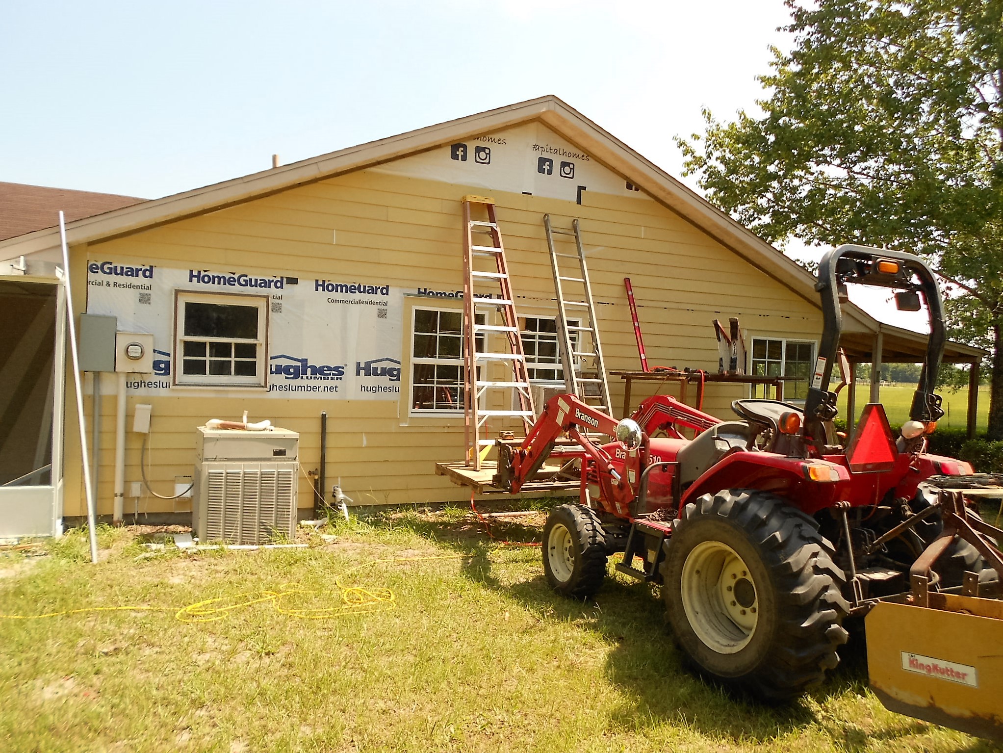

I finished most of the north wall last weekend, see before and after pics. Saturday it was 100* in the shade of the porch at 2 pm!!
I am about 2/3 done but making good time.
