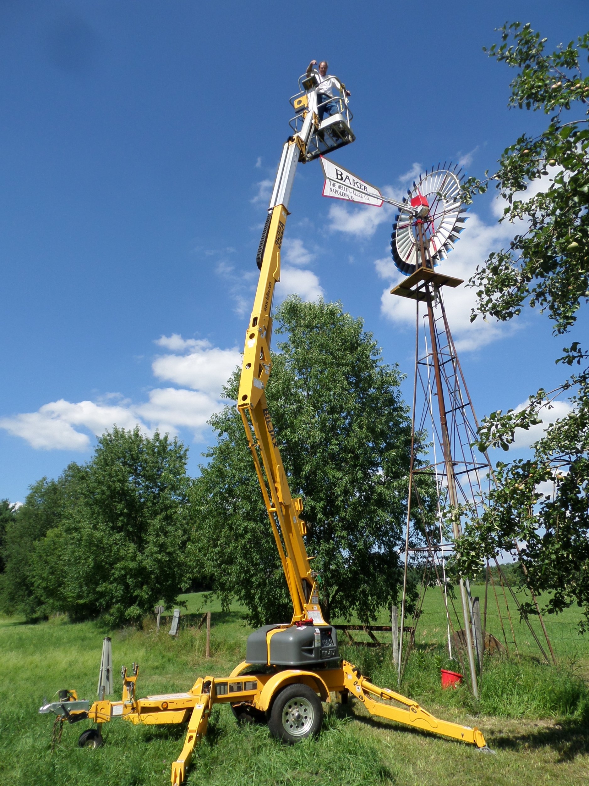

Why not just rent one of these ? I bought one to service my windmills, trees & gutters, but for just a short time, rent one and see if you really need that capability all the time. I can take the bucket off and put on a homemade jib crane arm, all controlled from the ground. View attachment 846205
I've thought about using a boom lift as a crane or telehandler. Every once in a while a used one shows up pretty cheap. However, they are often limited to 500 or 1000 lbs lifting. Probably OK for lifting wood, but it could be problematic for steel. It isn't clear how easy it is to move the controls from the bucket to the body, or perhaps many have dual controls already.
Someone mentioned removing the truss or load. One could design a method that attaches that can be released from the ground. For example using a rope that goes from the end of the boom, through the load, then back to a pulley, and back down to the ground. So, simply release the rope from the ground and pull it through.
