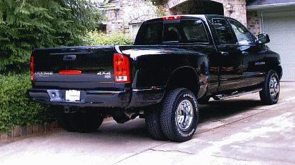

Here's my 03 2500 Dodge with the Cummins HO...Love this truck so far. I have better pics but this is the only one I could find at the moment.

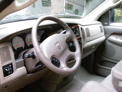

I like the cool looking guages in mine..... Stylin /forums/images/graemlins/grin.gif
Isn't the under seat storage areas nice? The one under my front center seat is a great use of space.

Thats too funny! I didn't even know there was storage under the center front seat. After I read your post I went out and checked mine and sure enough I had storage under my front seat. Now I like my truck even more!!! /forums/images/graemlins/grin.gif The Cummins engine helps too! /forums/images/graemlins/smile.gif
