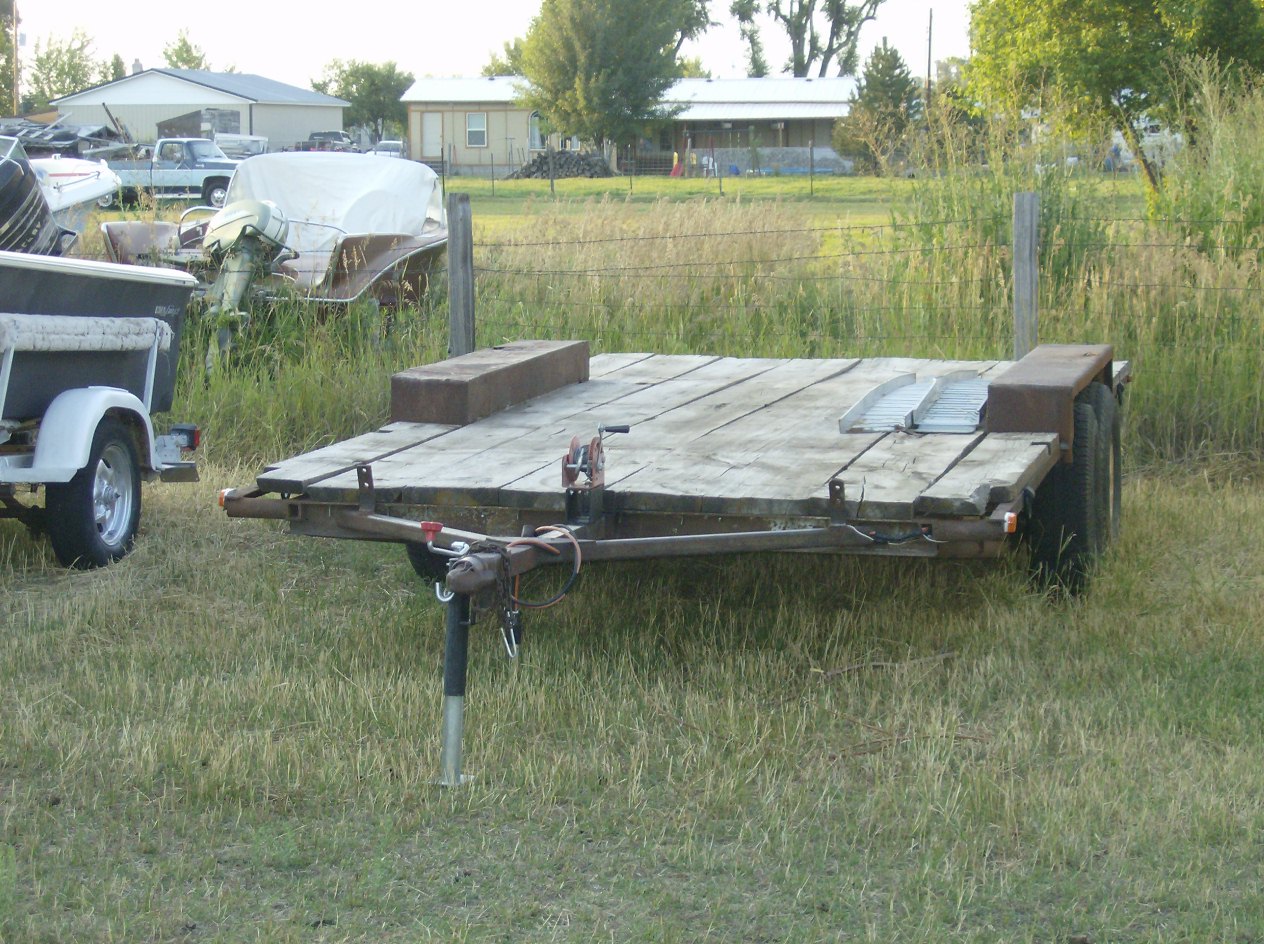

Here are some pics of the trailer. You can see that it's not something that has to be all perfect.

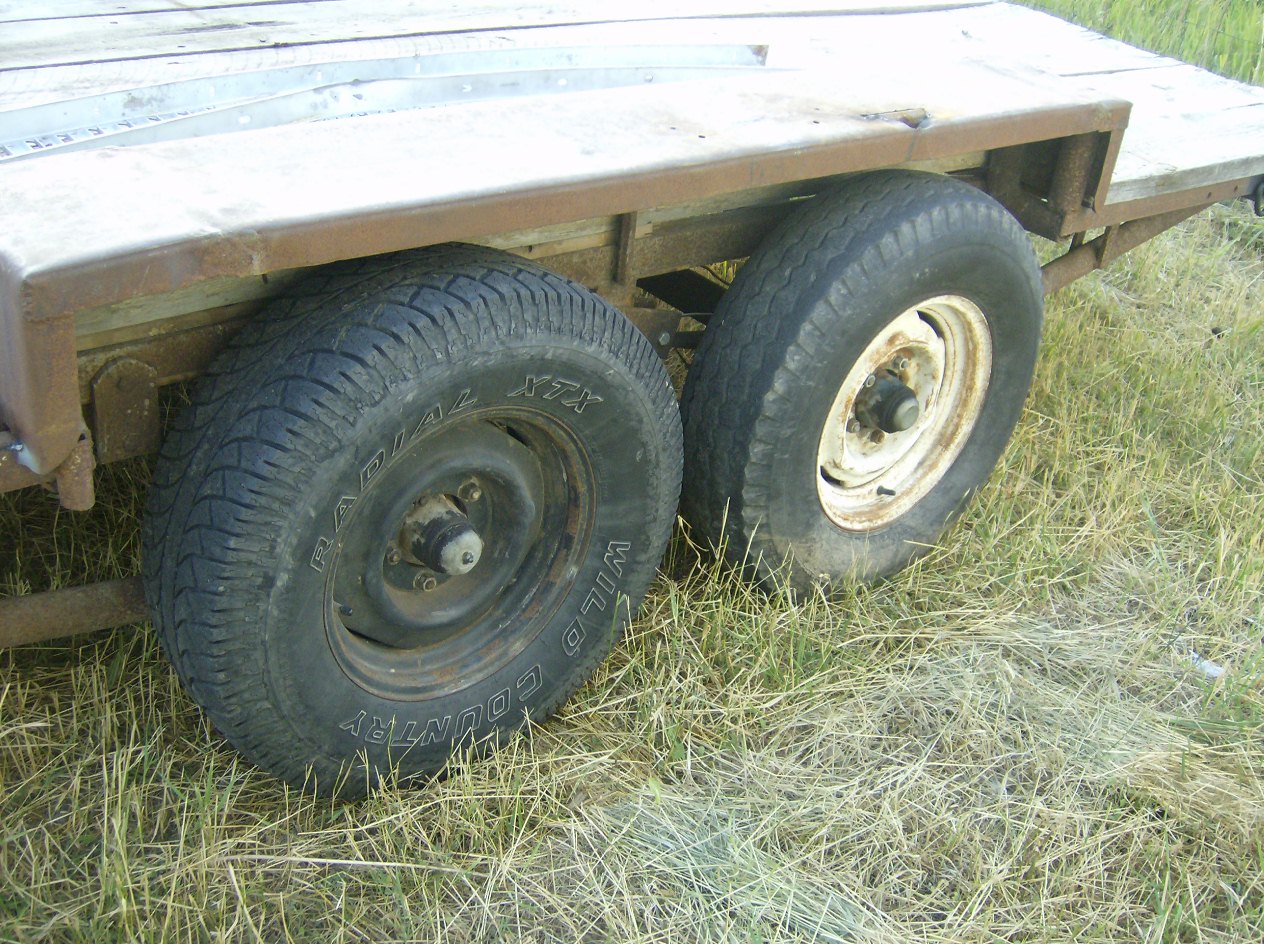

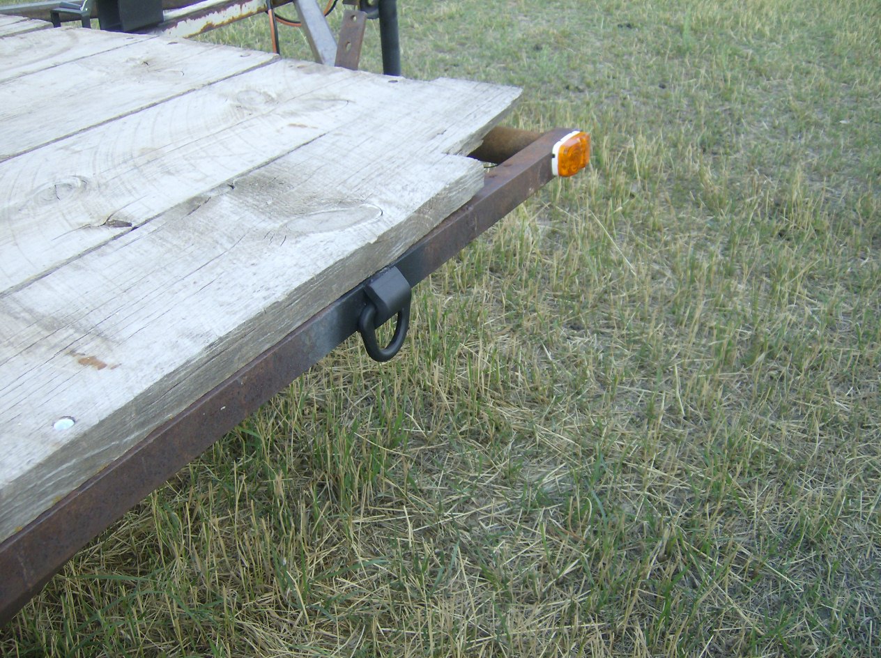

I've included a picture of the whole trailer and a picture of the mismatched wheels and tires. I also threw in a picture of one of the D-rings and one of the hand winch.

For that style trailer that you describe as a "beater" I would just put the used truck tires on and and get a spare or 2. would defintely try and get 10 ply or load range E or heavier though. If you were talking about a gooseneck or heavy equipment trailer to use a lot and heavily loaded I would hold out for the trailer tires. If you use your "beater" trailer like I do the tires will probably need replaced from rot before you wear them out. I like the way you have the trailer set up, I wouldn't paint the rims though, you might like the look so well you have to paint the whole thing;) and then you be afraid to use it.:p

I actually noticed tonight as I was checking the tire size that the current tires are "P" tires. So I have passenger car tires on it right now. E-load range truck tires will be a big improvement.
I don't use this trailer a ton, but I'm using it more than what I had before. Eventually I do plan to paint the whole thing and re-deck it, but it's going to all happen gradually. I also need to get a break-away battery installed somewhere too. I have already re-wired all of the lights, and I've replaced the jack. I also had to gather parts from all four wheels to get one axle's worth of brakes working. Including purchase price and all of the parts I've bought to fix it, I'm still under $300 for the whole thing.
I need to get a spare. Any suggestions on the best way to mount a spare on a flatbed like this?
