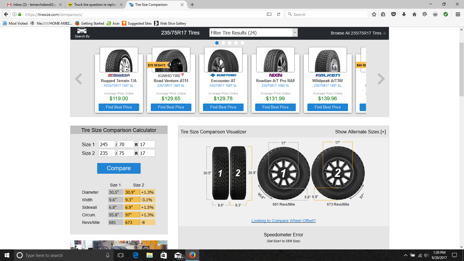

I have found this site to be very good with regards to researching tires,
Tire Size Comparison
As to all the comments, you can put quite the variety of tires on your stock rims 235, 245, 265 is starting to stretch it a bit.
I prefer a narrower tire myself, because of the places and conditions I drive in.
I also never rotate tires at a certain mileage, I run studded snows in the winter so I usually put the best looking tires on the front so
mine get rotated a couple of times a year, my Ram is good in that it recognizes which tire is where for the TPMS.
