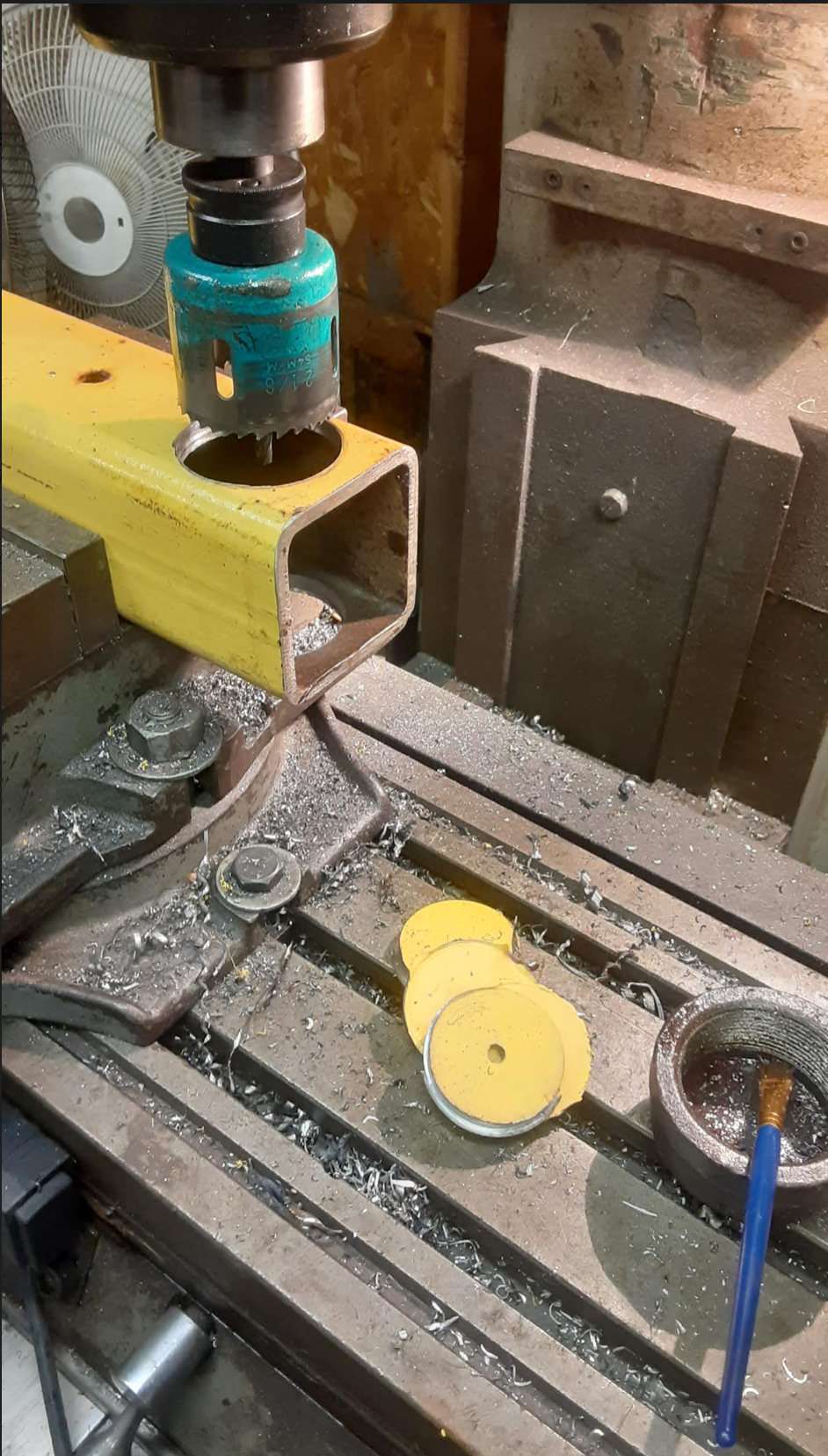

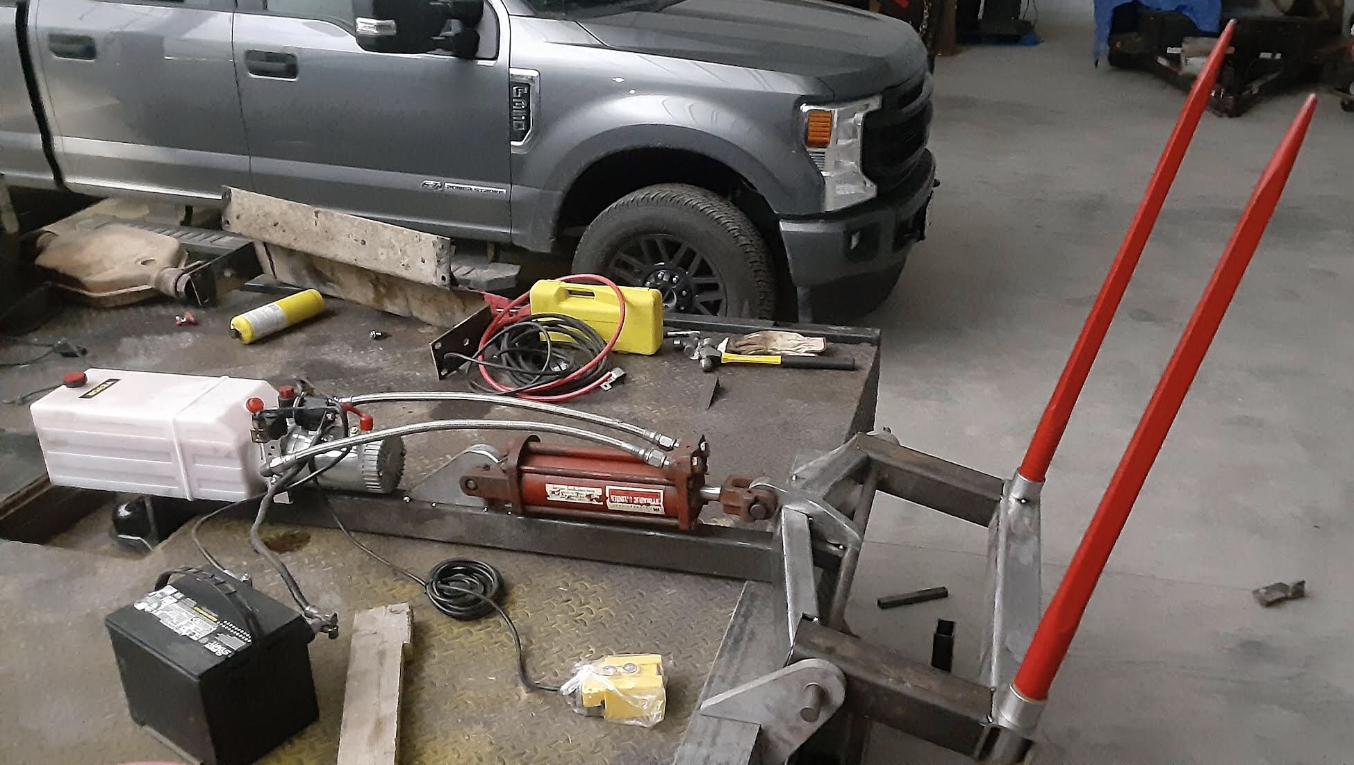

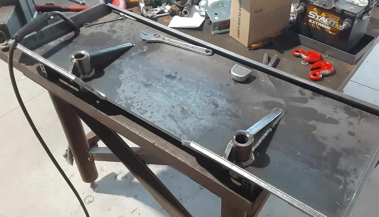

Found a 3x3x1/4 wall post that gave me minimal drop once I cut the base off of it and drilled a couple 2 1/8” holes for the spears to mount.
   / Truck mounted, quick detach, round bale mover. #13

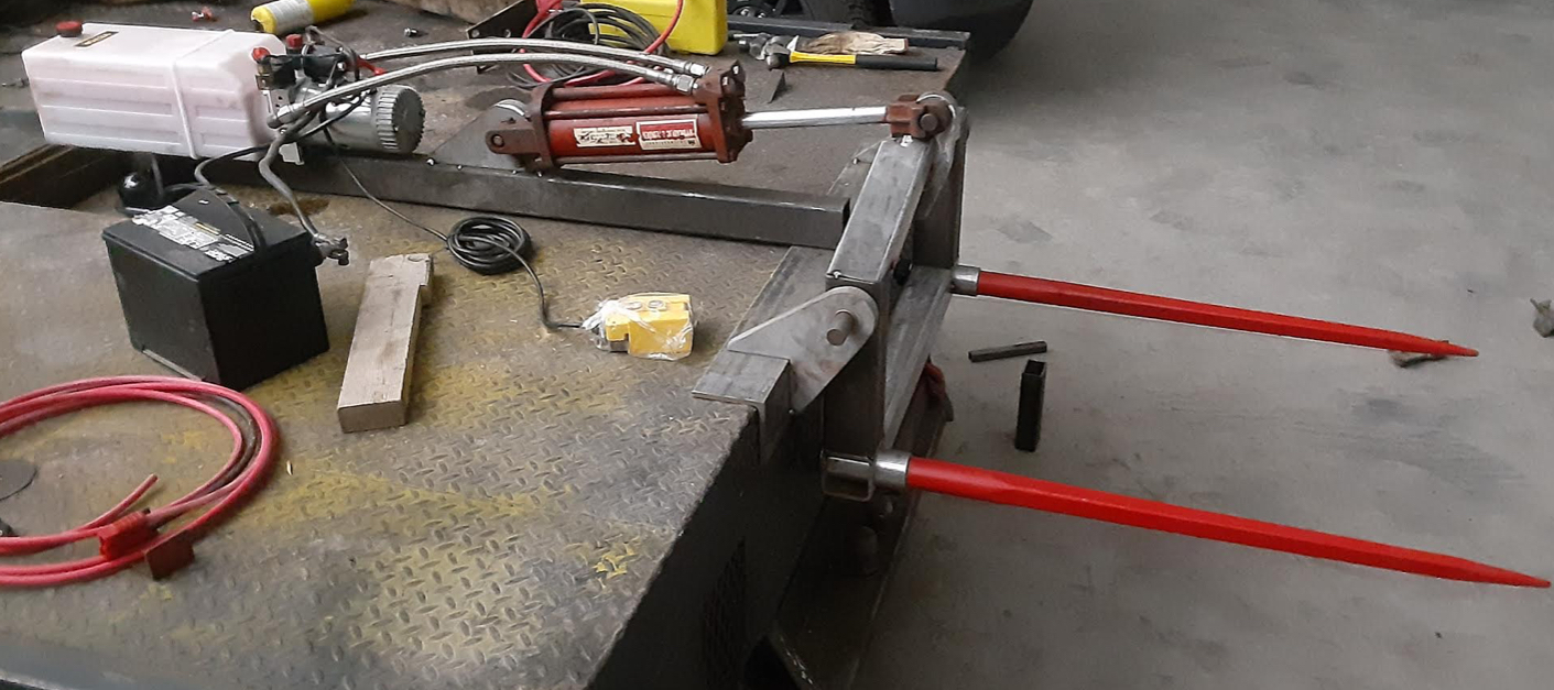

What brand spears are you using? I like a 30-36” spear for a 48” deep bale. Doesn’t get stuck .
#14

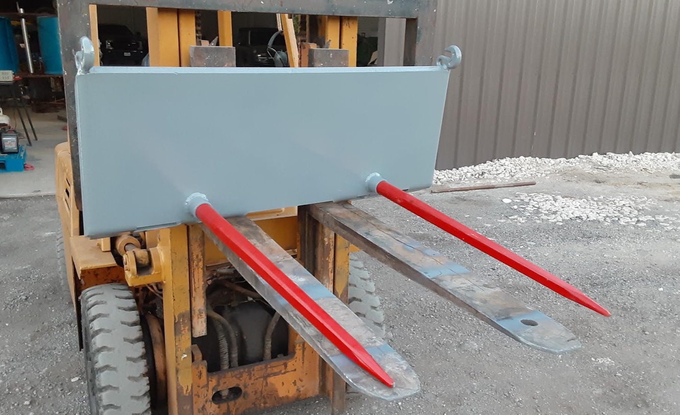

They came from a place I had never ordered from,
I bought my first pair to go with a QD 1/2” plate I found on Amazon. I thought the plate was a deal so I searched for A good deal on the spikes.
I order the second set after we beat on them a bit.
Found the link, looks like they are up $14.

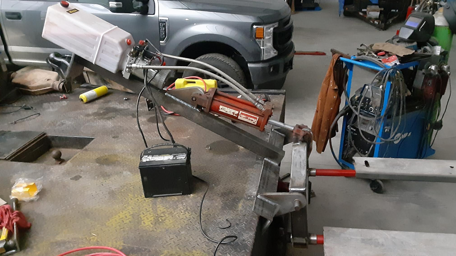

I welded it out enough I could see how it unloaded itself. I need to build a stand I can back into/drive away from it will stay, when not in use.
   / Truck mounted, quick detach, round bale mover. #19
How much weight does it need to be stabbed into to stay like that?
I really like it so far.
   / Truck mounted, quick detach, round bale mover. #20
You might get away with just "plugging it in" to a bale and be ready to go for the next feeding. Nice fab work. 👍
