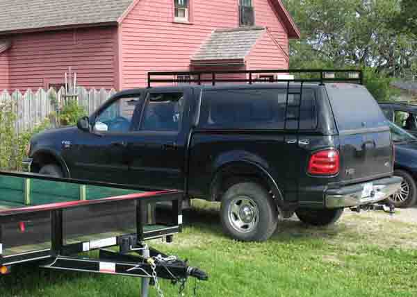

My plan is to make a roof rack for my supercab F150. It will bolt on cap and
will extend over cab. I plan on wiring two sets of work light forward and aft.
See attached pic for reference. My question is: Can I wire two sets of 55 watt lights - separate circuit - switch for each to this unit and how bright are 55 watt bulbs.

Well, I don't see the picture or a link to the picture....
Yes, you can do what you are asking about, as long as your electrical system can handle the load. Two 55 watt bulbs are going to pull approx. 10 amps. That's for each set. If you're only going to run one set at a time it doesn't matter how many sets you have. In fact, you could use a single-pole, double-throw, center-off switch. That would ensure that only one set at a time could be energized.
It might also be advisable to wire the switch to the lights through a relay. That way the switch has to handle a lot less current than if it were switching the full 10 A.
Depending on the material your shell is constructed of, you'll probably want to run a ground wire back to the truck frame, or even back to the battery. And be sure to fuse the power lead as close to the battery as possible. Don't ask how I learned to do that!:(
Oh, and about the brightness? Depends on the type of bulb. Is it regular old incandesent, or halogen or xenon? What kind of reflector and lens. The wider the beam the dimmer it will appear.

Thanks for the replies. Yes they will be work lights. I thinking now I don't need a set for the front - use truck high beam or fog lights.
Tried to attach photo of sketch - no go...will try again plus the finish unit.

It looks to me like you are planning on building your rack so it bolts to the cap and to the pickup cab? You don't want to do that, the bed and cab move separately, if you bolt to the cap and the cab, something's going to have to give, and I would guess it would be cracking the fiberglass.

I thought about that. The plan is to bolt to cap - four legs/feet above the vertical cap supports. The front two legs/feet will float/rest over the cab. All feet will have 1/4 to 3/8 foam between rack and cab/cap.
The rack will carry canoe and gear. Most of the gear will be placed on the cap area. We will probably carry a few bales of hay to the odd horse event.
I'm using used 1" square tub from another project. Most of it is welded already - just have to add sides and legs/feet. Even the legs/feet are drilled!
If it bangs too much I will make a smaller rack - lots of material - just for the cap. Once again - many thanks. This is what I like about TBN - great resource for info.

Yes, the cab & bed move independently of each other. Personally, I'd rather see the rack's front over the cab cantilevered WITHOUT feet to the cab roof. IMHO, it wont' matter how thick you make your pads, the feet will scuff the paint off & dent the roof.

Ok...starting to see the logic. Took some stuff to the dump today and kept an eye in the rear view mirror and was amazed how much flex there is. Welded the rack up today. Feet will go on next week. I will grind/cut front and angle down side bars and reweld. It will cantilever about 3'. Other than the canoe there wont be much placed forward off the cap. There will be cross pieces welded in place.
Hope this works...will post pics later.
