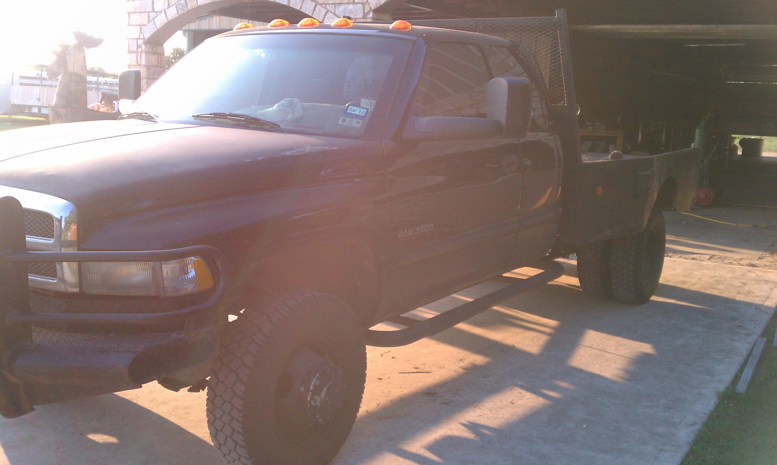

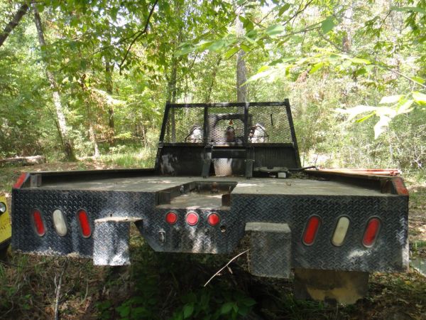

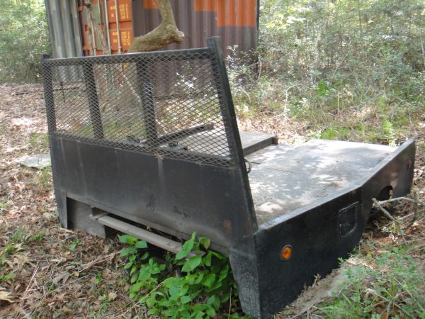

Been looking for a good used flatbed for one of my trucks, and stumbled across one last week that I thought would work for me.
The truck I want to put it on is the 1999 Dodge 3500 4x4 DRW. The bed was advertised on CL and the man had it installed on a 2005 Dodge DRW. I knew the rear skirt would need replacing, as the man had done some modifications that I did not care for. Other than that, the bed was in very good shape, with no rust.
Here is what I started with last week.

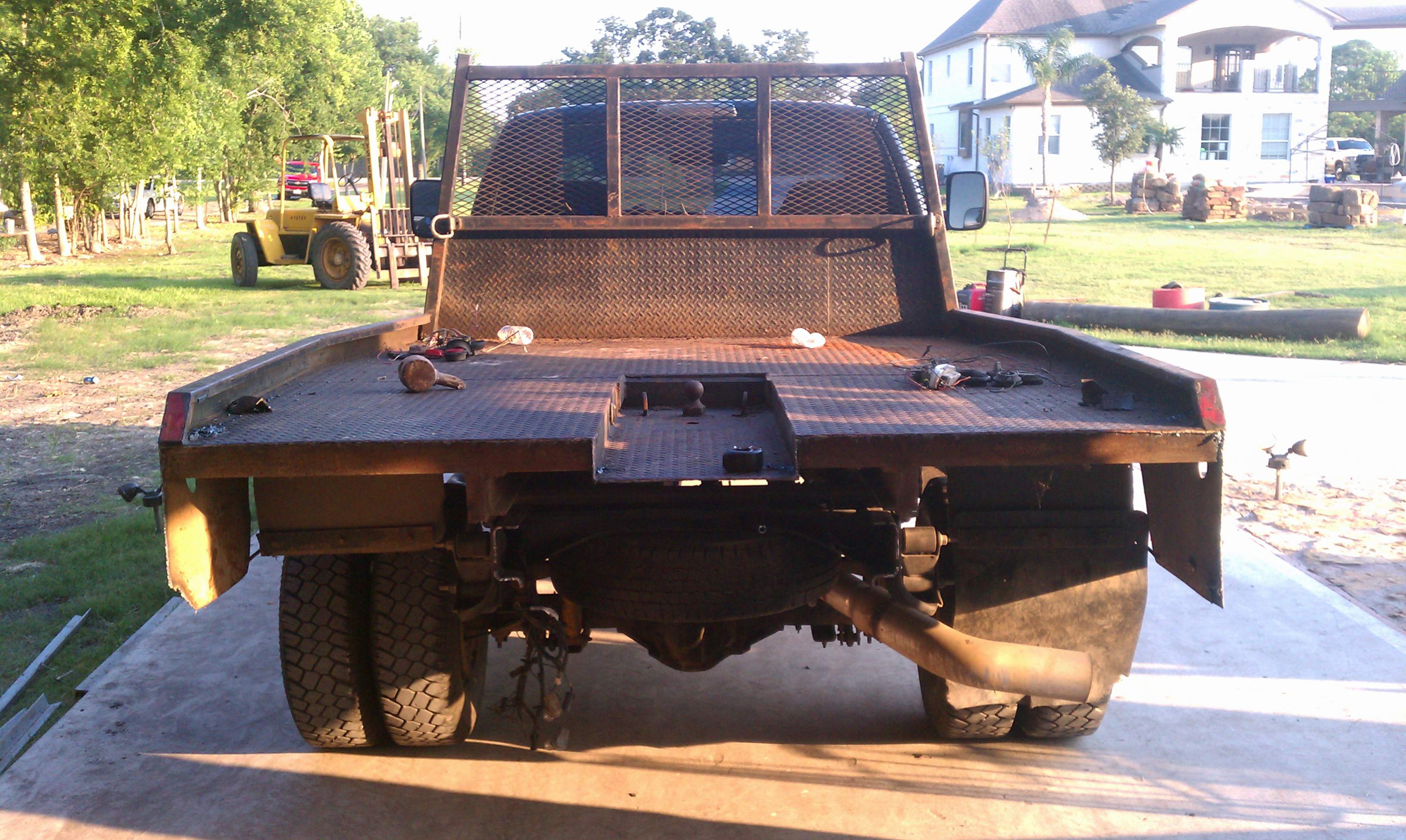

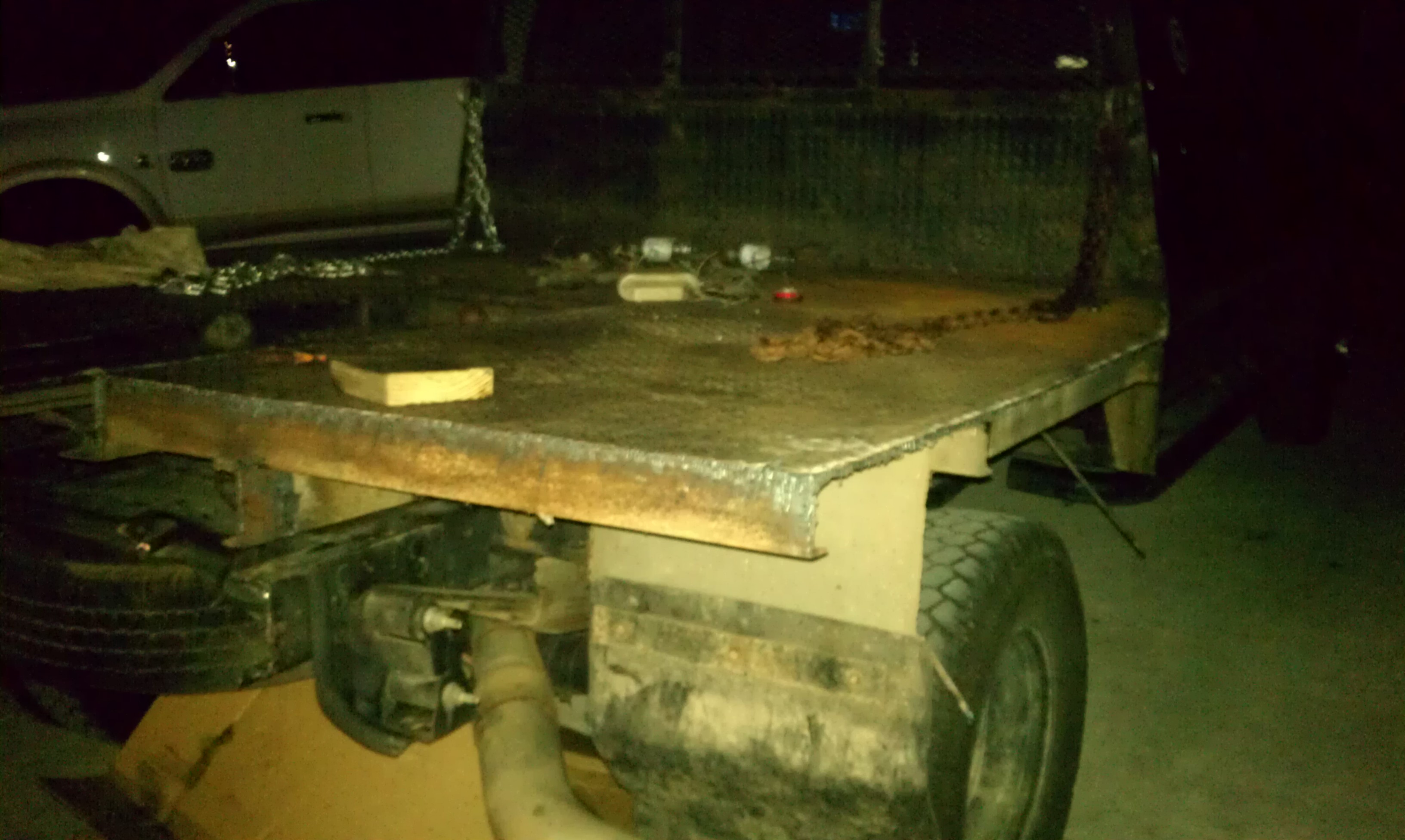

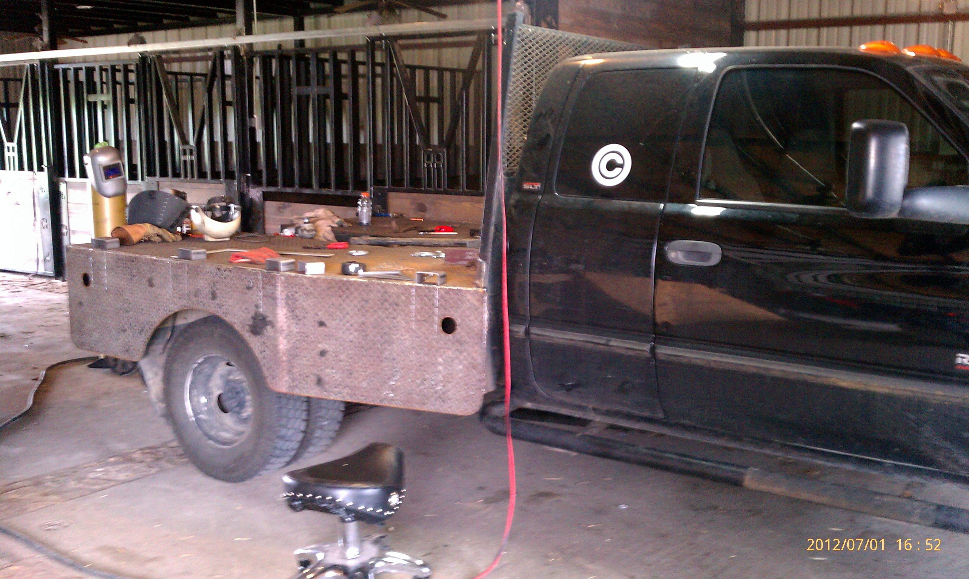

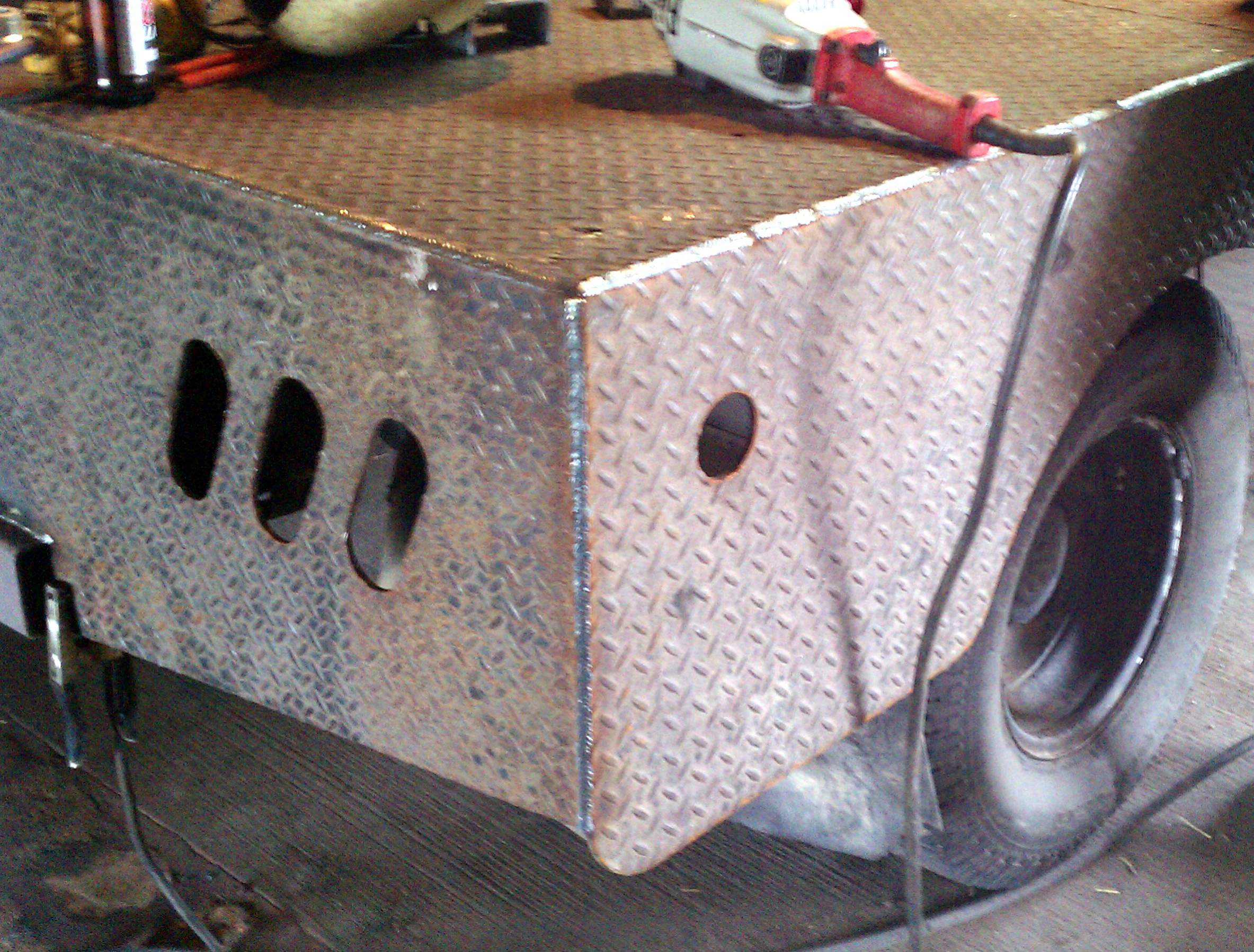

After an evening of cutting and grinding, I had the rear skirt removed from the flatbed, the factory bed and bumper removed from the truck, and placed the flatbed on the truck for a test fit.
After seeing the flatbed on the truck, I did not care for how the side skirts lined up with the body on this truck, so I decided to cut them off and start from scratch on the rear and side skirts, as well as install a new trough liner.

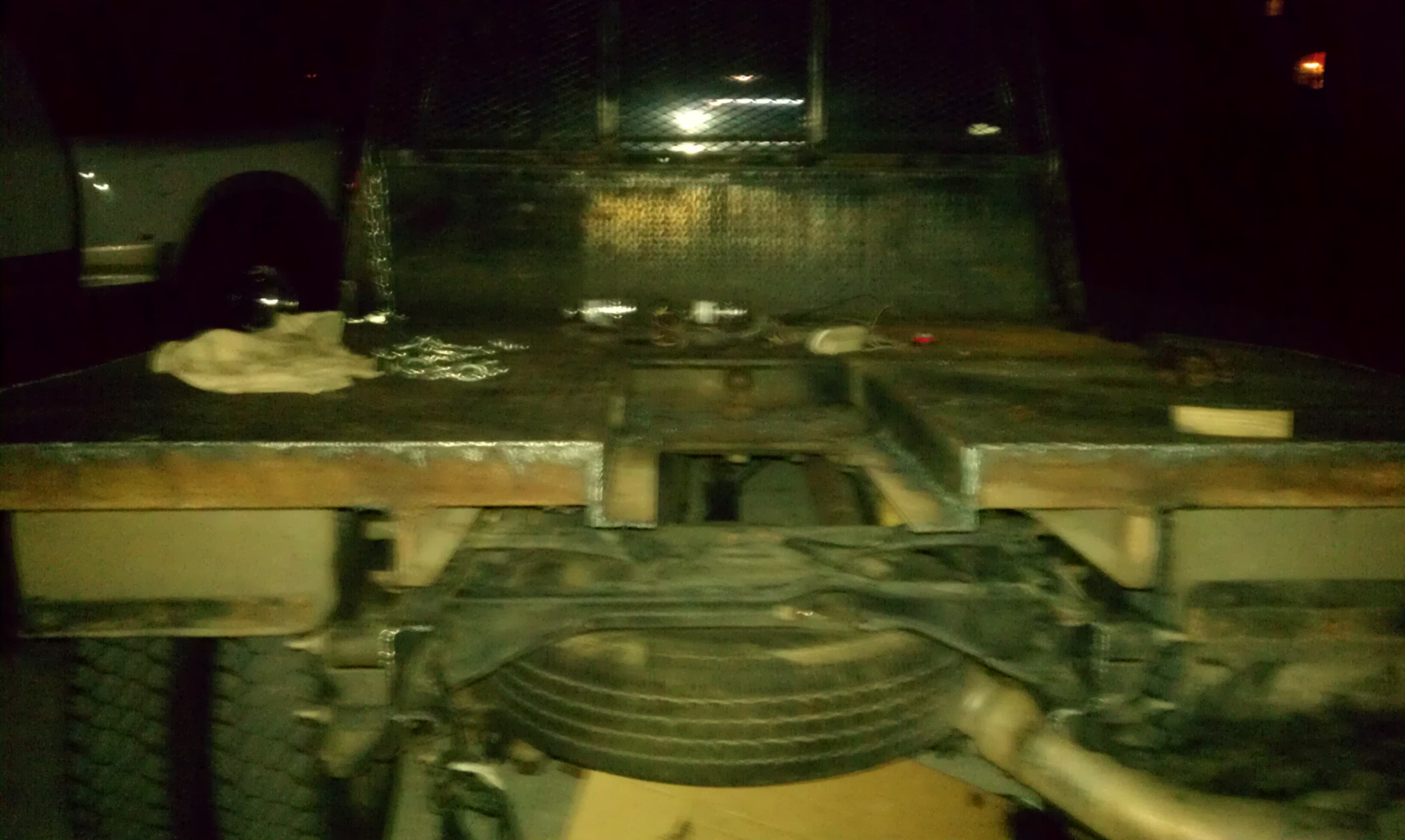

Here's the pics of the truck without skirting.

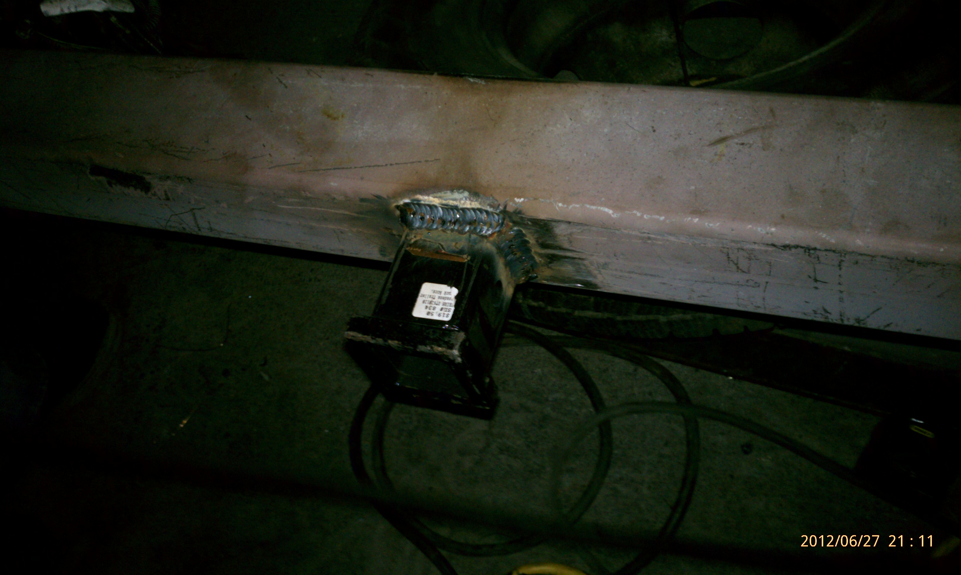

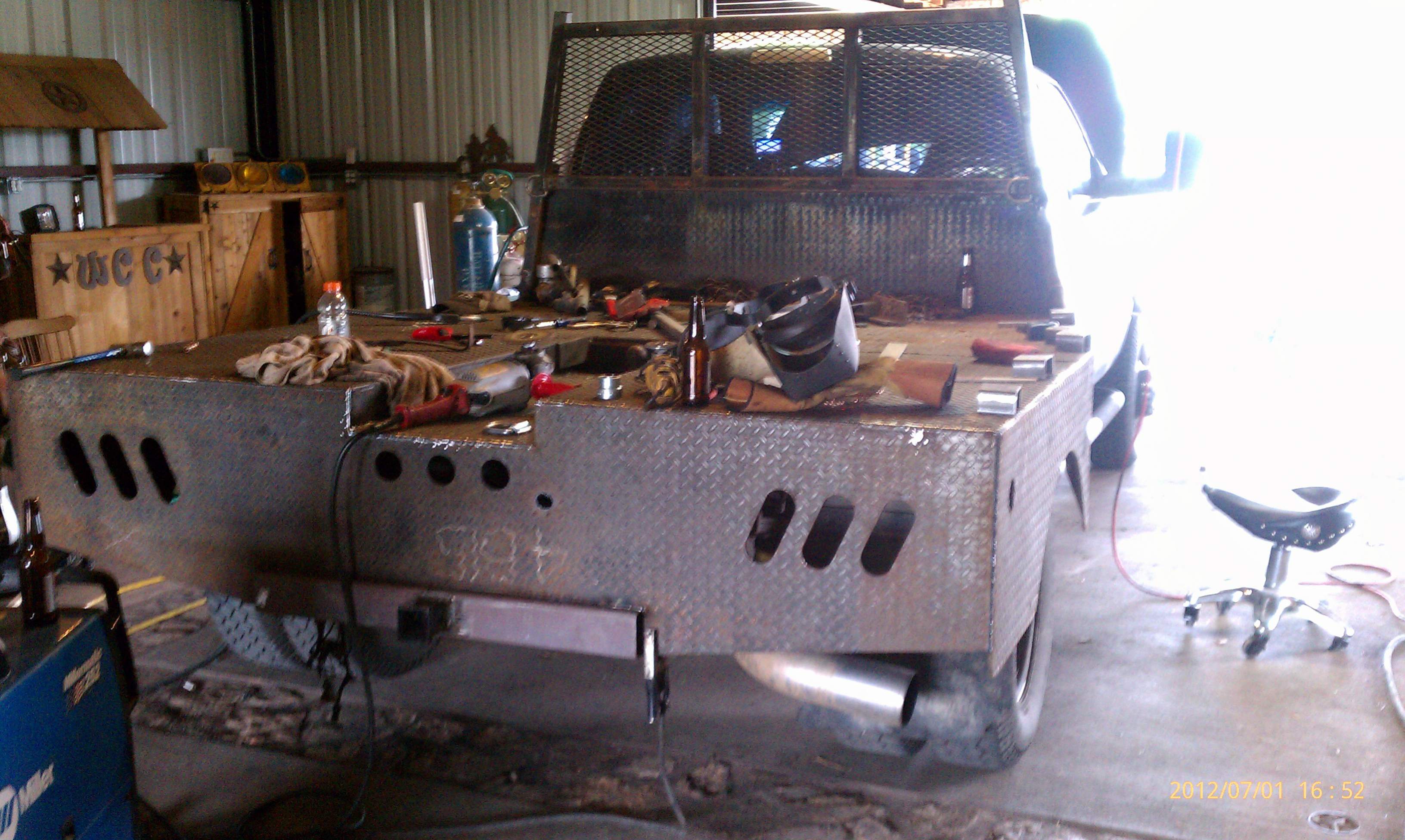

Another full evening with the grinder, and I was ready to start putting things back together. I built a new rear bumper/hitch out of 4x4 tube, and mounted a 2" receiver through the 4x4 tube. Then uses some 3x3x1/2 angle for my supports.

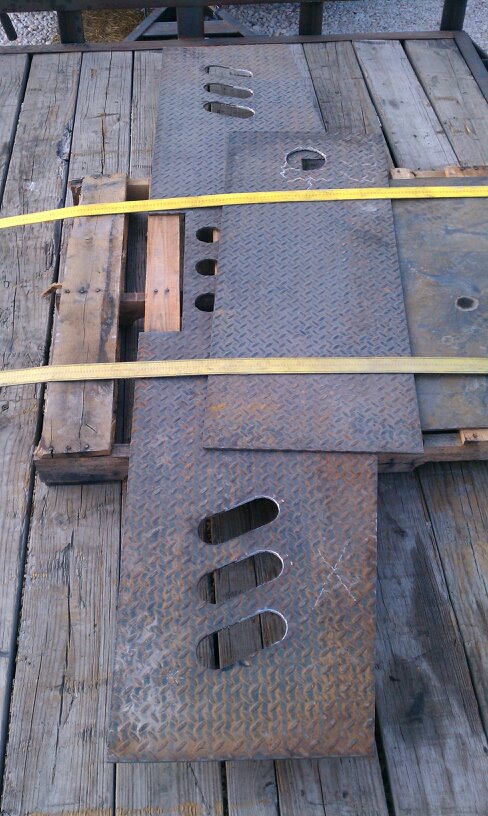

This pic is the rear skirt, and trough liner waiting to be installed. They were cut out on a CNC Plasma table. Once the rear skirt is installed, I will then take my measurements and have the side skirts cut out.
Here's a pic of the rear skirt sitting in place.

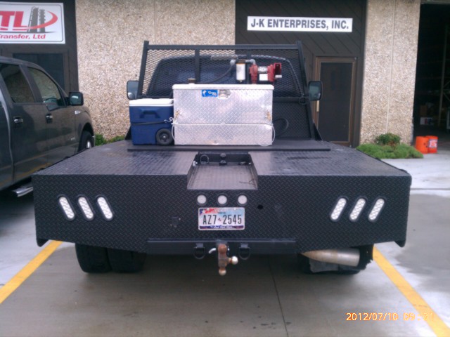

Made some more headway on the flatbed yesterday.
Rear skirt, and both side skirts are installed. I still need to weld on the safety chain tie downs, and the stake pockets and rub rail.
/ Truck Faltbed Project
#16

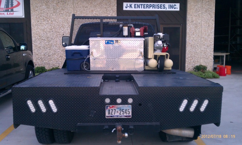

I appreciate all of the input on the paint. I ended up going the easy route, which I may regret down the road...
I shot it with 3 coats of Rustoleum gloss black oil based paint. Also managed to get the tail and marker lights installed. Still need to hang the mudflaps, install a license plate light, hook up the fuel filler hose, and install the aux. fuel tank/toolbox combo.
Rub rails installed, still needed to install the headache rack bracing in this pic

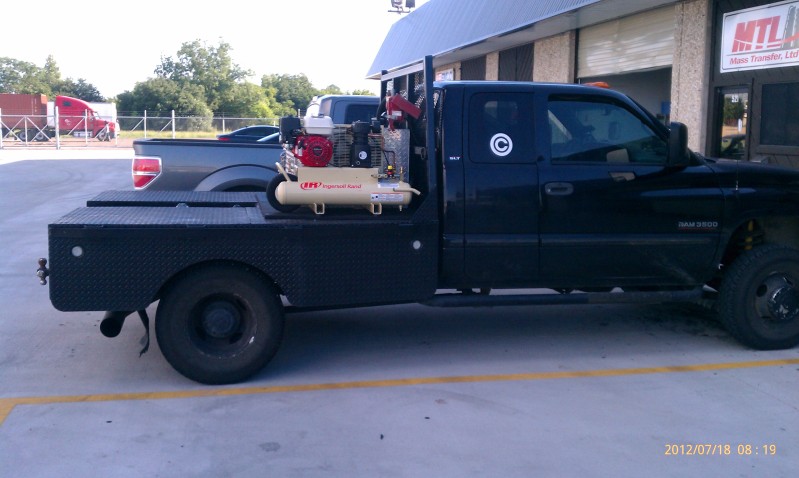

Thought I would post up an update on the flatbed project. I have now installed all the LED lights, including some green LED's in the gooseneck trough to give some soft light to see while hooking up a trailer in the dark. I've also installed the fuel tank / toolbox combo, the ice chest, some dog snaps with vinyl coated cable, and stainless steel fasteners.
When all of that was done, I saw an open spot on the bed, just to the right of the toolbox, that looked like the perfect place for an accessory I've been wanting, a gasoline air compressor.
So, I did some research and shopping, and placed the order last week. The compressor came in last night, and I broke out some more stainless bolts and mounted it to the bed.
