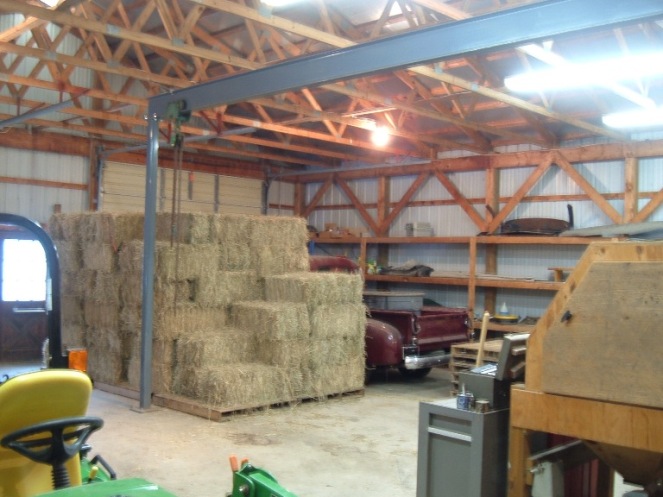

My new (to me) truck.
For canopy removal, my only options at the moment are calling in 3 friends or running down to 'canopy corral' and have them forklift it off and store it.
How are others removing their canopies ?

Well, my intentions wasn't to start a build thread but......
This is too bouncy as it is.

Couple of strategically placed hooks.
/ Truck canopy removal ?
#15
Load test.
8 bags @ 40# = 320#

Oh I see now you never wanted any help taking it off you just wanted an excuse to build something else for the tractor:D
