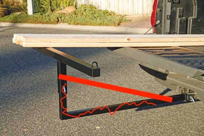

I was wanting to make a truck bed extender that goes in the hitch like this
But what are the actual legal requirements.
Like anytime you leave a lumber yard with PVC or boards longer than the truck, they get flagged.
So is there a law or something that specifies a given distance or something?
I never see bike racks or cooler carriers that go in the insert get red flags.
Anyone know?

   / Truck bed extender legality #7
If you make one like that, don't make it like that.
Make it like this to avoid scraping at every little dip or driveway.
Bruce
