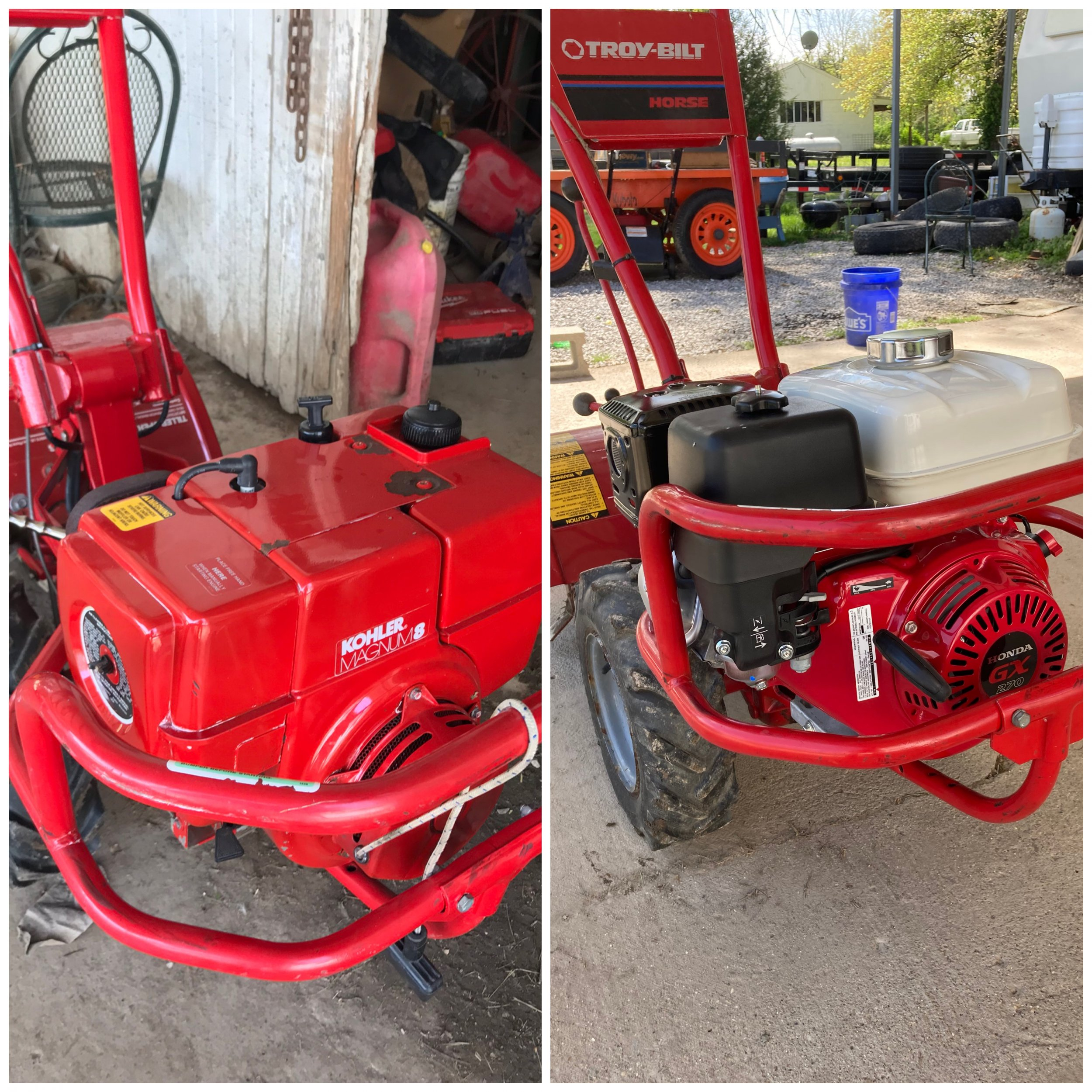

got 6 HH 60's here,----ALL with rods thru the block! Best cure for that is put a 7 hp Kohler on it and go!!
   / Troy built tiller with Tecumseh 6hp #19
Oh, by the way. A Kohler repair kit is a GX series Honda. My 29 year old Horse with the Kohler M8T had an issue with the ignition coil that caused kickback that ruined the recoil. No parts available for the M8T recoil. So I installed a GX270 and really love it
