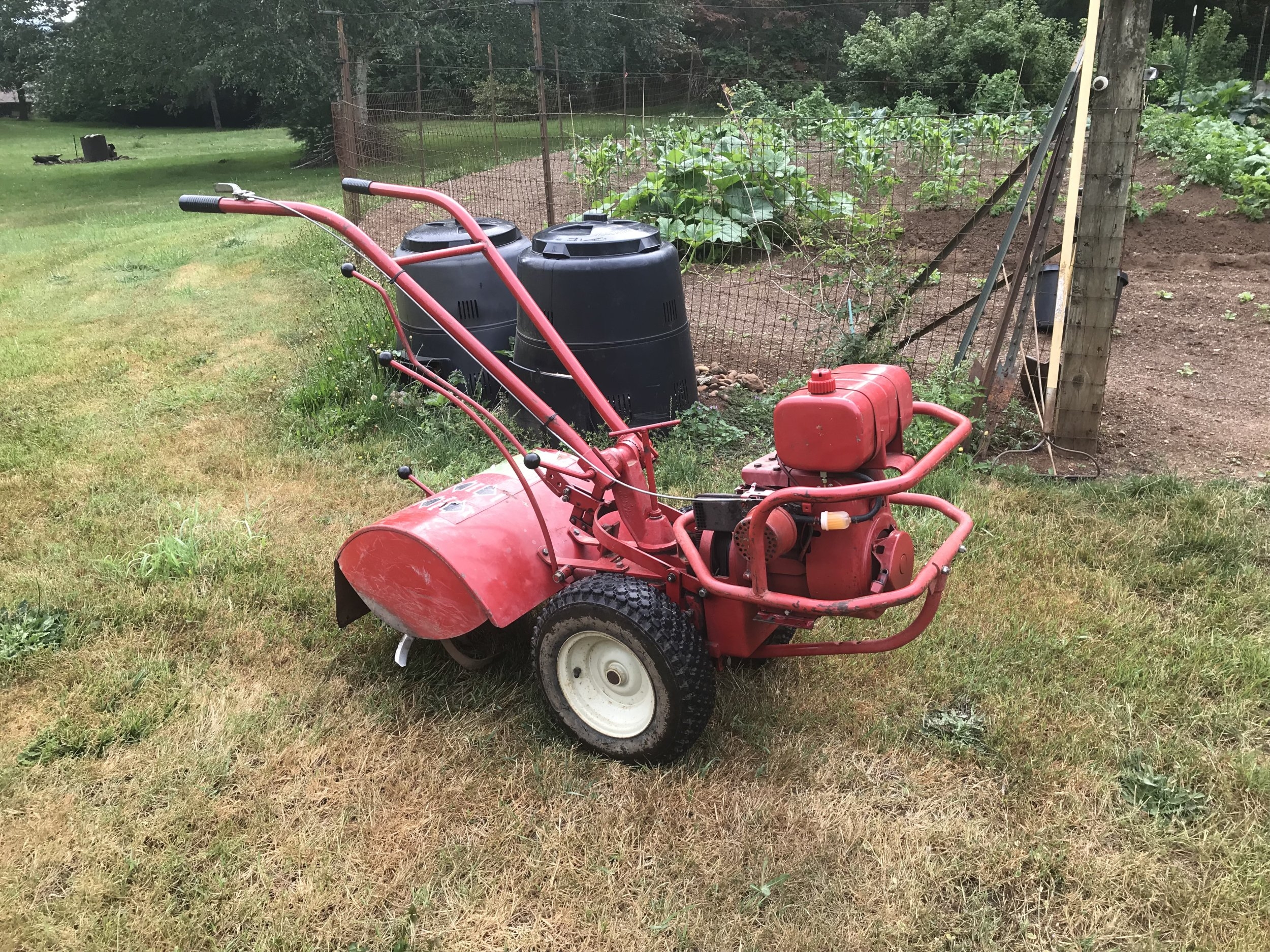

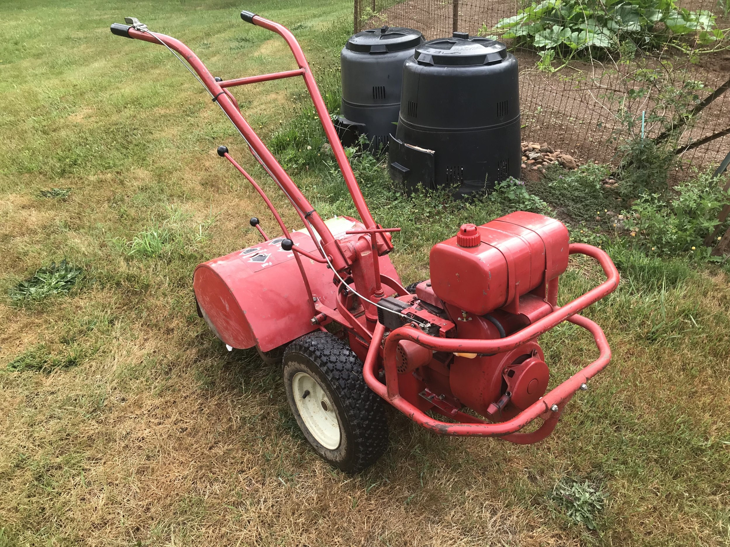

Have you inspected & cleaned the fuel system - if not I would do following:
Open up the carburetor and clean, replace fuel filter (if any?), remove fuel tank for cleaning up inside including any strainer or filter inside the tank at the fuel outlet.
Please note the added inline fuel filter & petcock in my old reliable 1976 Troy-Bilt Horse with original Tecumseh 6 hp engine.
I shut off the petcock after each use and run the engine at idle until it stalls.
IE. The carburetor has no more fuel.
Easy to restart every time, even if sitting unused for 6 months or longer. I always use Sta-Bil 360 Marine Ethanol fuel stabilizer.
