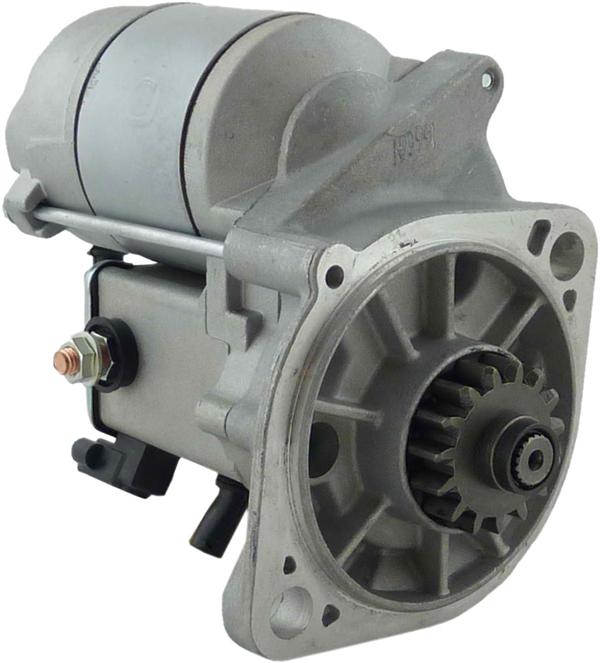

I have an issue with my John Deere 650 compact tractor. With a new battery, i'm having a weak start, the tractor will turn over once or twice per key turn but wont start. It turns over completely but doesn't appear to have enough amps or CCA's to get it to spin fast enough. The tractor is old and its wiring is a little worse for the wear and i believe the problem is in the wiring somewhere but just want some second opinions. I've done a couple tests that provide the following data:

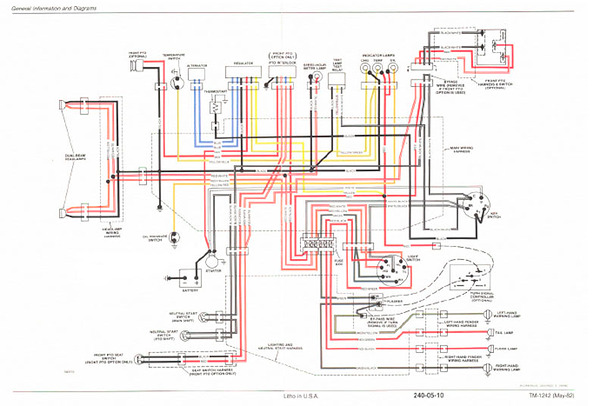

My primary questions are what would be the best methodical way to test the wiring to be sure of good connections? Also, the starter on the tractor doesn't have apparent solenoid + and -, i've attached a picture of a replacement part. If someone could tell me where to jump on it to bypass the ignition/solenoid that would be helpful? Finally, if someone has the service manual (#tm1242) and could copy a picture of the wiring diagram ill be your best friend. Ive attached the best grainy photo from the web i can find. I will get some pics of the tractor up asap to help with diagnostics. Just fyi, this wont be a drive by thread, i will be checking periodically.

George, thank you for the reply. The battery was purchased last week. I doubt the battery is defective because i had an older spare battery i also tried to start the tractor with that gave me a similar result before (stupid of me to buy the new battery i know). I may have to pull the starter like you suggest but the symptoms are more pointing towards an electrical issue as the starter will engage and turn the motor over, just not fast enough. I would also like to note that when i was trying to get it to start, with the weak turn over, the battery jumper cables became quite hot after a dozen or so attempts. Really wish i could get that wiring diagram, looks as though i may have to drop $120 to get a manual.

Yes I agree 100% with getting a service manual from JD.
I had a 650 for 28 years. My electrical problems always ended up being loose spade connectors in the wiring harness. Especially the safety start circuit. Years of vibration, I guess.
Anywho, the starter solenoid is on the bottom of your picture, motor on top.
