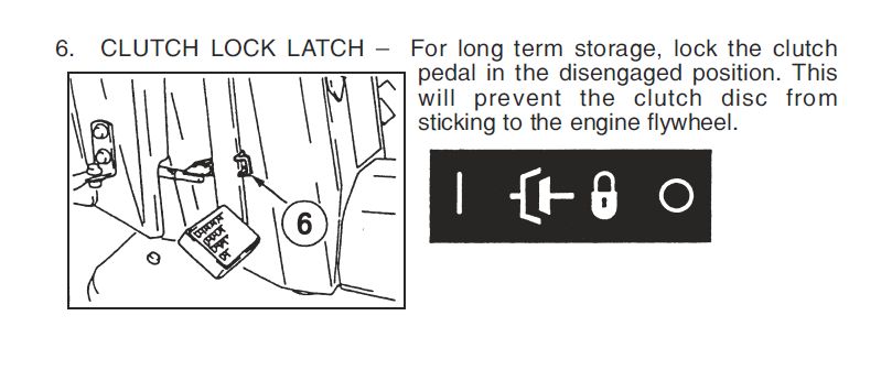

Does your tractor have a clutch latch like my 2216? Perhaps your clutch is stuck to the flywheel(?)
/ Trouble with my 3016, need help. #3
Yes, your clutch is rusted to the flywheel. When your tractor is not in use for a while, you should lock the clutch down to prevent this from happening. Try to run it arround for a while and get things warmed up and keep hitting the brakes to see if it will break free. If that doesn't work you will have to split the tractor.

I would move it around if I could get it in gear when it's running. The problem is that so far I can't. It will start easily but then I can't get it in gear. I can get it in gear when it is not running. Your suggestion that the clutch is stuck to the flywheel makes sense. It has only been sitting idle for about a month but I guess that is long enough. I'll keep you posted about the outcome. I'll call the dealer and see if he has any suggestions to free it up. Thanks gentlemen.

After the suggestions last night, I went out and locked the clutch pedal down and let it sit. This morning I went out and fired it up and everything is fine now. It must have broken loose just sitting there. Lesson learned. Now I set the pedal no matter how long it's going to be idle. Better safe than sorry. Tanks gentlemen. Again your advice solved a problem.
