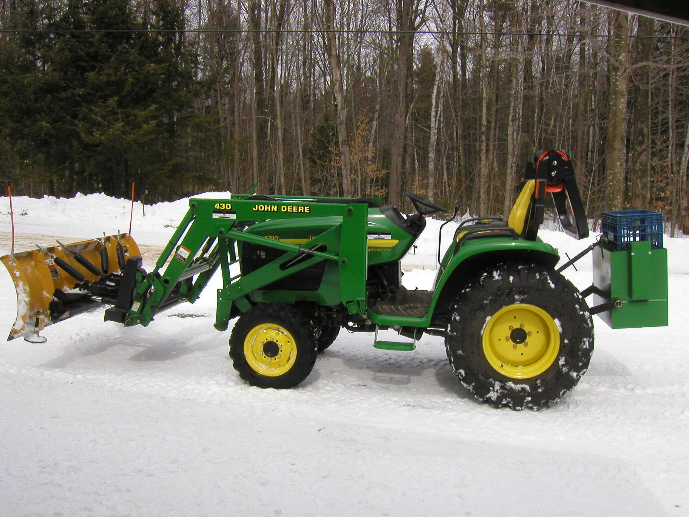

Solved this problem. My Curtis plow came with 4 springs. Way overkill for me.
I'd be plowing along and inevitably hit something and POW, it would practically throw me out of the seat!
Well, after I removed 2 of them it's better.
There is also a hydraulic relief device mounted on the plow. Does anyone know how it functions? Are they adjustable?

The relief valve is called a "crossover relief valve" or "cushion valve". It's purpose is to protect the blade and framework by allowing the blade to move if it hits a immovable object. Say the blade is angled full left-so the right side is furthermost forward...and you hit a curb with the right side-the relief will trip allowing the fluid to escape the right cylinder so the blade will straighten out.
They are usually adjustable-but I would not mess with it...
Clear as mud?
   / Trip springs on snow plow were too stiff #3
My 6 1/2' Curtis came with only 2 springs. Trip works very well for my size tractor.
The hydraulic relief valve also works very well. But has no adjustment.

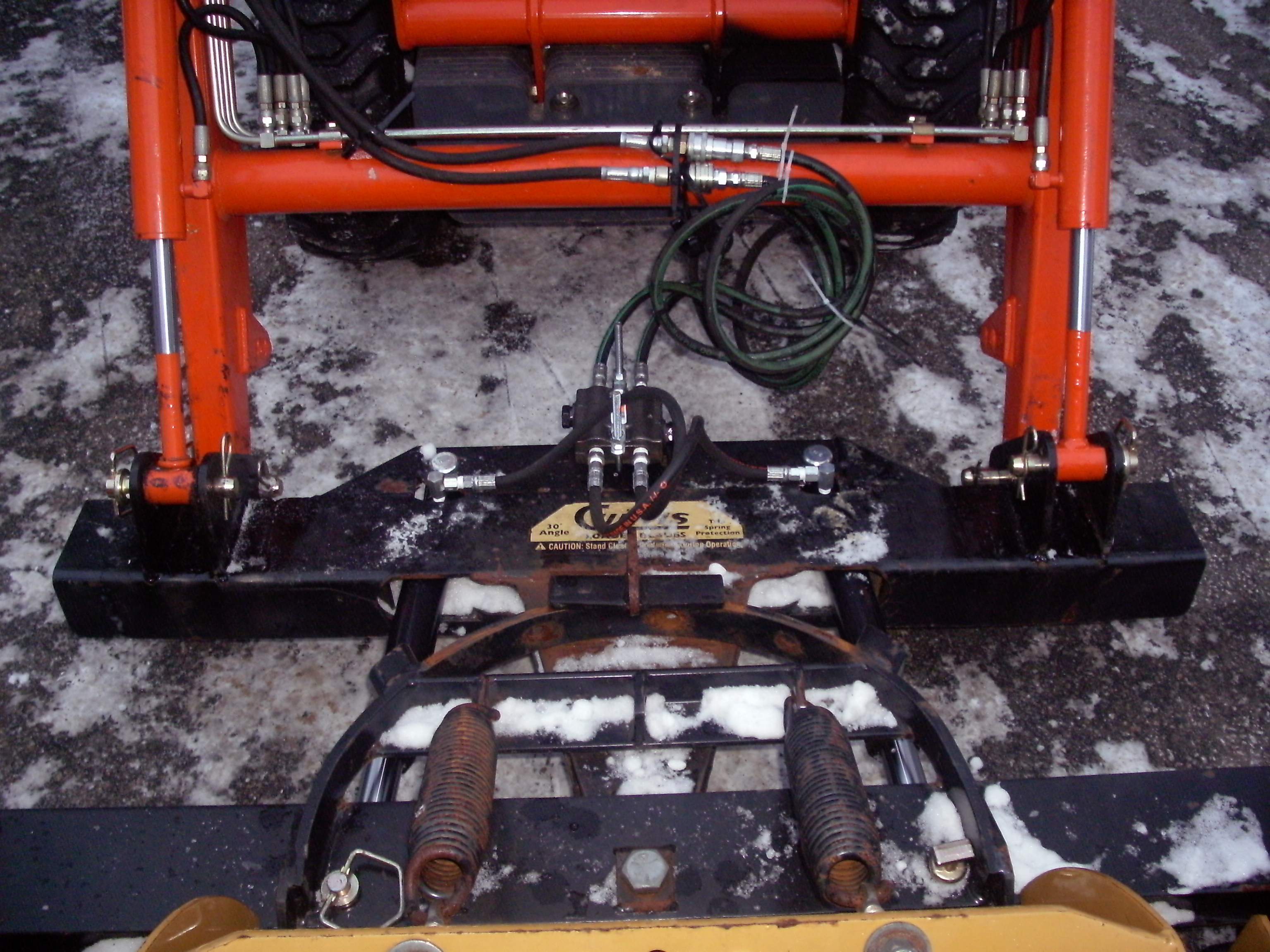

I picked up the Curtis 6 1/2 plow this year, and it was manual. Curtis wanted $700.00 for the kit to convert it to power angle. I picked up 2 cylinders, hoses, and a cushion valve for under $300. Took me 10 minutes to install. The cushion valve has a preset PSI. Generally around 2500 to 3000. The place I bought the valve asked if I wanted to beef it up to 3000, but I wanted the lower PSI to protect the tractor. I have had the trip springs work a couple of times, but I have not hit anything to trigger the valve yet. Here is a pic of the hookup.

NHbot- Yours looks very similar to mine including the position of the relief valve. Yours looks permanently mounted. No quick connect?
