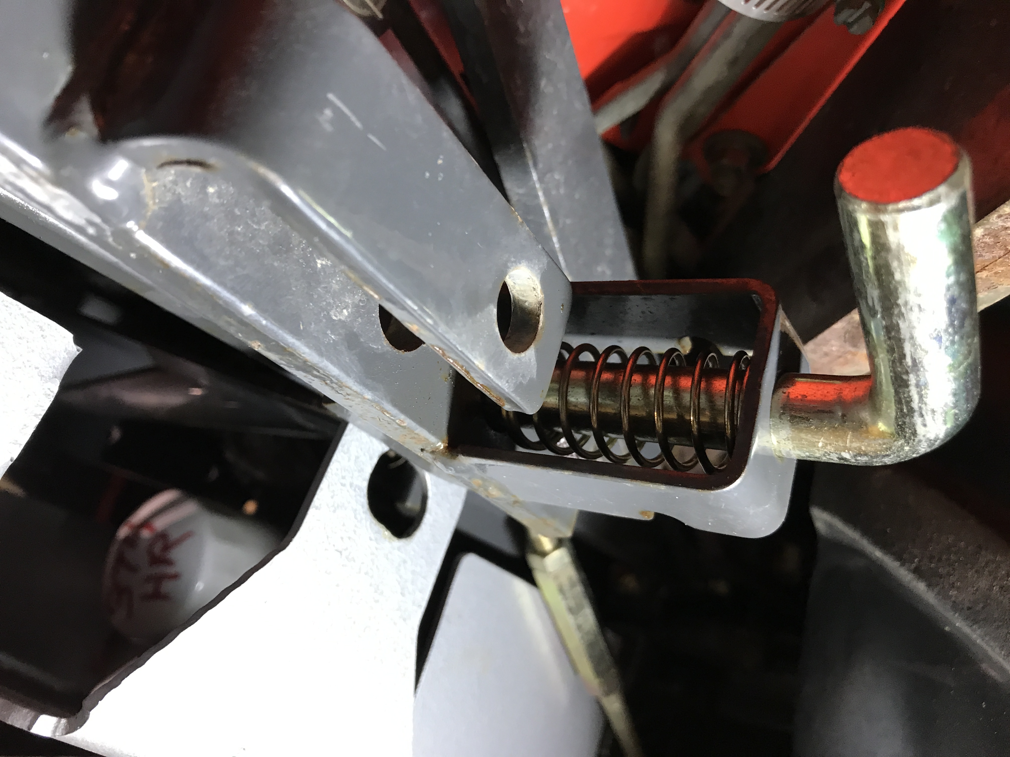

BXpanded 'under armor' photo
my first attempt a uploading...you should be able get an idea of the mismatch

It's been about 5 years since I put mine on, but I think I had to install it with the deck lift arms lowered, then raise it and keep it up. I don't have a mid-mount mower, so it was a one-time installation.

I know you said your invoice shows the correct model, however that doesn't necessarily mean you actually have the correct part.
I would recommend you contact BXpanded & check measurements against what you have as to what the model KBXUA3 should be.
My under armor is for a BX24 & fits perfectly & takes only a few minutes to install or remove.
