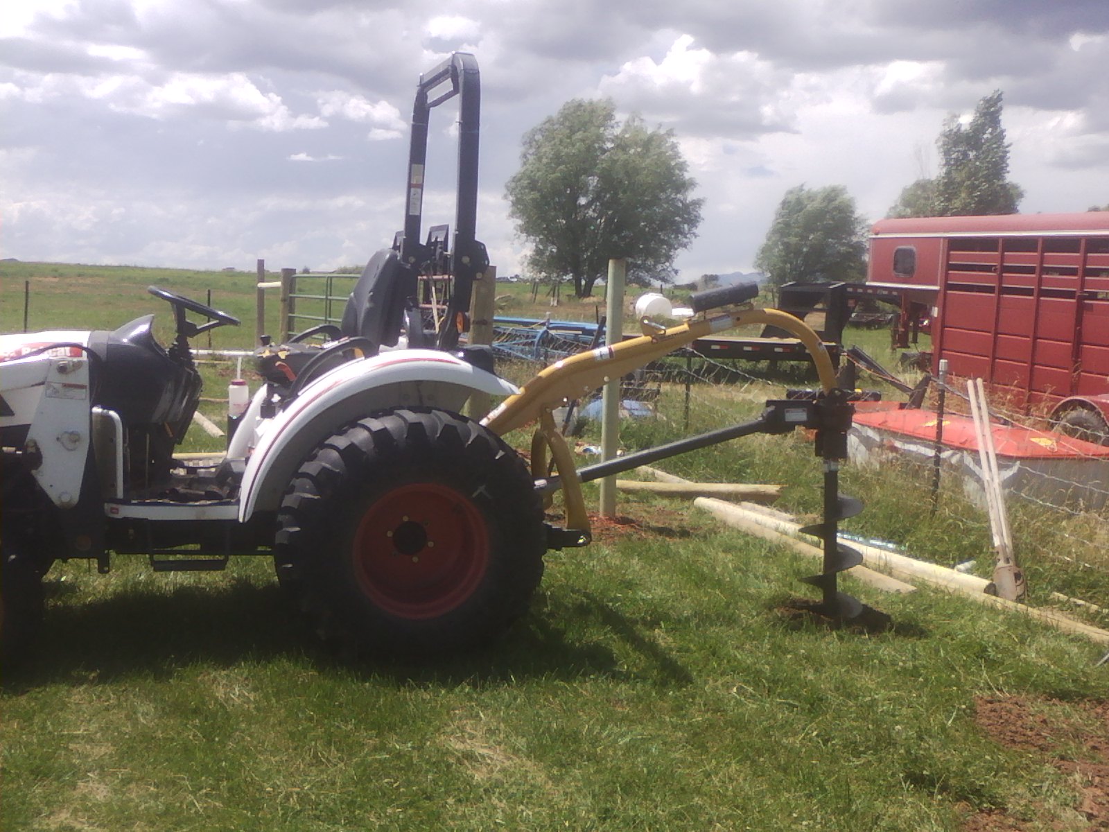

I finally put my TSC 3pt post hole digger I got last year on sale (it was on sale and I had a 25% off coupon) to work today. Its made by SpeeCo. I have it set up with a 12 inch auger. TSC told me it would work my tractor - boy were they wrong. I am in heavy damp clay with cobble and I am able to dig at idel.
First trick was the set up to get good lift and depth. Ended up in the first hole on the boom after experimenting. I need to modify my stand for easier hook up
Second tip was to let the 3pt down slowly, a step at a time and just let it work. When the auger was full of fines, quickly pick it up and spin the material off slowly. I had to be careful on how much I let down as it would quickly dig and start to bog.
I have learned to go slow and just let it do the work. I can get a 36" deep hole in a couple of minutes and have very little clean up on the bottom of the hole.

Did manage to break my first shear pin when I found my 2" plastic irrigation line. :ashamed: But I needed to move it anyway - just did not need the down time. At least it was easy to replace.
Some pictures of my set up.
