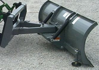

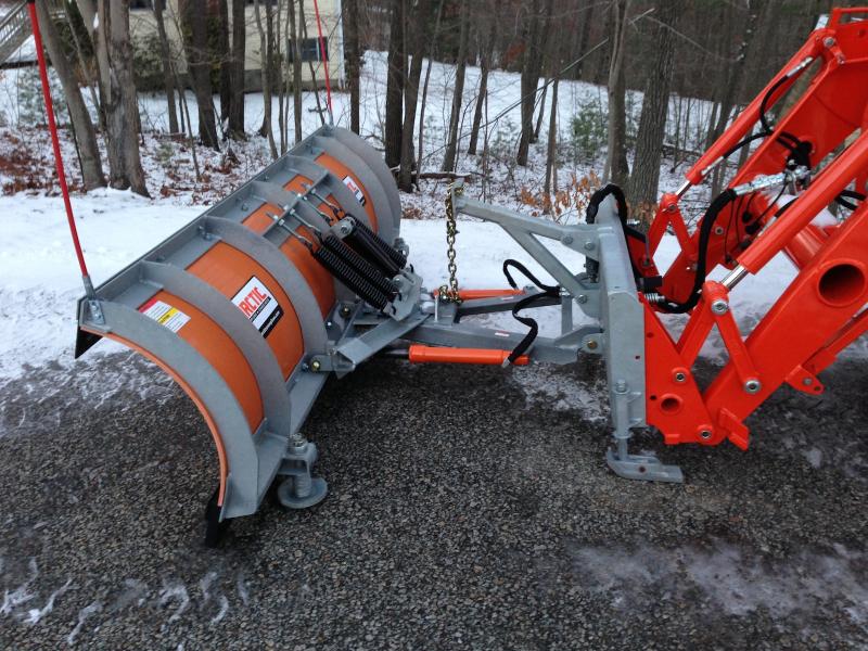

I've been wondering about the different ways to do the float for the plows and the affects they have on the tractor. I noticed when using a fixed plow on the front of a loader with it in float, it will causes front of the tractor to lift, then you cant turn. I attribute this with the loaders pivot point being up high and in the center of the tractor. Do the plows that have built in float suffer from the same issue? In my research I have seen some of the SSQA plows have the float pivot point even further back then the SSQA plate.
Pivot further back
Pivot at SSQA plate
Fixed to SSQA plate - Loader float
   / Trick to plowing snow with FEL ?? #16
I built a "fixed to SSQA plate" plow. I don't like it. I'm cleaning uneven gravel roads and lots. Had to make VERY large shoes before it would work on float. Too much weight having to lift the FEL frame with the plow.
I added 3pt brackets so I can use it on the rear of my Ford. It floats much better there but is a pain to push going backwards.
If building again I'd put the pivot at the SSQA plate and lift with a chain. Then the weight on the plow is minimized. Also minimizing the pitch change as the plow floats along.

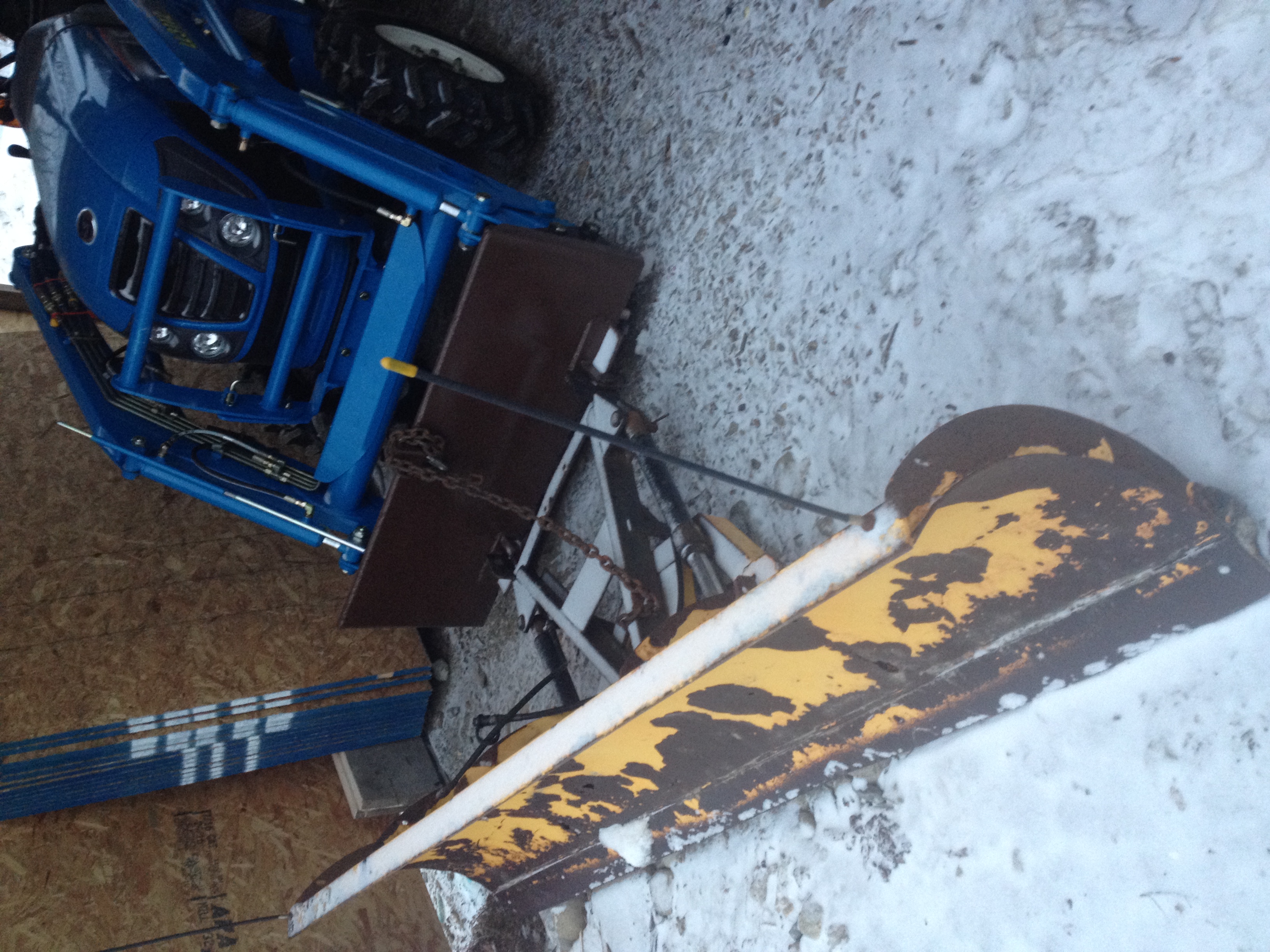

Pivot further back
Pivot at SSQA plate
As far as mounting a blade to the front end loader these 3 pictures just about cover it, and in my opinion the order of the pics is the order of desirability close couple and able to freely float.
The 3rd picture is how my blade is configured and by carrying the loader there is enough pin slop to have limited blade float.
The second pic has nice shoes which would help to protect the loader arms.
