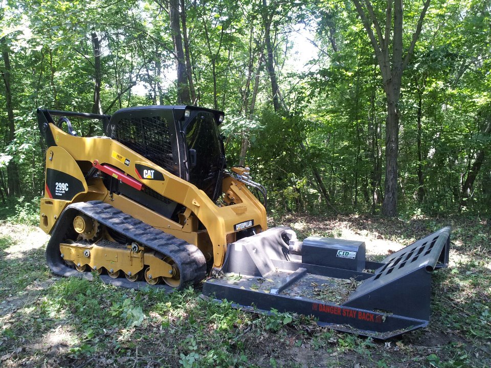

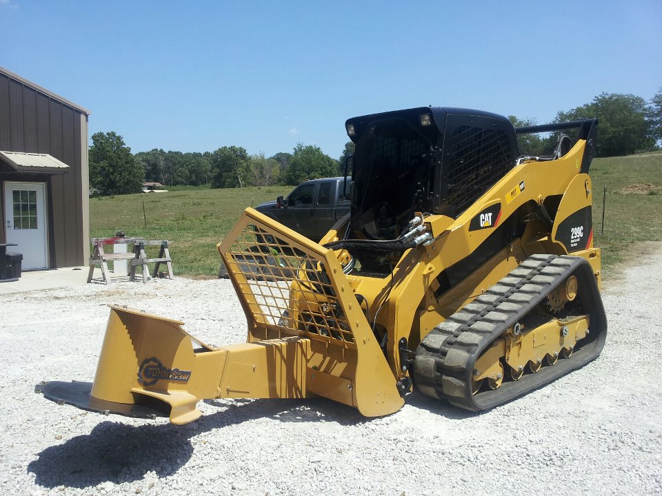

I'm dead set on a 16+6 possibly 8 tilt. I need length to get the saws, brush cutters, grapples, fuel tanks etc. cat1.jpgcat2.jpg
