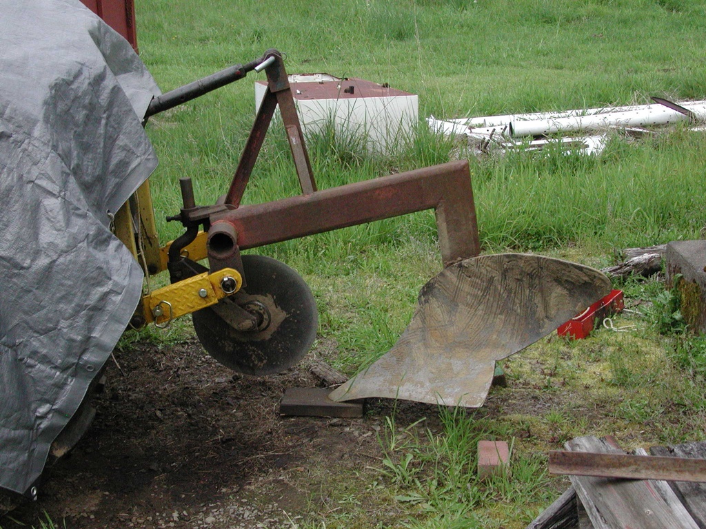

I am needing to dig a trench a few hundred yards to lay a 1 inch water line. I'm near Dallas so I need the trench to be a minimum of 12 inches. Can someone recommend an attachment that can accomplish this?
I'd like something that can maybe be used for other things in the future, for example I may put some french drains in later. I was wondering if a plow or middle buster might work good for this? I'd rather it be a bit wider than is needed for the 1 inch pipe so I can use it for other things in the future. I figure I'll only need to lay one water line but it would never hurt to have a plow or something similar in my possession.

Subsoiler with pipe laying tube mounted on it. Just drive along and it will cut a nice slot and lay the pipe at the bottom of it. When done you just drive over the line to push the ground back down. Does very little damage. Within a week you won't even know where the cut was.
French drains require a ditch witch. Just rent one when you need it. I put on 550feet of 4" drain line. The ditch withch cost $125 for 4 hours. It only took 45min to cut the trench.

A plow isn't really going to reach deep enough for what you need. The 758B backhoe for your tractor (if you can find one) is going to run about $4k so you need to have many uses for it to make it worth it. A subsoiler would be less than $500 and work for your small lines, and larger lines can be dealt with in other ways (a couple parallel cuts with a subsoiler and a narrow shovel to clean out the hole does do okay for 4" to 6" stuff down to about 18" deep as long as you don't find big stones).
