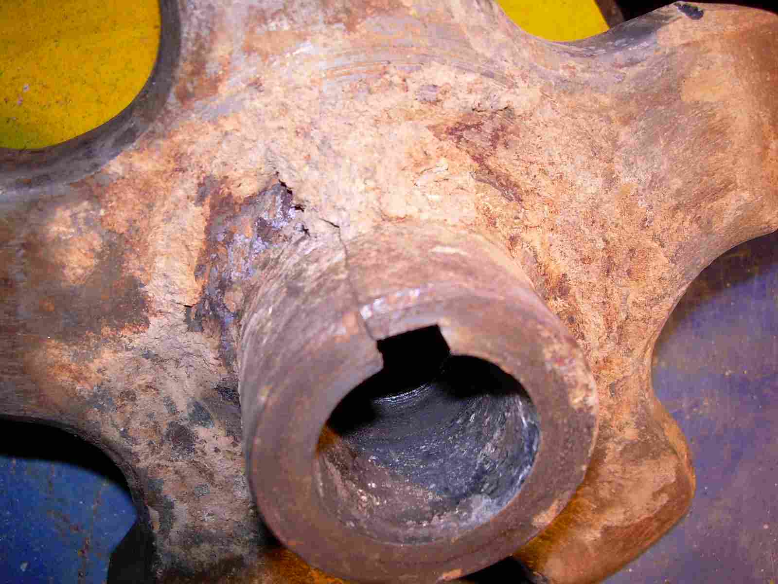

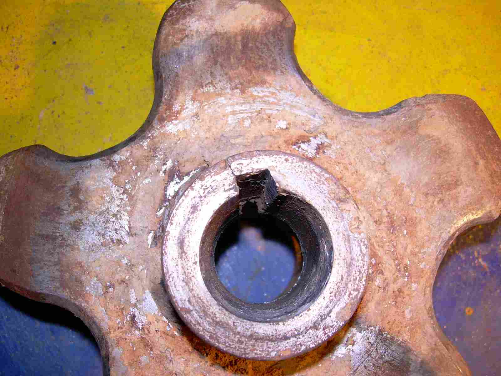

I had another trencher problem last week end. The nut holding the drive sprocket on came loose and the sprocket moved out about an inch. Upon inspection the drive sprocket had a crack in the keyway and the inside was distorted. The keyway on the motor shaft was damaged. I filed it down to take out the lip of metal generated. I ended up buying a new sprocket and the special socket. This time the socket was loose on the nut and was easy to remove after tightening. I used the impact wrench and then torqued to 100 pounds (PT had no spec on this torque). I also used red locktight on the nut. I just hoped that the damaged keyway will not fail soon.
When this kind of failure occurs I always feel kind of stupid, knowing that I must have done something wrong. On the other hand if the first special socket had fit right and I had some instructions about using locktite it might not have been a problem. Total cost this time was about $156 dollars.

I took two pictures of the sprocket. You can see the crack in the keyway and perhaps the distortion in the hole. The sprocket was about $90.

Power Trac send me a new castellation nut with the sprocket. It fits the special socket a whole lot better than the old nut(it's loose). This makes installation of the sprocket very easy.

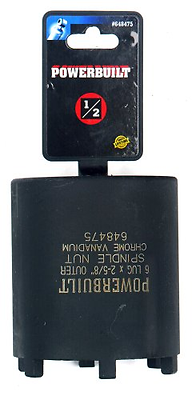

FWIW, I think that the tool is called a spindle nut socket, and while it looks like a Tazewell special, you can buy them. The question being the relevant size...the one in Bob's photo looks like it is slightly over an inch.
Ebay:
All the best,
Peter
