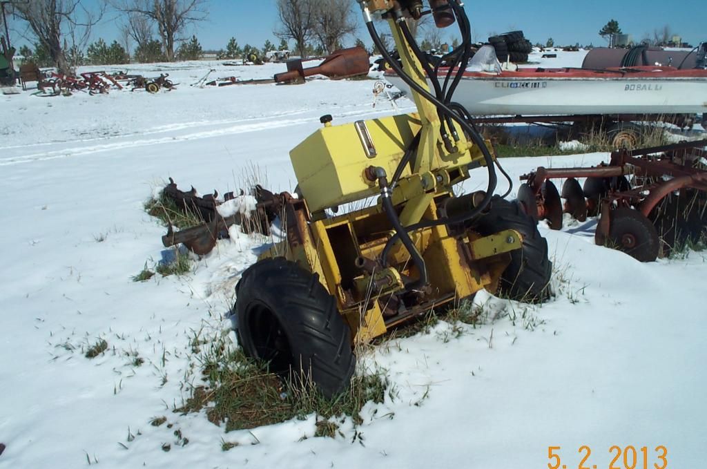

I have a home built back hoe I have for sue on my 4020 large tractor, the tractor is more tractor than it should have for the back hoe,
I have a Old Auburn trencher, at one time I made a creep drive on it, the tractor is to heavy for the drive, thus does not work well and gets stuck all the time. use on the 4020 tractor, (do not have the tractor it was designed for that would have been split and a creep transmission put in the tractor.

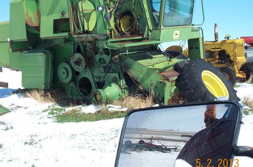

I just got a gas John Deere 6 cylinder 404 engine from a old JD 105 combine, (similar to the engine in the 4010 and 4020 tractors,
have a old 6600 combine for a axle or a old Massey Harris 82 combine axle as a possibility as well

the axle would be driven by a small Hydraulic motor (probably the one that I made the creeper drive out of,

One option I see is mounting a sprocket on the trencher wheel and one on the tractor wheel. Instead of trying to push the tractor with trencher wheels drive the tractor. ?????
Just a wild guess just from looking at the pics.
You have a lot of parts and pieces and sure do have a lot of options.
In the past I have cobbled different things together. Some were successful, others, not so much. That's why I hesitate these days.
What is all that white stuff on the ground?????? :) :)
