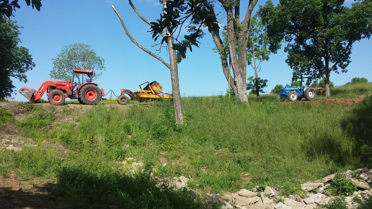

You mentioned that your pond level goes down some in drier weather? Probably the largest contributor to that is simple evaporation. But a secondary contributor is the amount of water your larger trees are "drinking" from your pond.
I estimate the large Cottonwood tree in this picture is "drinking" a minimum of 600 gallons per day in 90F degree weather during the leaf season. The pond is probably evaporating another 600 gallons. So, it's losing a minimum of 1,200 gallons of water per day. On a small pond that equates to water level loss. Spread that over a couple months of no runoff and you have a low pond.
