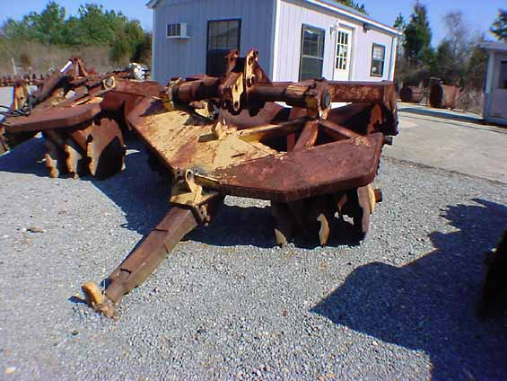

If you are having real problems with roots or stumps think of a Rome Disk.:D
I wonder if my TN70A would pull something that big!

I tried pushing down some of the trees with the TN70A. Trees won, so I brought in a BIGGER friend!
