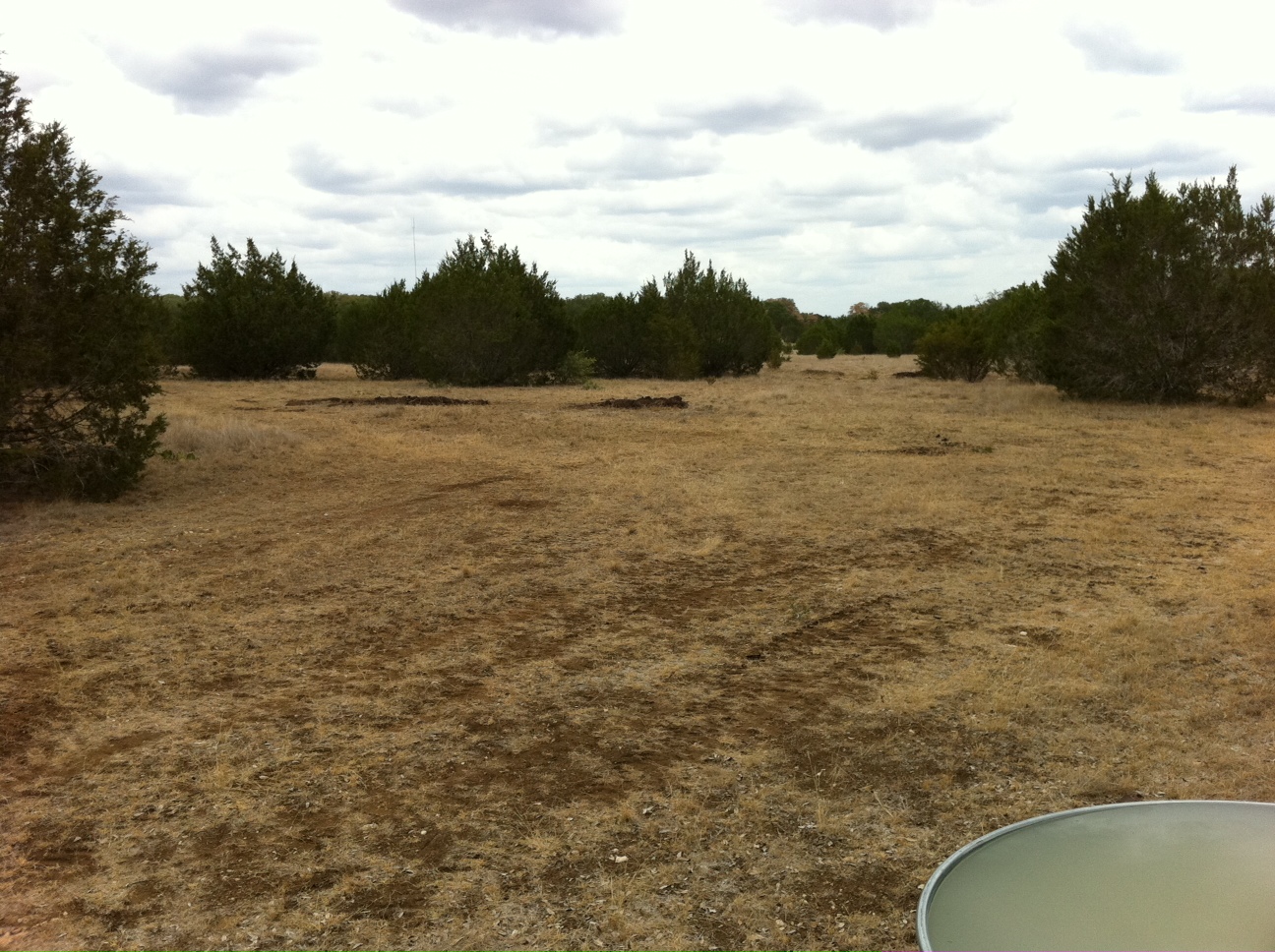

The majority of the cedar trees are much less than a 12 trunk, most are 4 to 10? Cedar trees here are overgrown juniper bushes really. They are low and squatty, perhaps 10 high with some going to 18? but I can use discretion and not shear those.
Here is a typical view of some pasture land that has been overrun with cedars. These are on the smaller side, but you can see, nothing here will hurt me.
Mike
Mike
Now I can see why you can't just walk up with a chainsaw and drop 'em. I guess if that's all you're going to snip, I could see it. But I'd still want a full wrap cage before I tried it. Just make sure you sell the thing when you finish with the cedars - to avoid temptation (like sandman describes).
Almost looks like a boom (or FEL) mounted flail like the hwy dept uses would be useful for sepatating the brances from the poles. You could have a nice stack of fence posts and a few piles of mulch when you're all done.
