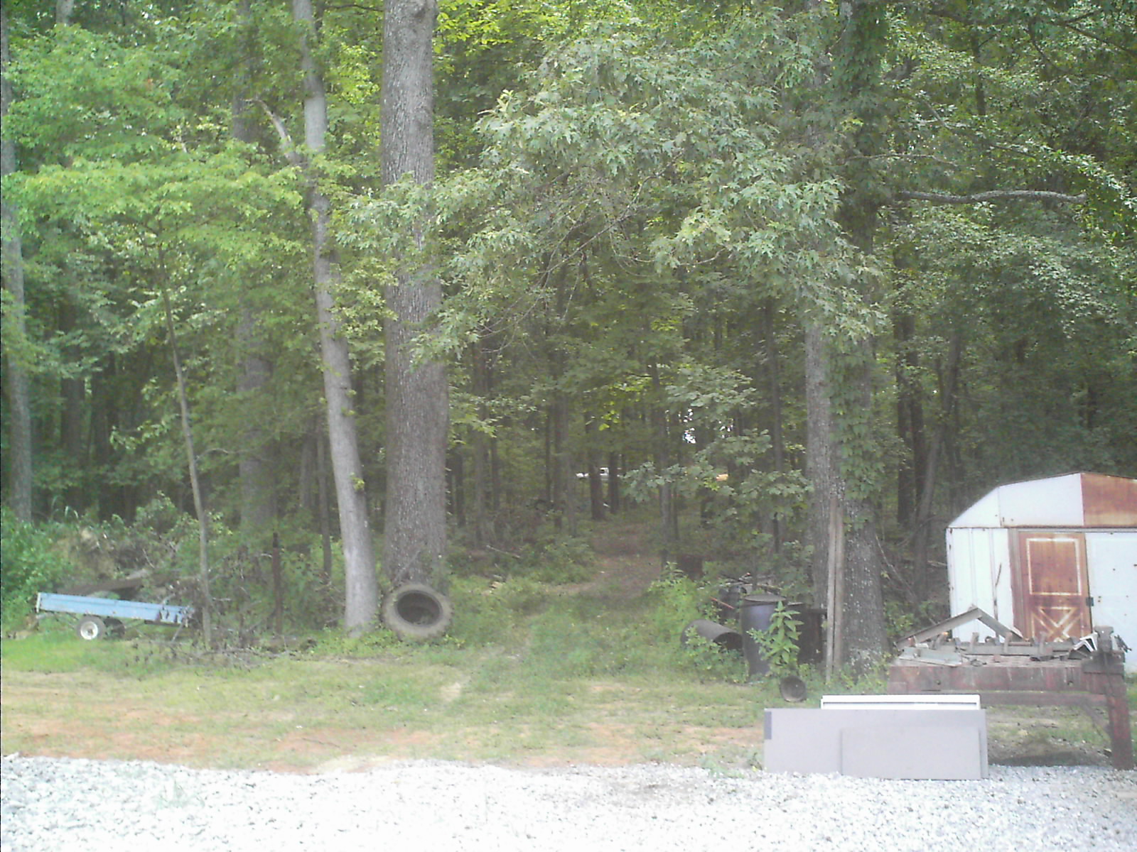

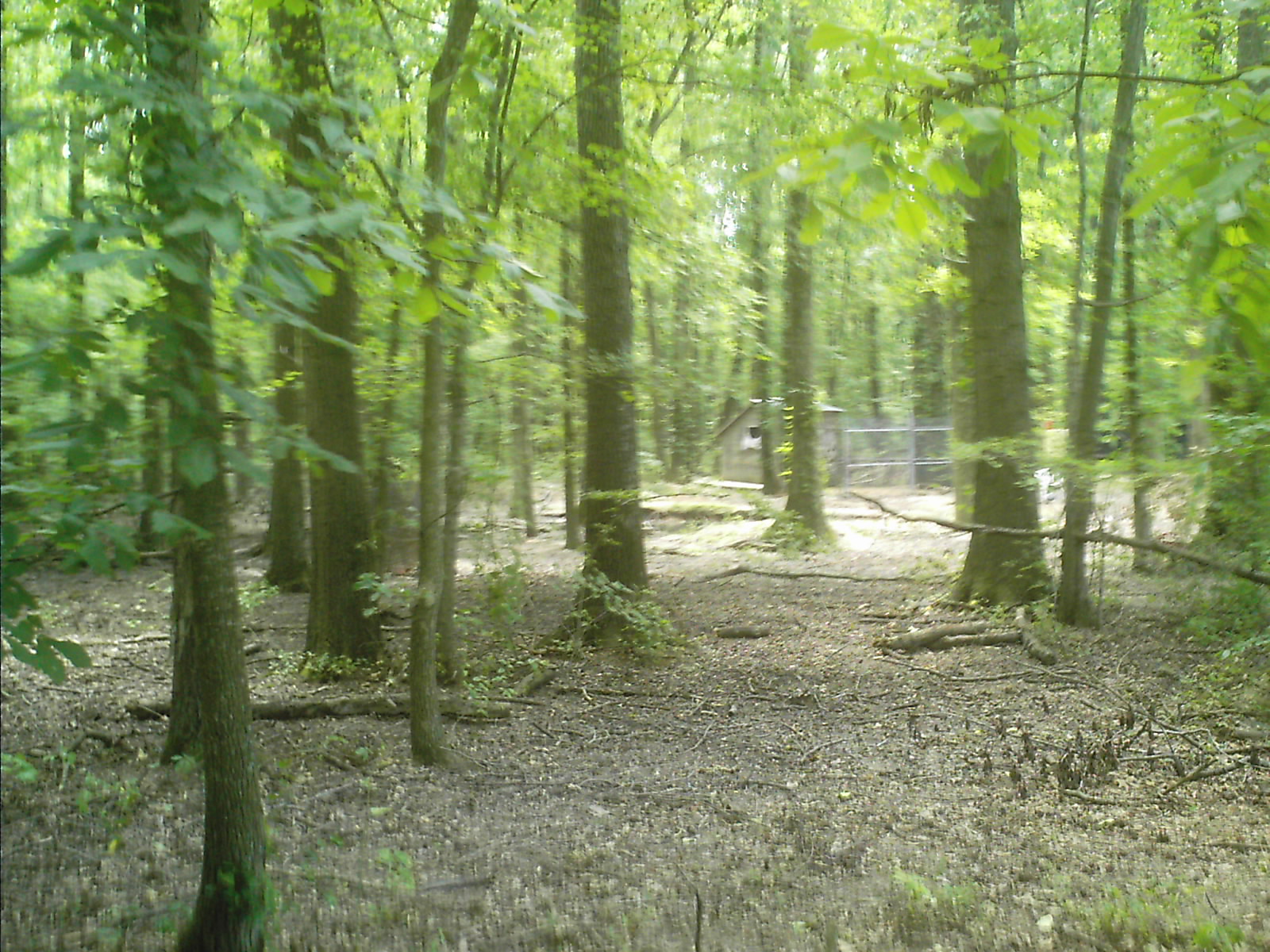

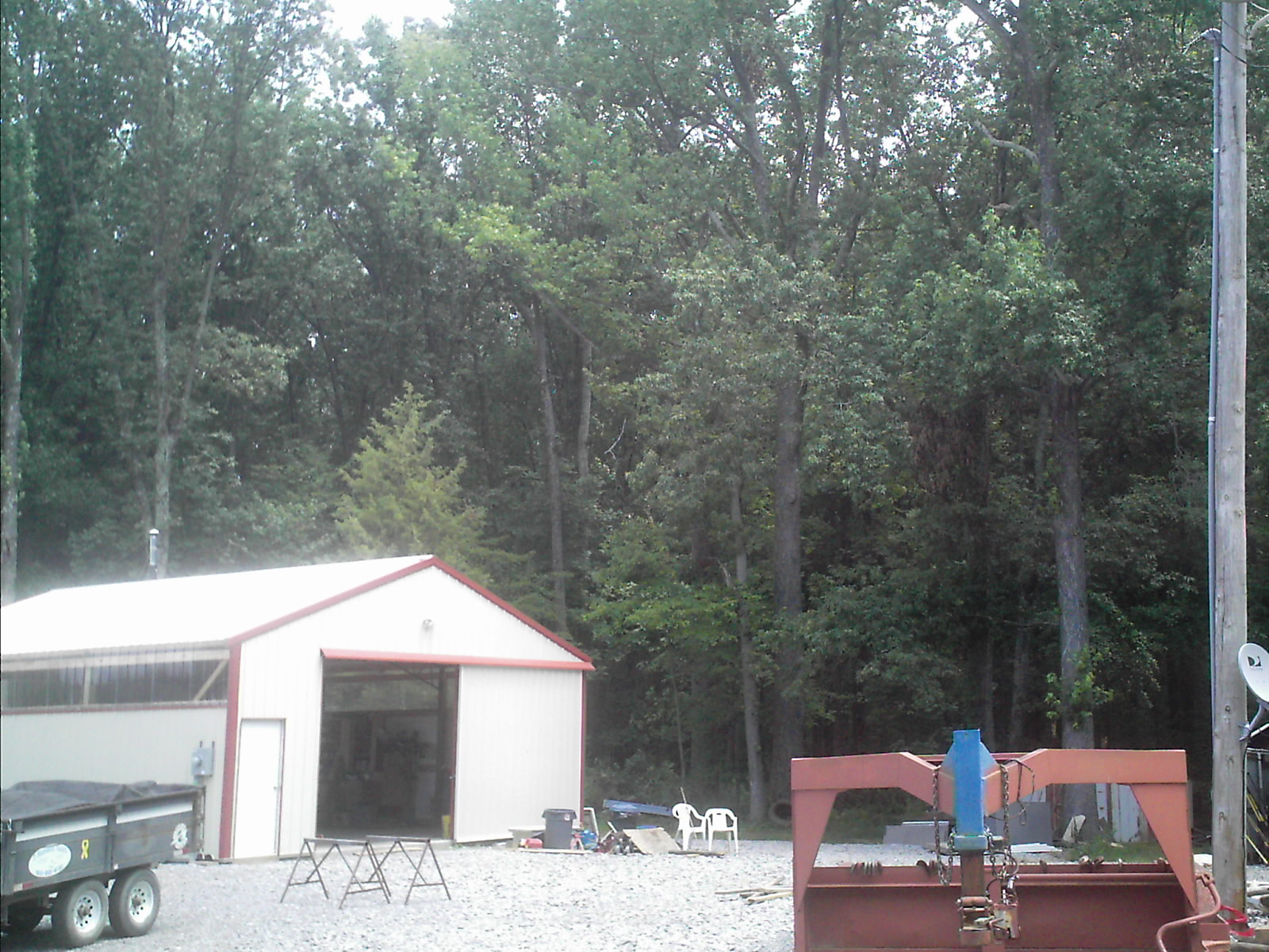

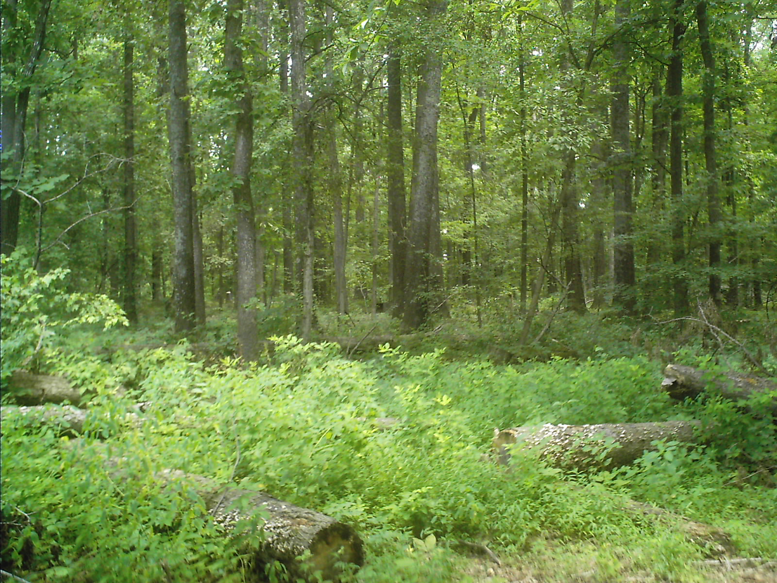

Some pics, shop and truck shown for scale, representative of the area I want to clear out some.
