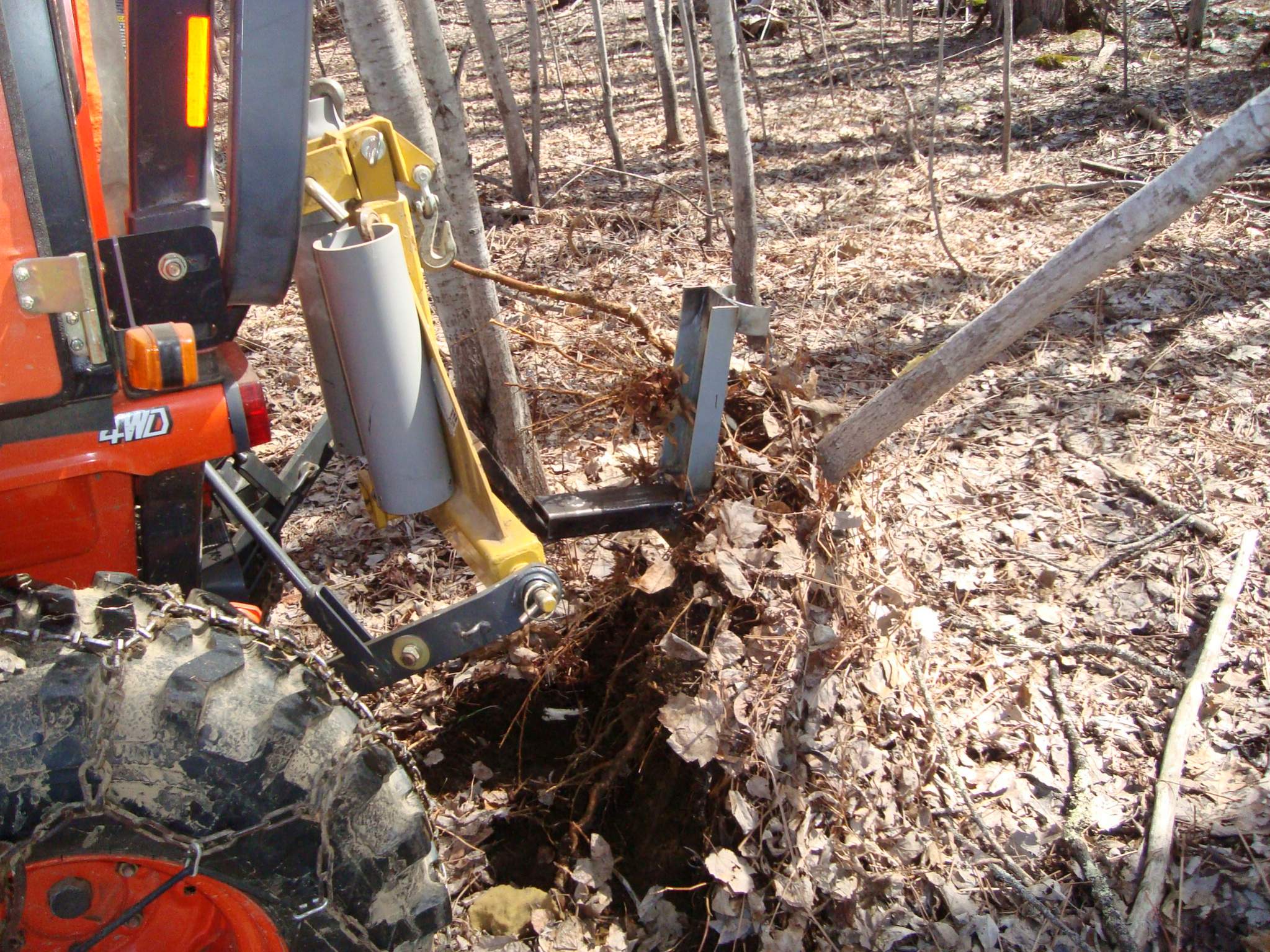

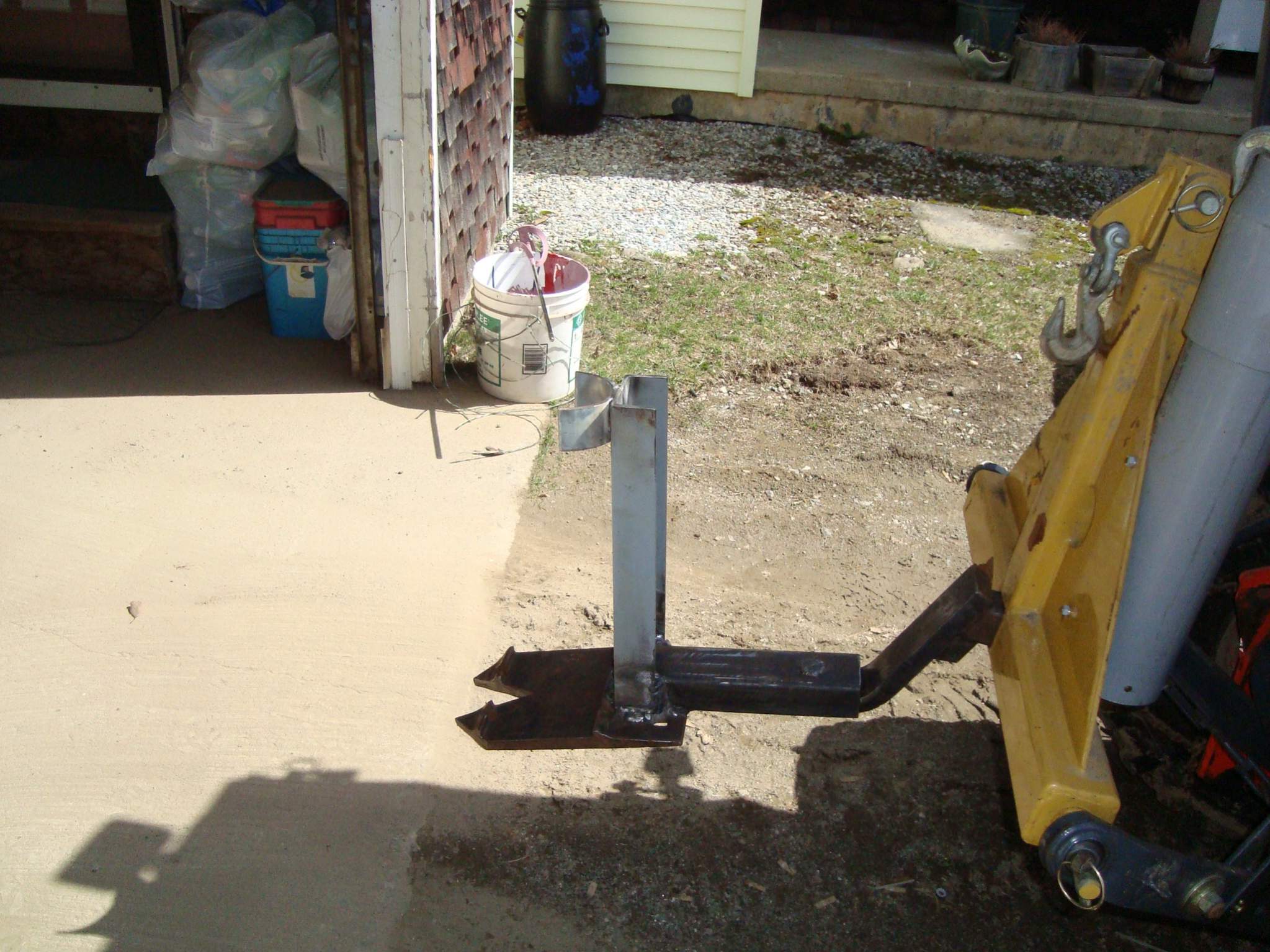

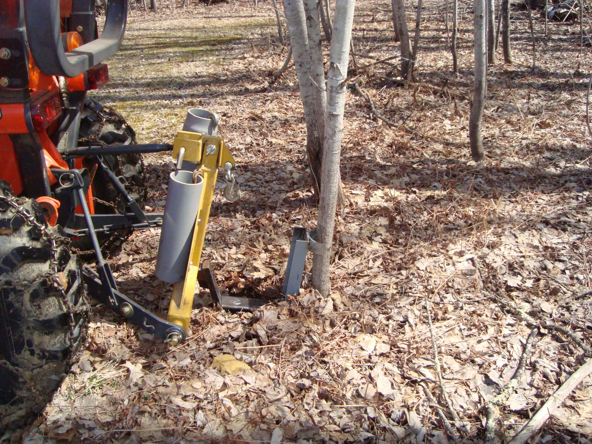

Made this for the back of my tractor.. works great..
