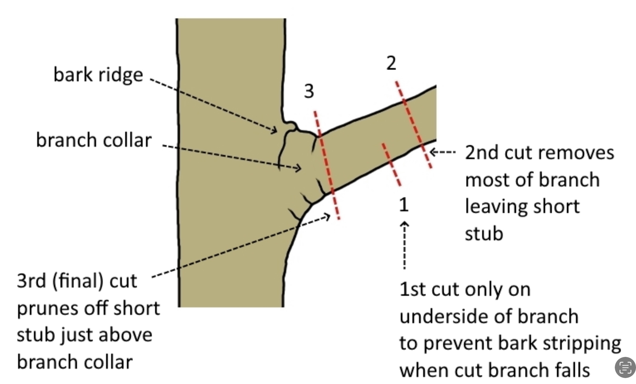

I always make my first limb cut on the bottom. Like this. Avoids potential tear out, hanging branches, etc. Make a small cut on the bottom. Then cut outward of the first cut. When the branch starts to fall, it snaps off cleanly at the 1st undercut.

This is especially handy when cutting a 10" oak limb with a 12" bar on your pole saw, 5 feet over your head. (Although I still managed to take out my sister's fence and clothesline)

I taught my son this one a couple of weekends ago. He had worked 1.5 years for as tree trimming service a few years back and they never taught him this one. They just tried to rip through them fast with their chainsaws so that it did not split. i asked him if that worked very often and he said they didn't care. Personally I like the nice clean trim it leaves for a nice looking tree.
