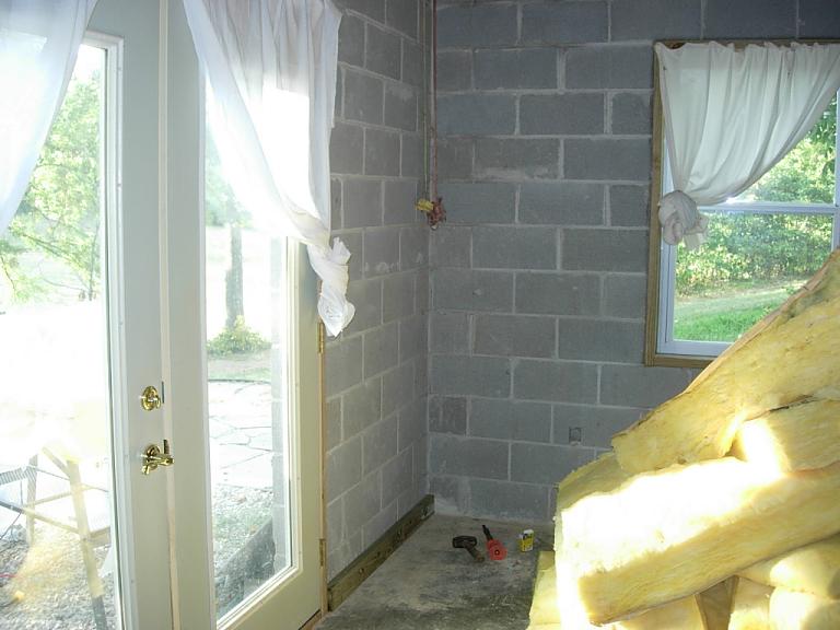

Starting to finish the main room in the basement (walkout). One full side of it is under grade and not visible in the photo. The side under grade is the whole right side of the room and the photo is of the left corner which as you see, is fully exposed to air & sunlight.
If it matters to know, when storms come in, they seem to come in blowing towards this side of the house.
My question is, I've always thought/understood that when ever you have wood to concrete contact, you really should use treated lumber. Once you have a treated plate down, you can then use regular lumber.
On the side of the house that is under grade, I've used treated on the floor and as firring strips up the walls (I used treated 2x4's)
Now on this wall I'm wondering if I really NEED to use treated since it's so open air?
Frankly, I kind of hate using treated because of how freaking wet it is from the store and if you don't use it immediately, how it turns into a pretzle as it dries out.
So, I'd PREFER to use regular lumber (again 2x4's) up the wall as my firring strips. I keep falling back to the "always use treated against concrete or blocks" logic so I'm in a quandry.
Thought I'd ask for opinions?

For the walls in your picture, I'd use a PT plate, I'd even use a sill seal between the plate and the concrete floor and use regular 2 x 4s as wall studs. There's noting wrong with using PT inside a house.

Keep PT on the floor in all cases. For the wall furrings, you should be okay without PT. My last house had a similar basement - concrete floor/block wall. The wall furrings were not PT and everything was good after 15 years of use before I sold it. But I couldn't vouch for the code...

The issue is block and concrete can absorb moisture, particularly concrete floors. This moisture can then seep into the lumber and cause rot if it's not PT.
With block walls, they should have been treated with sealer (below grade) or paint (above grade) so they won't transmit moisture to the studs. A 'pants and suspenders' kinda solution would be;
1. 2 x 6 PT sole plate with sill sealer beneath it.
2. 2 x 6 top plate
3. 2 x 4 wall placed flush with the interior edges of the sole and top plates
This will keep the 2 x 4s 2 inches away from the block wall.
