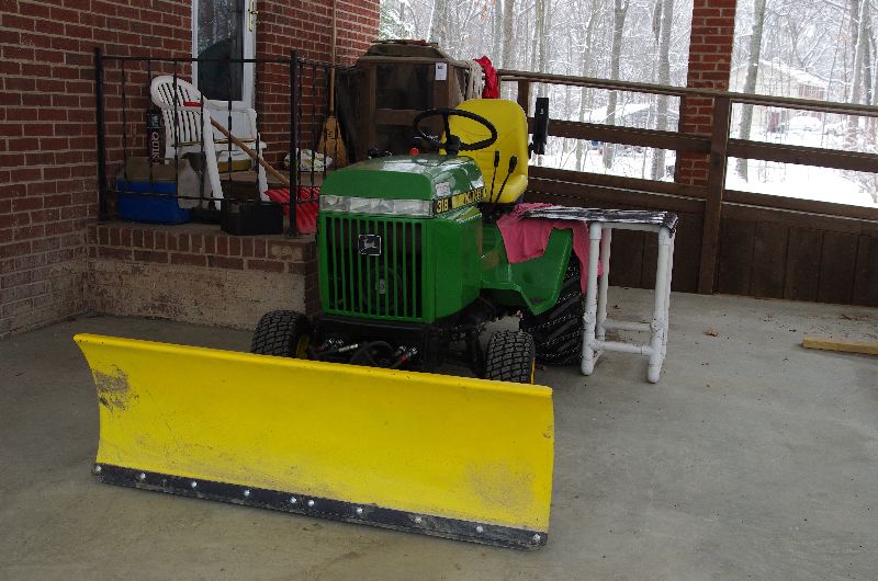

I know the feeling with all the pedals and levers. I have the two turning brakes on my JD of which I don't really use, (even though I have made handles I can push if needed) I have used them when snow is REAL deep and wanted to crab to one side when I had the blade at full angle and that did help. Don't have the diff lock on mine, but that would be another thing that I could lift my leg up and put my shoe on.

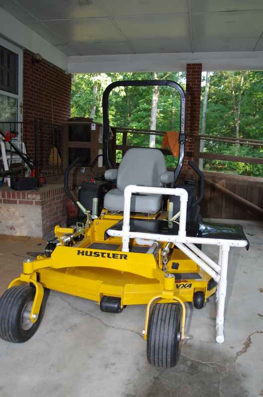

Just wish I knew the height of the seat in a 1430, maybe someone out there can measure it for me. I have made platforms I jump over to for my JD and Hustler mower.

The front of my chair is about 22-23". In the post before this one I put some pics of what I use to get on my Zero Turn, and JD now. I just push them away from the tractor, or flip the stand I made back for the Hustler to get on it. Then I can reach when I am on them to get them close enough to the machine.
