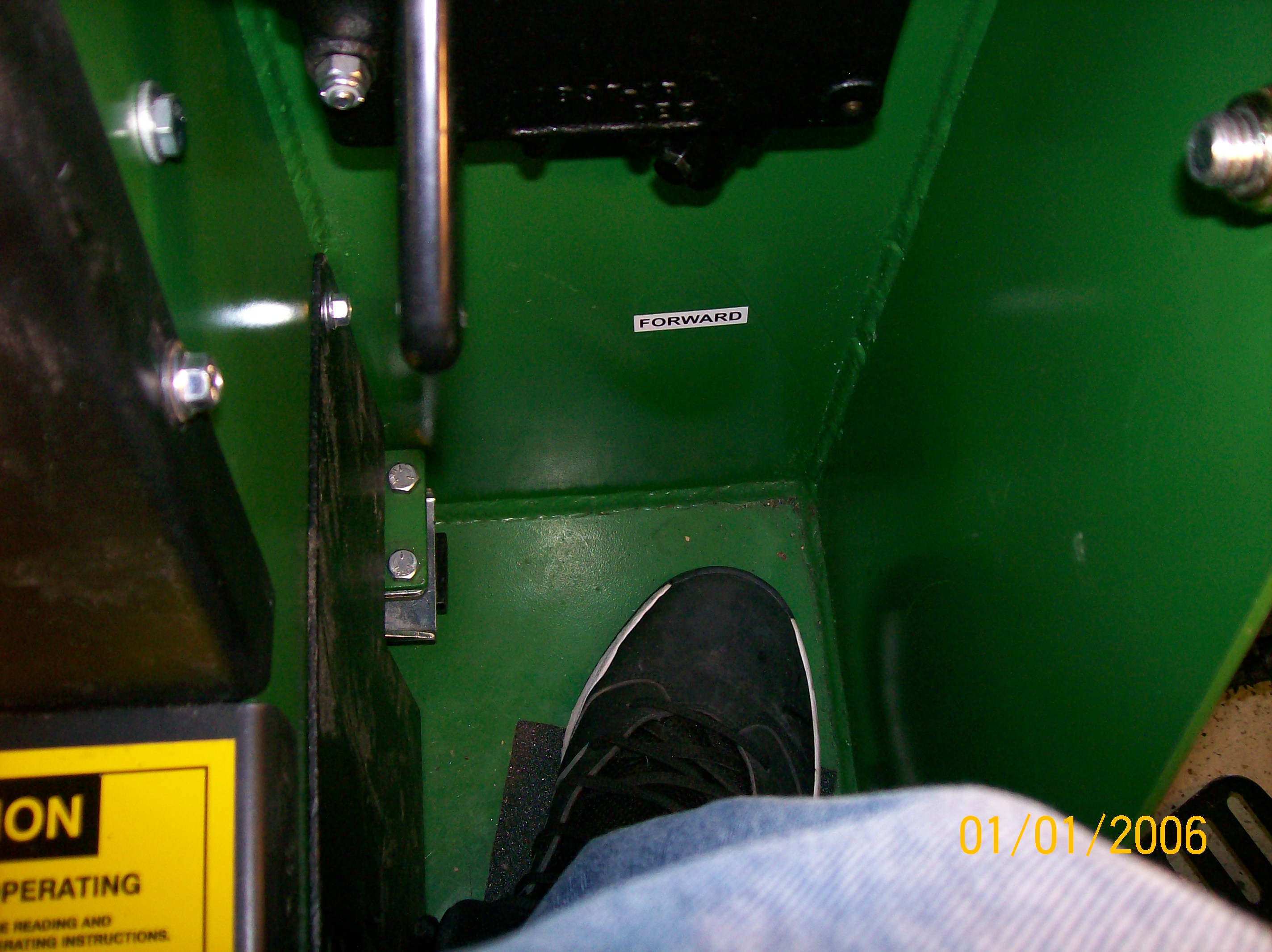

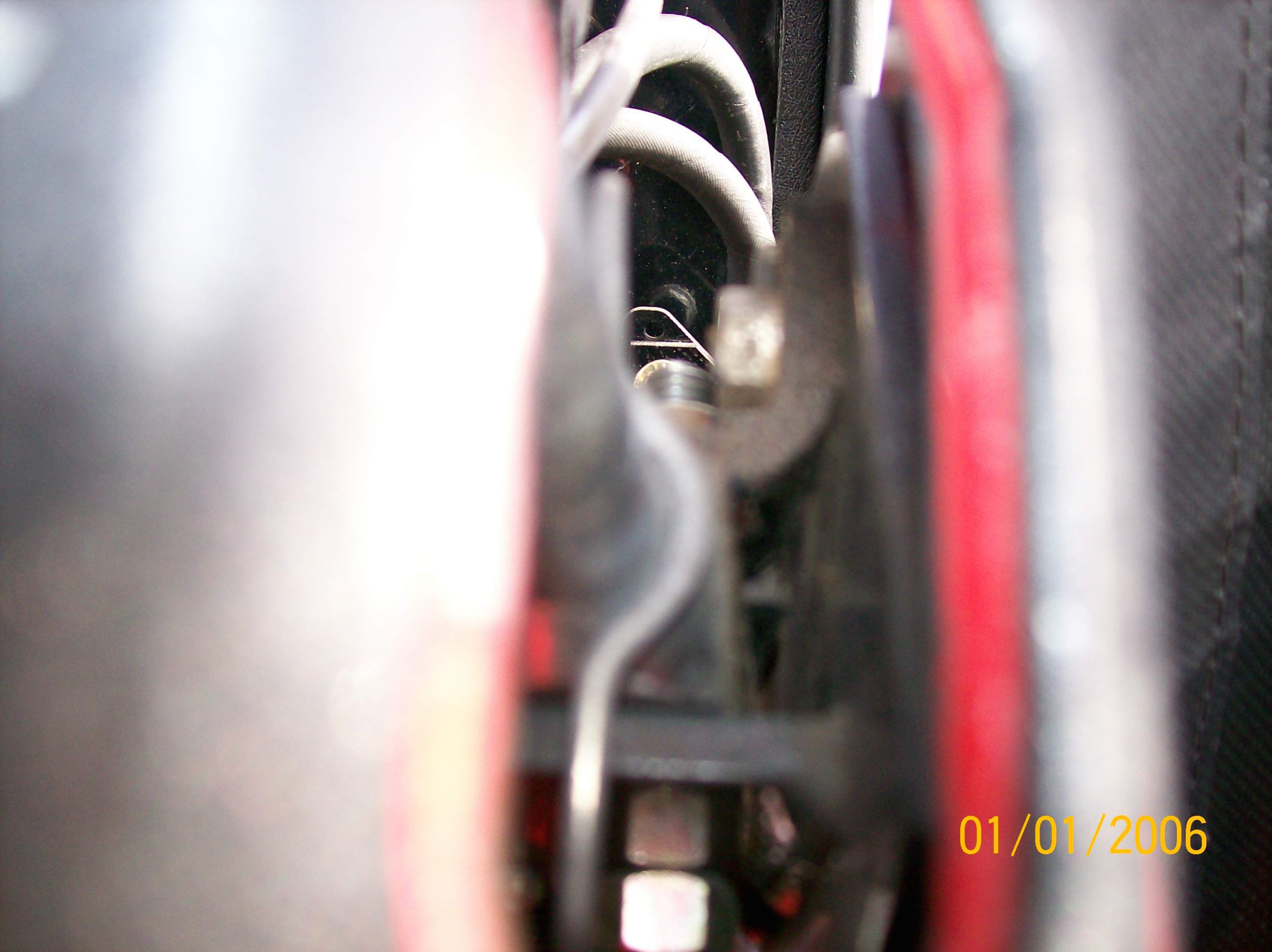

Do you know what type of spring is inside of that little bellow/boot above the foot treadle? I'm wondering if its a gas damper/spring or itif its just a steel spring?

I'm thinking you have a hydraulic treadle and that's some sort of dampener, but I'm not familiar with it. I have a cable (called the hydroback cable) from my treadle through the tunnel all the way to the hydraulic pump and the cable is spring loaded.

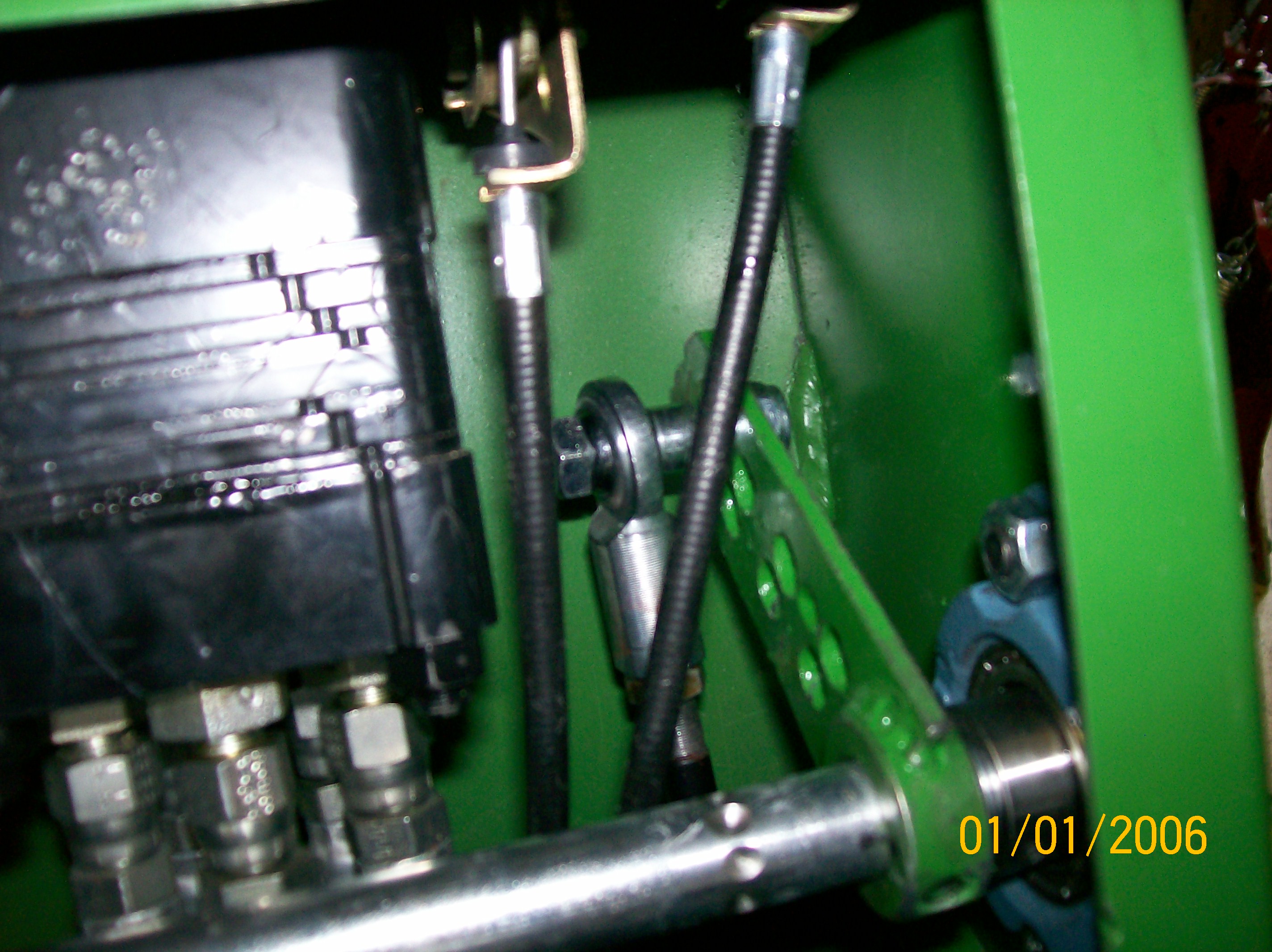

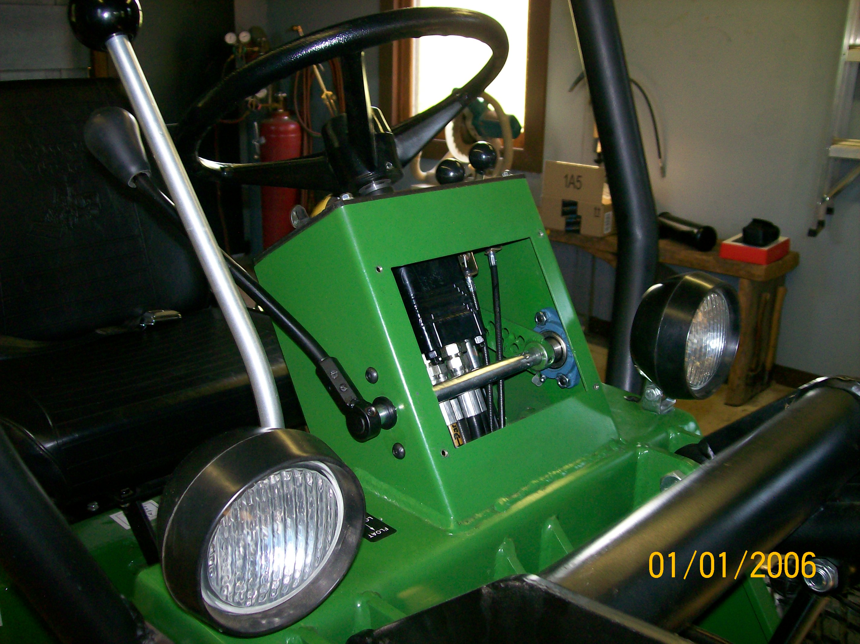

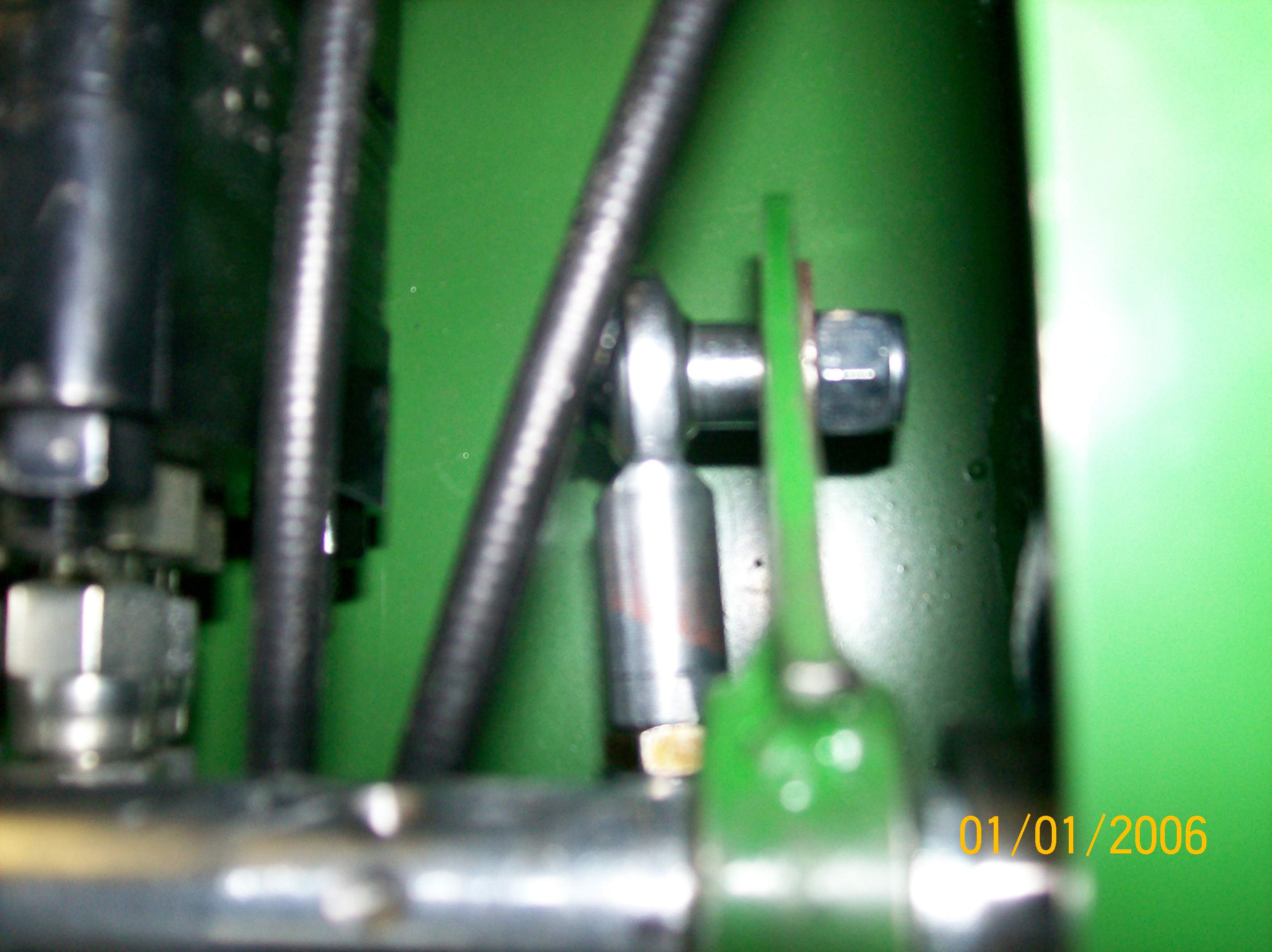

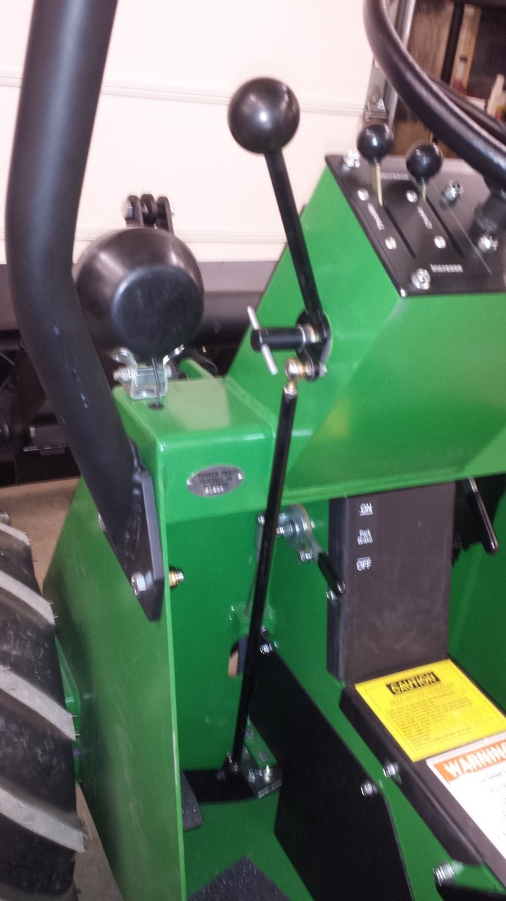

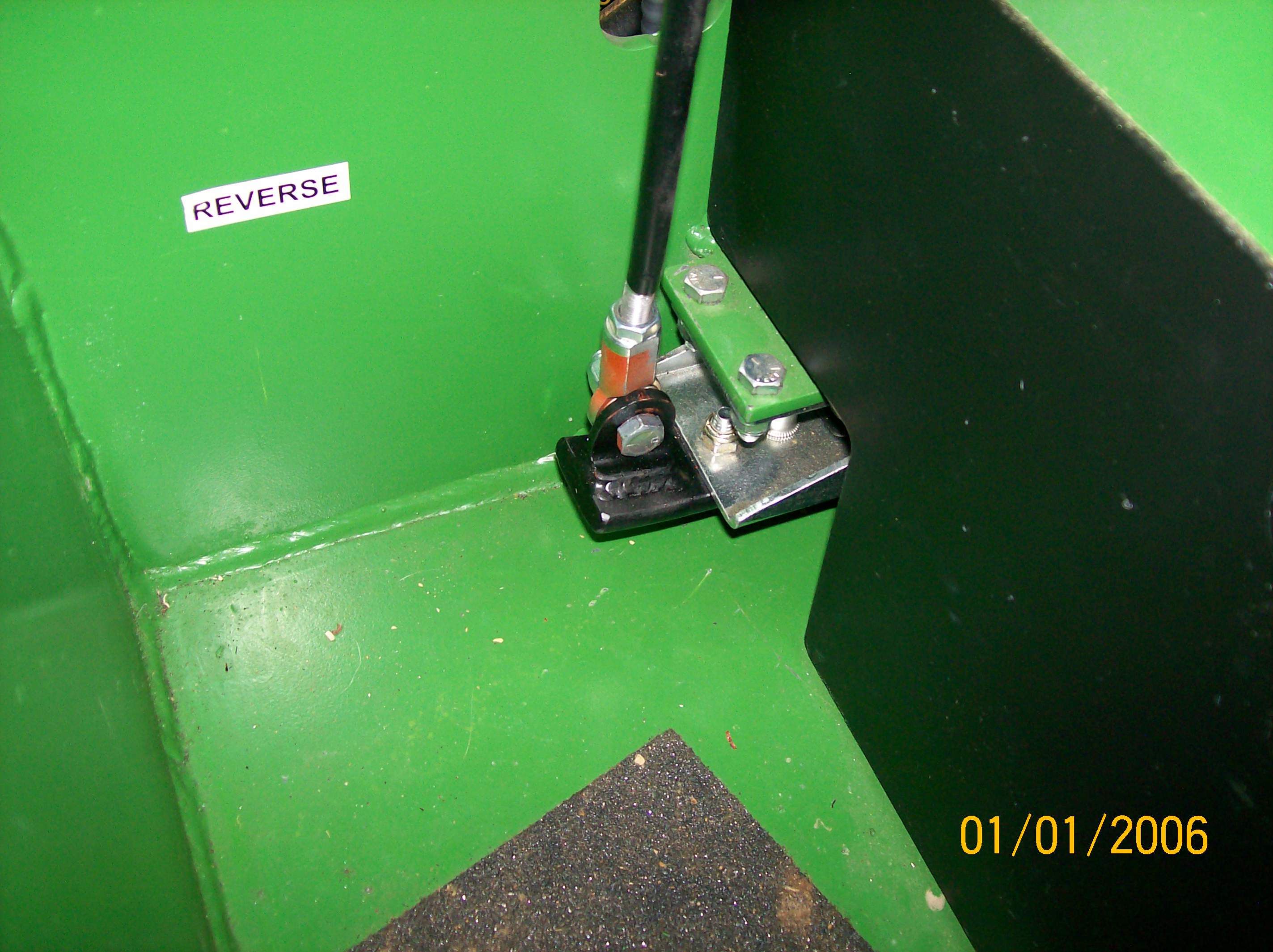

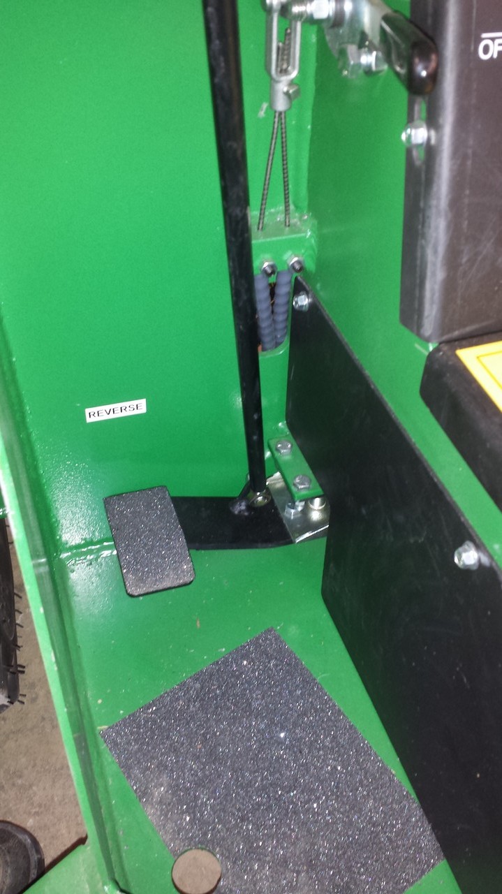

Josh and a few others, I think you wanted to see how they were going to make, or mount the hand control I had put on the 425.
They put a long skinny handle on it, (of which I didn't like) so I put some threads on it, and mounted a knob on the top of it, was a lot easier to use your palm of your hand to control it.
The "T" handle on the side of it lets you put more tension on it, and if you turn it all the way off it will let anyone use the treadle to drive the tractor. Came out pretty good, now to get some seat time in, and they are calling for nasty weather the next few days, but will let me learn more about things.
View attachment 417278 View attachment 417279 View attachment 417280
