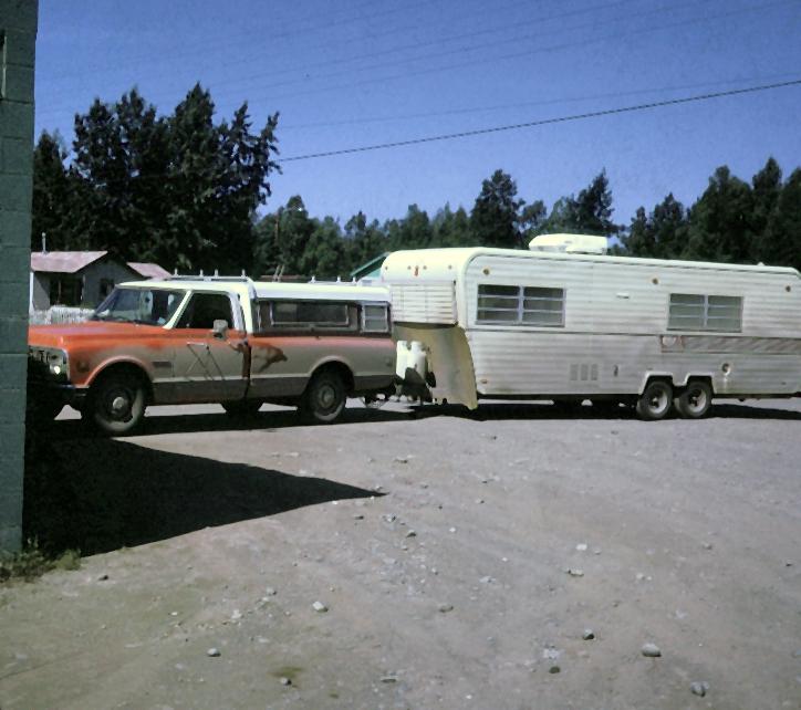

Talk of the dings from gravel on the front end of a travel trailer reminded me of the attached picture. It's of my rig about to pull into a coin car wash in Anchorage in July '72. Fortunately, I had family who had driven that road before so I knew to put the bullet shaped plastic covers over the headlights, and a full sheet of plywood on the front of the trailer behind the propane bottles. You can see that it got chewed a bit. The truck was less than 14 months old and the trailer was about 3 months old.:D There in Anchorage, I met a guy with a brand new sheet of plywood on the front of his trailer and asked him why he'd put new plywood on in Anchorage. He said no one told him to put plywood on before he started north, so rocks and gravel went all the way through the front of his trailer and into it. And of course, I had the busted windshield replaced on the truck as soon as we got back to Dallas.
