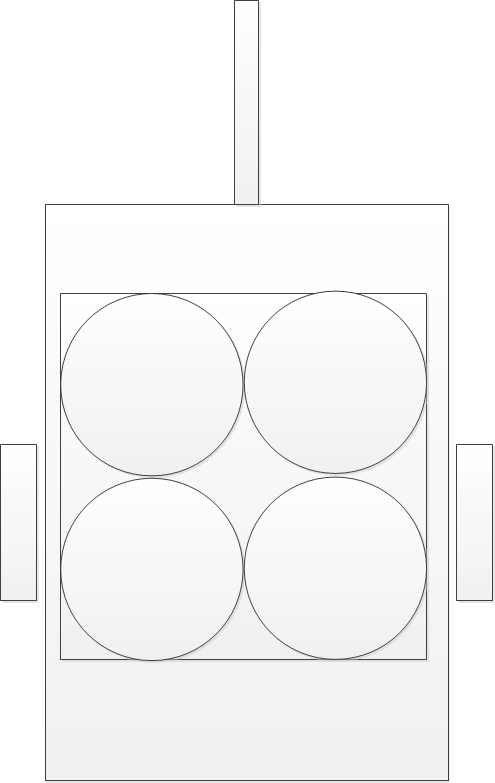

I built a trailer over the winter (still need to paint it) and am looking at the possibility of hauling water on it for various purposes. The deck is 42" wide and ~60" long.
I am debating one of the following barrel configurations:
1. 4 Barrels vertically in a square on a pallet:
Benefits:
  • Not much sloshing due to less surface area on top
  • Efficient use of space
Downsides:
  • Hard to plumb (have to add 4 bulkhead fittings in the bottom)

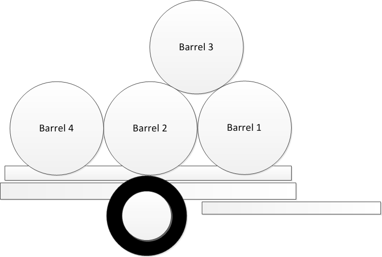

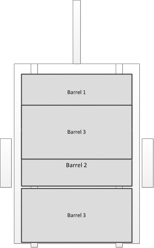

2. 3 Barrels stacked and a 4th behind:
Top view: TrailerBarrelsSide_Top.png Side View: TrailerBarrelsSide_Side.png
Benefits:
  • Easy to tie down
  • Easy to plumb
  • Low COG
  • More water usable (top 2 barrels will drain into the lower ones
Downsides:
  • Less deck space available
Anyone have any thoughts?

220 gallons of water will weigh 1760#, there is a 3500# axle under the trailer and it will be pulled with either the RTV500, or the B7500 either of which will be fine with that much weight.
I plan to have some straps to hold the barrels down to the frame and more to hold everything down to the trailer.
