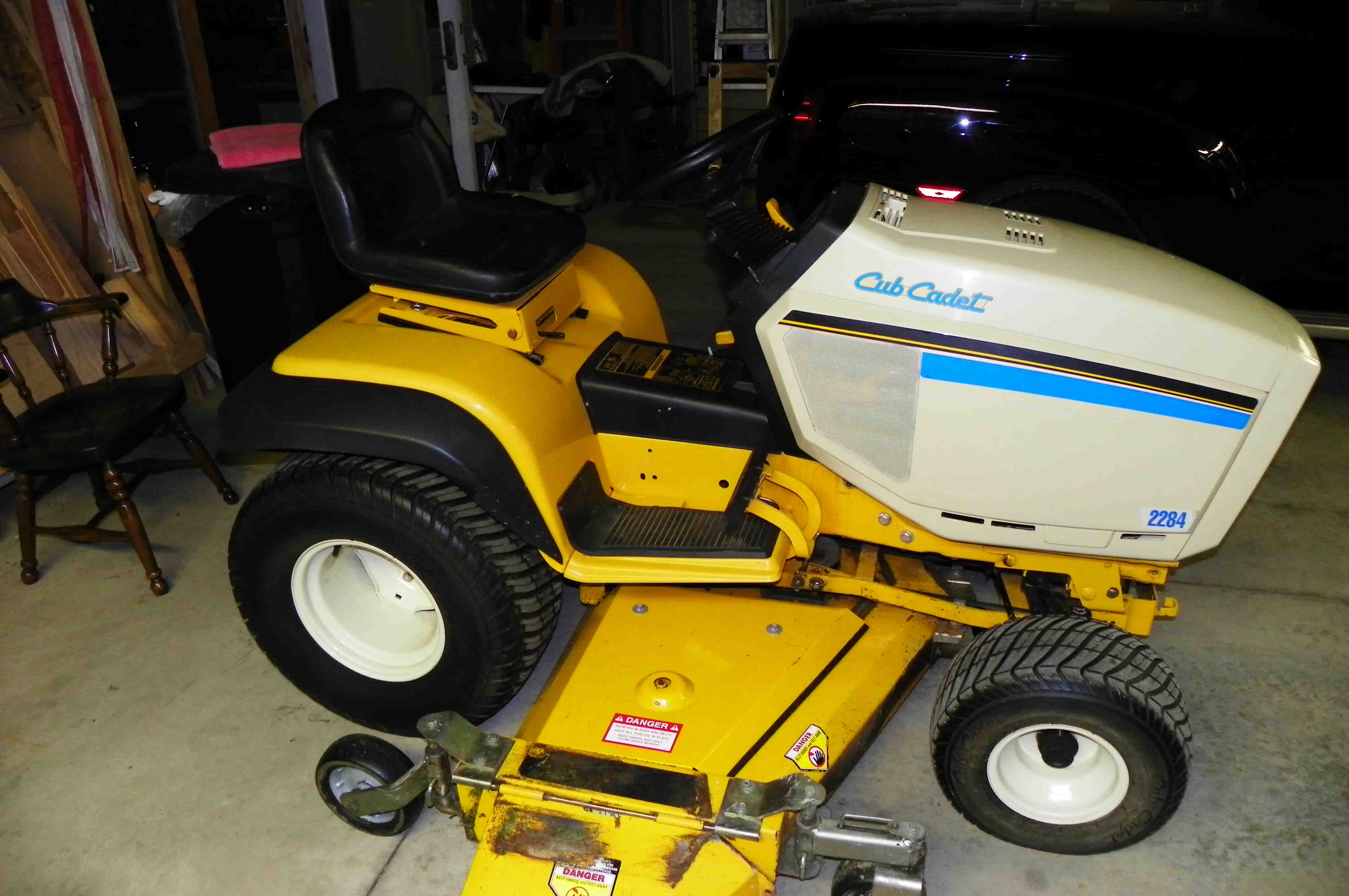

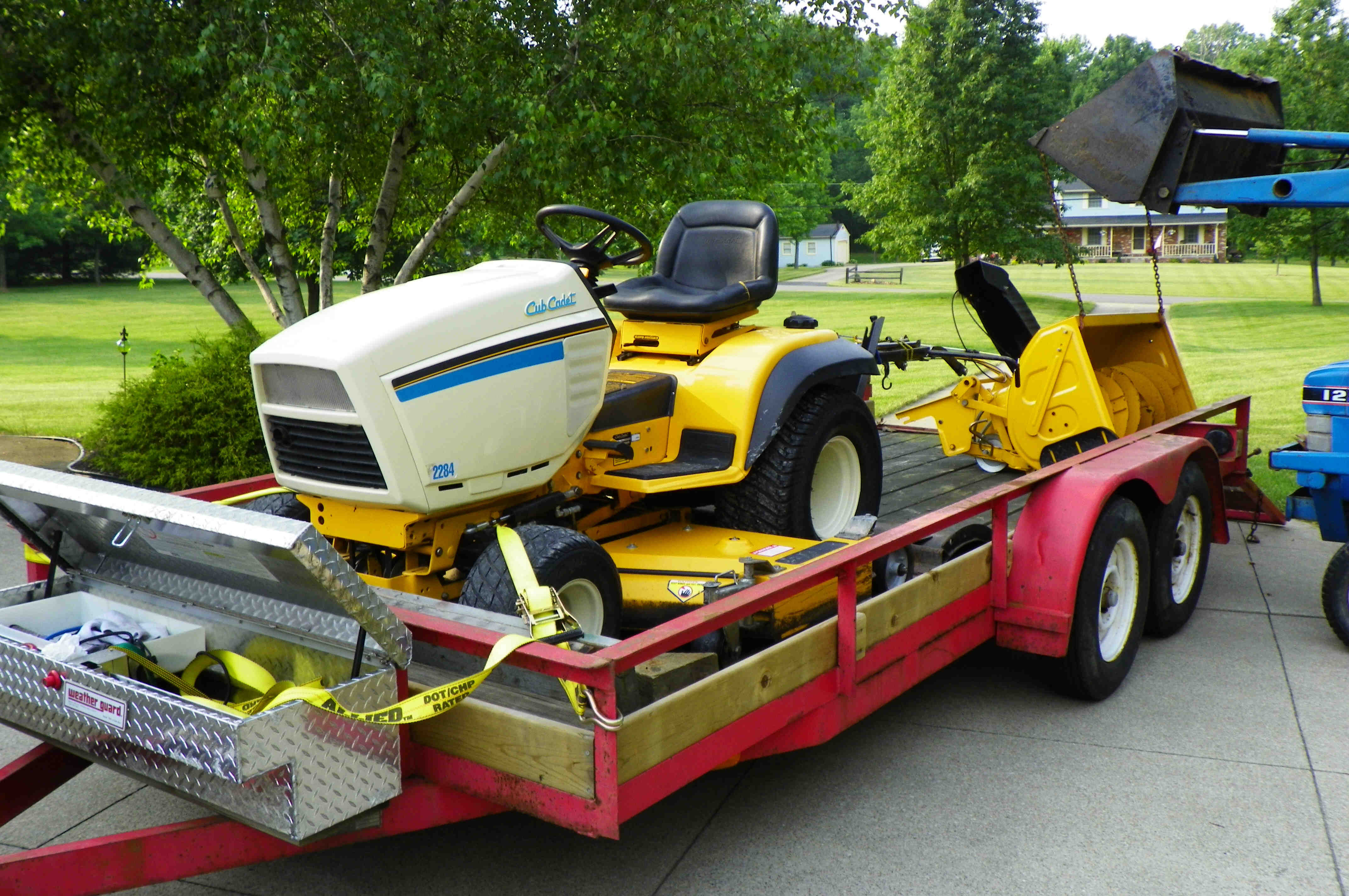

Well, the bad news from Sterling was $1000 to $3000 depending on the failure. The $1000 was for a charge pump replacement but I don't think didn't included labor. The $3000 figure was for the hydro rebuild with labor, they will be bringing it back tomorrow. He told me about the $3000 likely scenario first and I just sort of tuned out to further info. I may just list it as is on Craigslist, what would anybody guess is a good asking price? It's a 25HP Kohler Command with 350hrs, and the deck would be of value to someone?
The good news, I found a 97 2284 with 570 hours, a 551 snowblower and 54" blade for 3k.
The tractor has many well thought out design features, building on the SGT series, time will tell, but my backup, a 1986 1872 is about to turn 1000 hours and still runs strong.
I may investigate the M & D option, I don't need to rush to a decision now.
Frank, I'm mowing about 2.5 acres with the Cub Cadet and two additional acres with a 6' Landpride. How big is your Tank, I found some really good deals on a couple of 48's but I really like a 60" deck, it suits my flat property well and really help getting under pines and trimming close to stuff. My BIL claims his turfs on the inside wheel whenever he reverses, have you had that experience?
Anyway, thanks for the opinions and information.
Here's a couple of pictures of the 2284.
Curt
