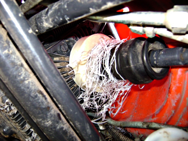

Ok so today I trashed the transmission fan on my BX2350. where do I start on the replacement? what I mean is what is it that I have to do to get the old one off and then put the new one on? And before anyone pipes up about a skid plate, yes I have one from bro Teck but somehow a stick found it's way through and tore nine of the ten blades off, the tenth one is just hanging on by a thread.
Now I can make a new one out of Stainless Steel but I still have to get the old one off so that I can see how it's made. Any suggestions?

Just go part-way into the replacement procedure .
Are you going to make a two-piece metal replacement ?

I sheared the blades off mine a year ago the same way on myBX2200. The dust boots on the CV joints were worn out also, so I replaced them and new ball bearings and some grease at the same time.
I did not have a manual and total job took about 4 hours. I accessed from underneath to remove bolts of the driveshaft, then took off the pedal & floorpan and removed the shaft from the top.
If I remember correctly the floorpan was kind of tight to remove without taking off the seat, but I got it off with no damage. The shaft was a tight fit also, but I got it out a lot easier than removing the engine!
This would be a good time to replace the fuel filter under the tractor if it needs it and if your fan belt is showing wear, replace it now as you have to unbolt the driveshaft to change it.

I replaced the fan on my BX2200 from underneath without removing all the stuff the WSM says has to be removed. I used a crowbar to shift the engine forward enough to get the shaft out. The engine shifted forward enough without taking the motor mounts loose. I then made a skidplate so I don't have to do that again.

Dodge Man This is wood cutting season here in Manitoba and whilst I can machine a new fan and dismantle the tractor to put it on, the problem is that I just don't have the time to play around with Kubota's Bullsh#t. So what I'm going to do is get a new and NOT improved plastic fan, put it in the lathe remove the inside of the hub of the fan and then cut it in half. Then with the engine running and using the tractor as a lathe and chisel for the wood lathe I'm going to lathe the original hub down just a tad to smooth out the bumps left by the fan blades Then I'm going to epoxy the new and improved fan over the old hub. Yes it will be slightly out of round but who cares.
It's a cheap and dirty fix but it will be fast and it will work and I'll be back cutting wood..
When wood cutting season is over and i have more time I WILL make a NEW and REALLY improved fan with a splined shaft if for no other reason than that I can improve on Kubota's design, AGAIN.

This crap machines like cheese, as a matter of fact I didn't even have to fabricate a steady rest, just held the chisel free hand, now all I have to do is go to town and get a new fan, lathe out the hub cut it in half and glue er on. dunn deal and just as good as the shop manual version but a whole lot quicker and I didn't even have to pick up a wrench.:thumbsup:

No beating around the bush.... Nice solution. I will keep it in mind should the unfortunate ever happen to me. Do you know if the fan blade is nylon or some other plastic? Getting things to stick to some plastics is tough. Nylon would have been a good choice for the fan, ie could provide some heat resistance, etc. AND lots of things stick to nylon.

Dennis, somehow I don't think that it's nylon, firstly if indeed it was nylon these fans wouldn't break like they do, the fan blades would bend. I tend to think that the material is a very cheap grade of polyethylene. or the same crud that kubota uses for their fenders and hoods. Problem with polyethylene is that nothing really likes to stick to it, epoxy works if one scores the surfaces slightly with a torch to give the epoxy something to bite into. And with the large surface area involved here and the very light weight of the fan blades and hub, the epoxy really doesn't have to hold that much as there is very little torque involved and it's not screaming like a Dremel tool. What I have done is stick two of the old fan blades together to see how the epoxy holds. Even if the epoxy doesn't stick too well a couple of small screws along with the epoxy will take care of that problem. Anyway I look at this it's better than pulling the tractor apart.
