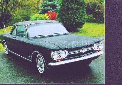

My Kubota dealer said that the UDT was used as the first fill to help the bearings and races to seat as well as the gears to "run in". At the 50 hour service they install 80 - 90 gear oil where Kubota says that it is OK. When I lived in NH back in the early 1960's, my Corvair 4 speed wouldn't shift easily through the gears until the gear oils warmed up...... sometimes that took forever because it was -20 degrees... I found that the Army had the same problems during WW II and that Kendal came out with a 80 - 90 - 140 gear lube to resolve the problem. It worked well in the old Vair and I have used it ever since in the one that is now restored. Haven't looked for it in the stores for the past 10 years, but if it is still available, it might be a good lube still today. I know that a lot has changed in the R & D of lubrication, so this product might not still be available. It was called Kendal 80/90/140 Three Star Gear Oil. Some people also added an oz of molybdenum disulfide to the gear oil if they still had shifting problems, but mind didn't need it...
