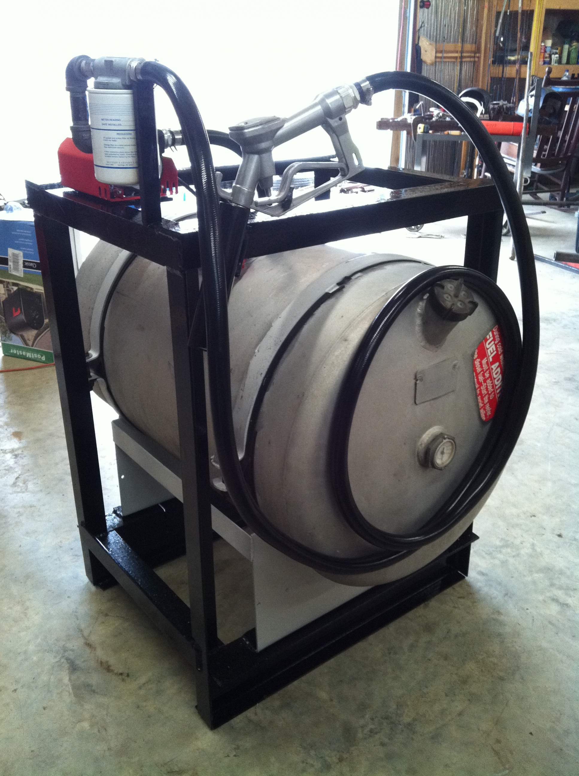

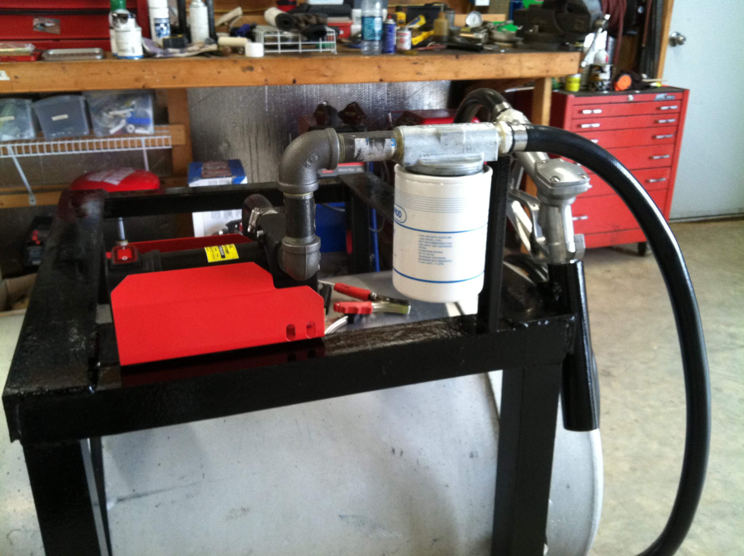

I am gonna tap the plug on the bottom or one of the ones on the sides and add a valve so I can drain if needed. How is the right side of the outlet mounted? I can see a balck piece of steel going up toward the outlet line of the filter, but cant tell whats going on there. Maybe if you get time a pic there would work.
Mine has a sump drain plug there already. That piece of steel is just spot welded to support that end of the filter. It is NOT attached but the filter outlet fitting is just resting on the top of it. Its really not needed, just overkill on my part. If I had to do it again, I wouldn't put it back. The 3/4" nipples torqued together don't budge one bit. I did add extra rubber bushings under the pump housing (sheet metal base) to provide a good sturdy mount.

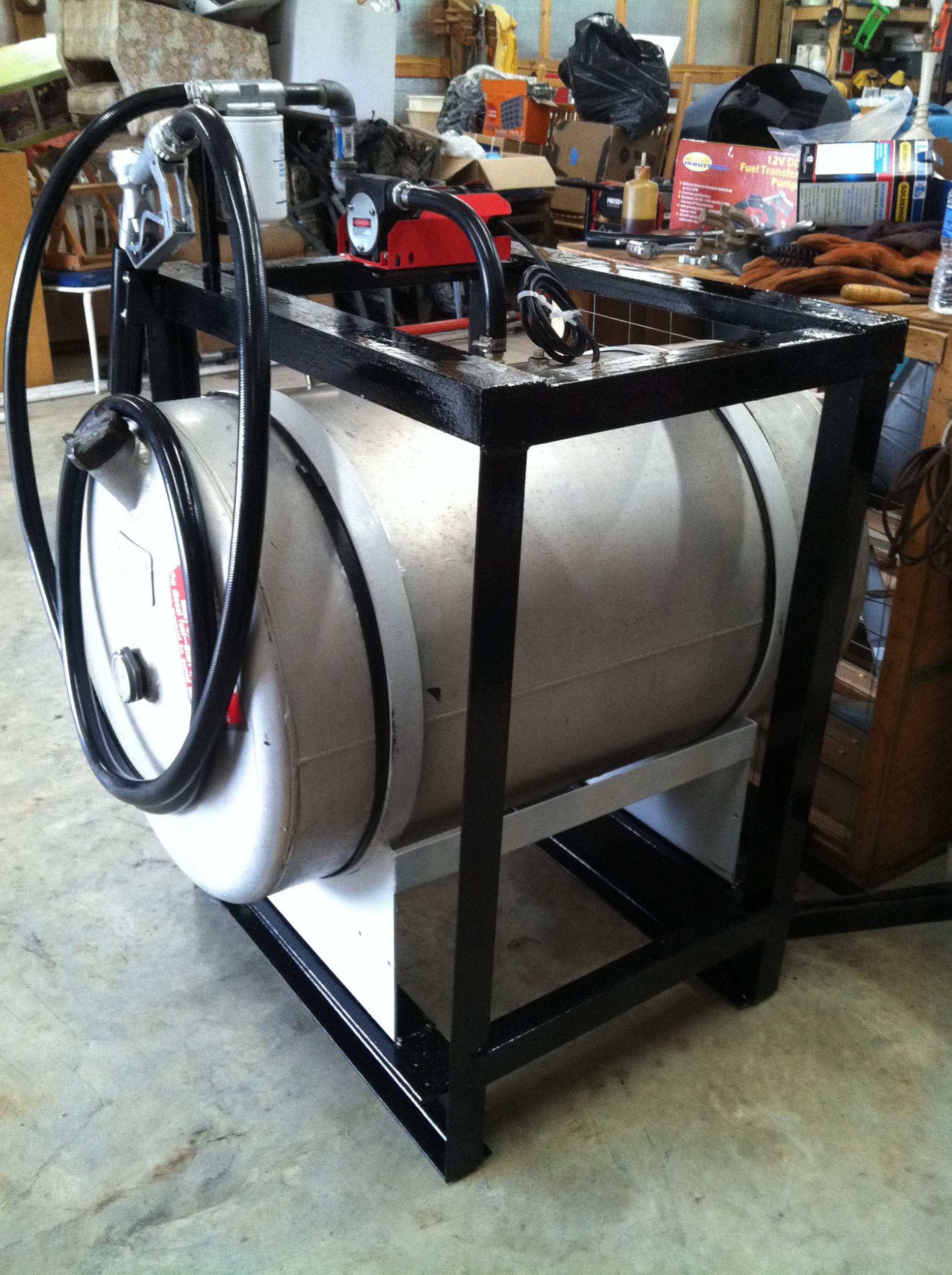

I just made a post showing a fellow what I made last summer. I used the same Northern pump and water blocking filter..Total cost less than $200. I did have corrosion under the saddle straps from road salt and I cleaned that up prior to mounting it. I used an external fuel sealing compound to paint over the aluminum where I removed the corrosion. That isolates the steel bands from the aluminum and stops dissimilar corrosion. Easy to transport to off road fuel station.

The pump has an internal bypass that kicks in when it builds up back pressure. The tank had a sintered breather vent next to the outlet fitting. Just thought I would add that it pumps at least 10 gpm. A lot faster than the gas station pumps. Doesn't cavitate or create any type of vacuum in the tank. I'm really impressed with that northern tool pump.

I took a piece of flat and wrapped around a piece of pipe bout the size of the tank to make the straps.

Update. Got a bit more done.
1st pic - trying to figure out pump placement.
2nd pic -you can see lifting points, nozzle holder, shelves, straps with part of turn buckles welded on, chains to hook to other end of turn buckles, brace for holding pipe with fuel filter mounting base, and some bad welds.
3rd pic - we got it grinded, wire wheeled, and primed right before storm came in.
We still need to finish painting and clean aluminum fuel tank before mounting. Also need to make sure we put something between aluminum tank and metal straps or the steel will rot out the aluminum if my memory serves me correct.
