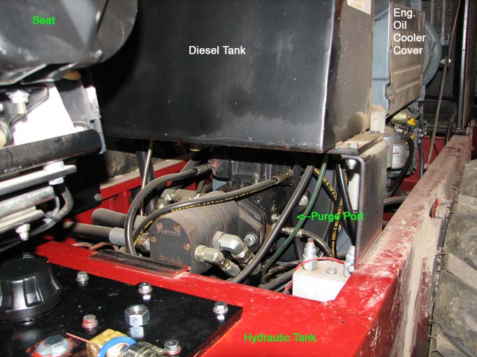

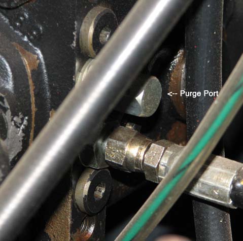

Todays project was to fix all the stuff I had chose not to over the past few months. I have had this nagging leak in my tram pump, where the hose comes out of the left side.
Terry had sent me a repair kit that had consisted of the two brass nozzles on the side of the pump and one extra washer (these are brass washers with o-rings built in
(see the bottom pictures on this page) USA Discount Generators - Standby and Portable Gillette Generators
These adapt from Metric to SAE. The old ones take a #18 Metric to remove. Well, I installed the replacements and one of them was not a #18 but a 3/4". Hmmmm. And when I went to replace the Hex Plugs the 3/4 was too big and blocked the hex... So, I put the new washer on the old fixture and am hoping for the best.
A bit of trivia for anyone having leaks in this area on the 1850. There is a hex plug on the underneath of the tram pump. It is a different size than the ones on the side of the pump. It takes a Metric #5 Hex. The sides take a Metric #6...

Here are a couple of pix from Ksimolo who is a much better photographer than me...
As for why I was sent the whole fitting and not just the Bonded Seals is a mystery to me. The Seals were allready on the fittings so it made me nervous pulling one off to put on the old fitting...
My supplier did not ship me any seals for the hex bolts which were leaking, so I had to go to Napa for O-rings. It will be interesting to see if they work out as they appeared thicker to me than the stock...
Carl

The bonded seal is 2 piece. If you take one off and it comes apart, no big deal. Just put the o-ring on first and the washer next. Some manufacturers actually sell them as 2 different part #'s and you assemble it.
The o-rings from Napa were thicker as most fitting o-rings are thicker than what comes in most generic kits. If it doesn't leak, don't worry.
The fittings are definately not brass. No big deal, just an fyi in case you order them or go to get them as brass is lower pressure.
