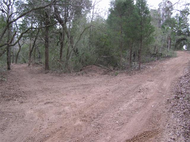

Chiege, The past couple of weekends I have been working on a perimeter trail on my property. 95% of the brush is uprooted and moved out of the way with my FEL with teeth. Some big stubborn bushes need a little help with my backhoe. I make the trail at least 6 feet wide because that is the width of my rear tires and box blade. After The brush is removed I level and smooth it with my boxblade. I always carry a limb cutter with me and ever so often jump off the tractor and cut a few roots and limbs. You might think that 6' is too wide for a foot trail but walking two abreast is nice and it will soon grow in. The wider width also discourages spider webs. I use my golf cart and the 4' belly mower on my Farmall to maintain the trails.
Attached is a part of the trail that "Ys" off to a road. The trail looked like the brush in the middle.
This perimeter trail will be a 3.1 miles or 5K walk/run trail.
I have retired from the marathon runs after doing 15.

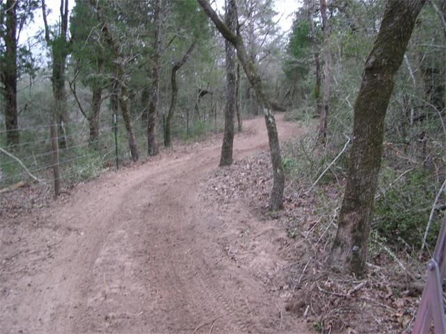

One more trail picture.

I long to move someplace that has some nice sandy ground like that; I'm so tired of CLAY...................
