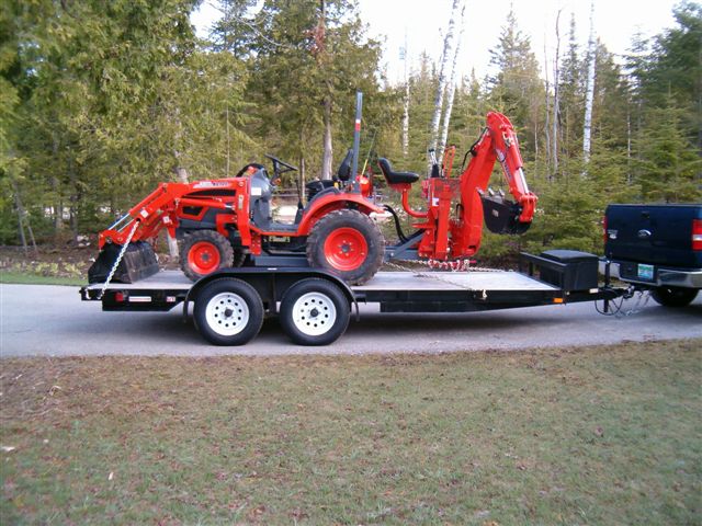

16 footer with two 3500 lb. axles for7000 total lbs. at a minimum. Bigger is always nicer so long as you choose to spend more and storage is not a problem.
Most everybody will tell you go bigger but i'm just saying this 16 footer works for me and I'm talking TLB. Pllenty of room to balance the rig out with 10% of weight on hitch also.
Take a look at the picture and note that I still have room for more load or adjustment especially if one turns backhoe boom to the sides. This trailer is a car hauler.

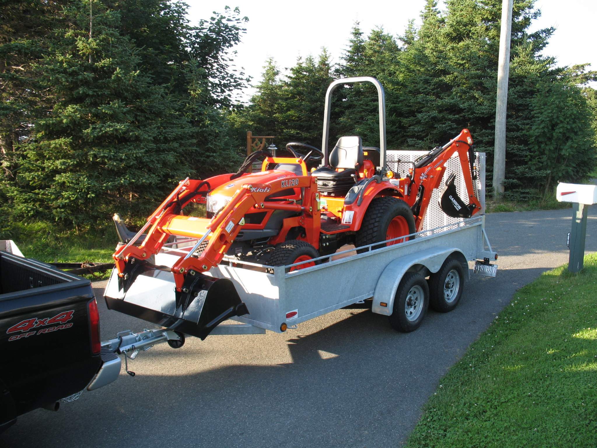

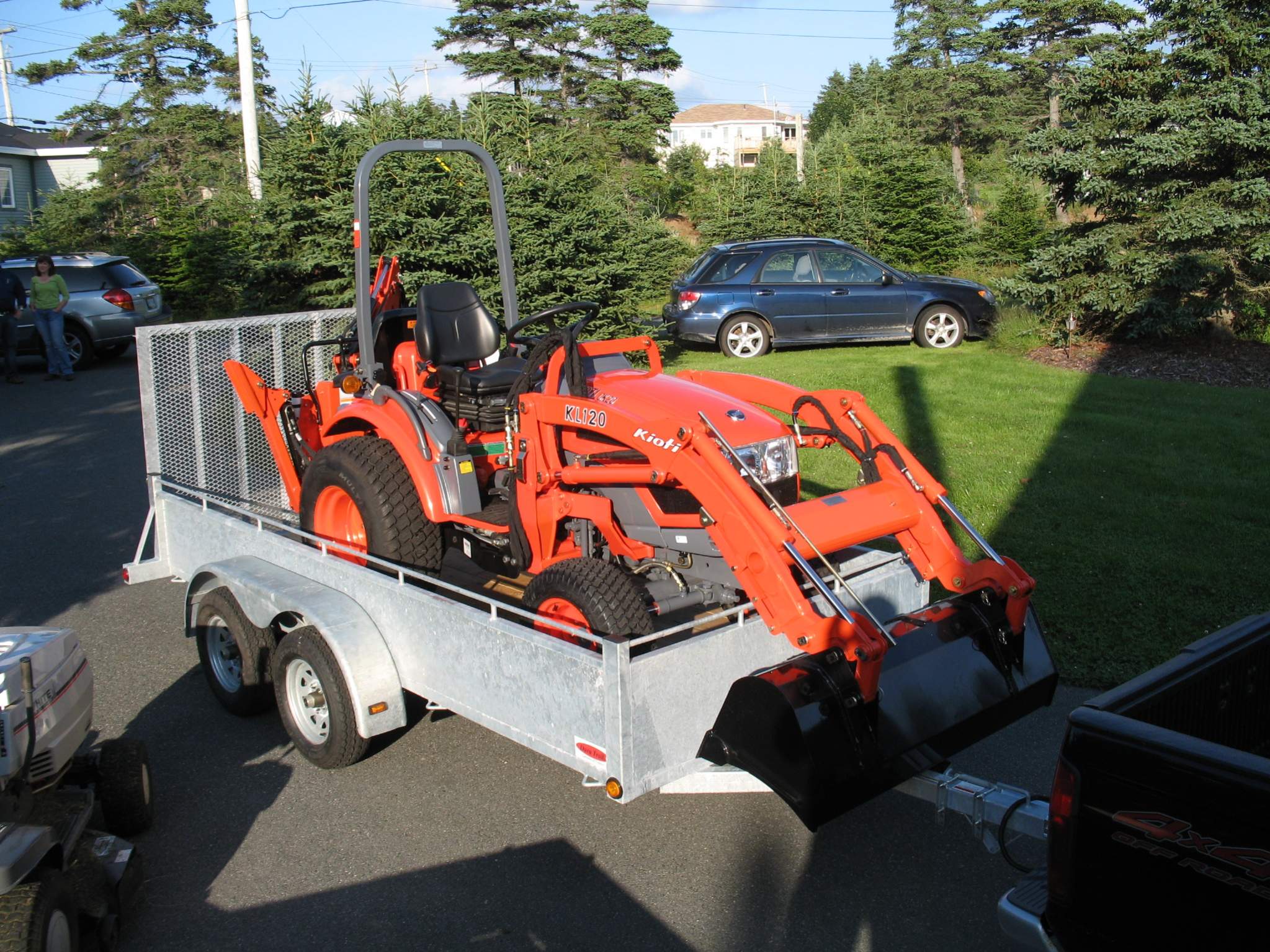

So, assuming you are trying for the economical answer:
I have a 12' (platform size, not including tongue) tandem axel with sides to allow for hauling other stuff. The front bucket curls over the front rail and the BH is turned to the side for the rear ramp to close.
If I had my time back I would go with a 14' platform, however I had bought the trailer just before deciding on the tractor. Mine's a fully galvanized trailer, and I got the LED light option, so I'll have it for a while.
