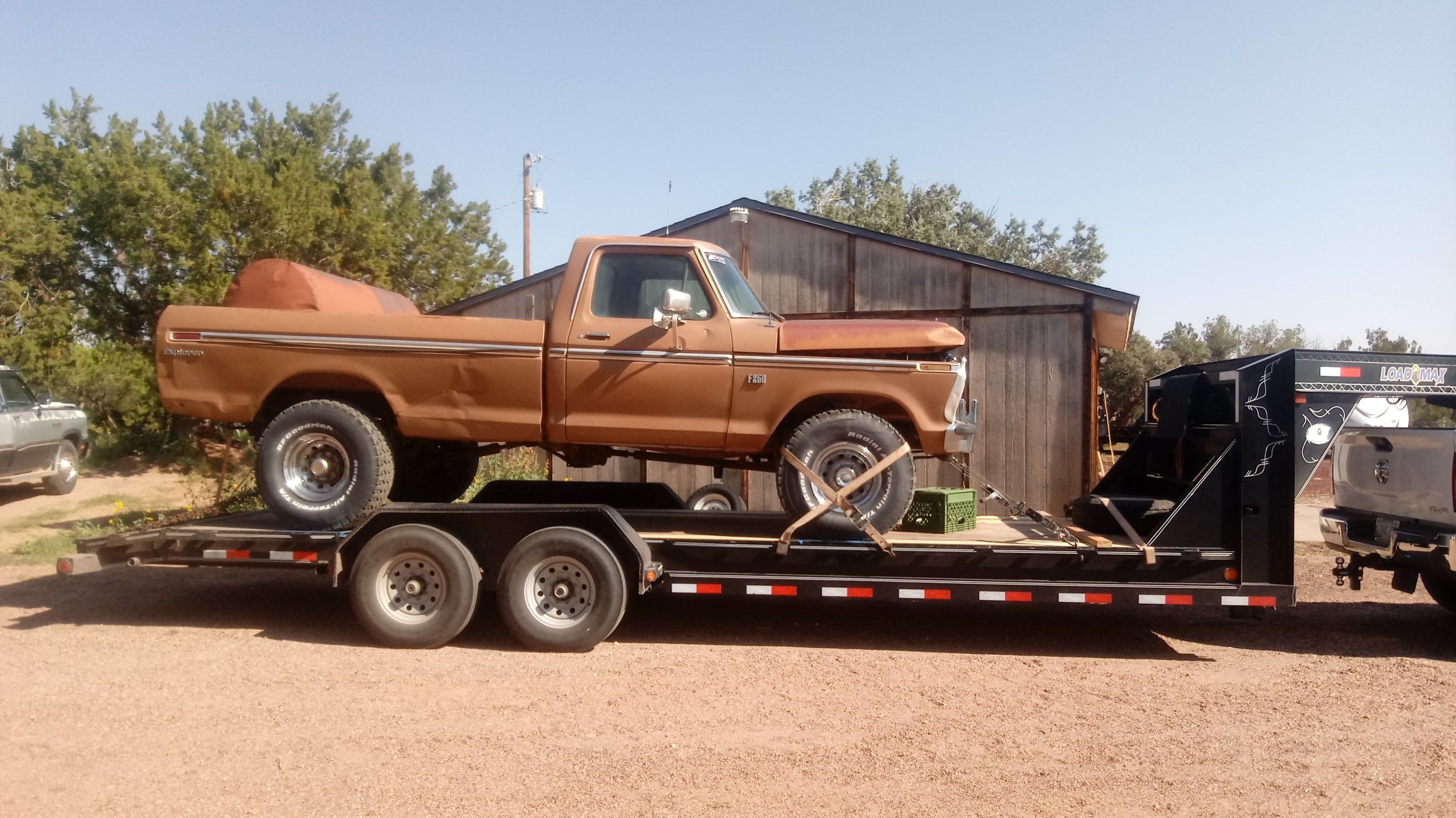

I trailered a car once on my trailer and that’s how i did it, through the wheels. Not all wheels are shaped in a way that would allow it though, openings that are too small.
/ Trailering passenger car #4

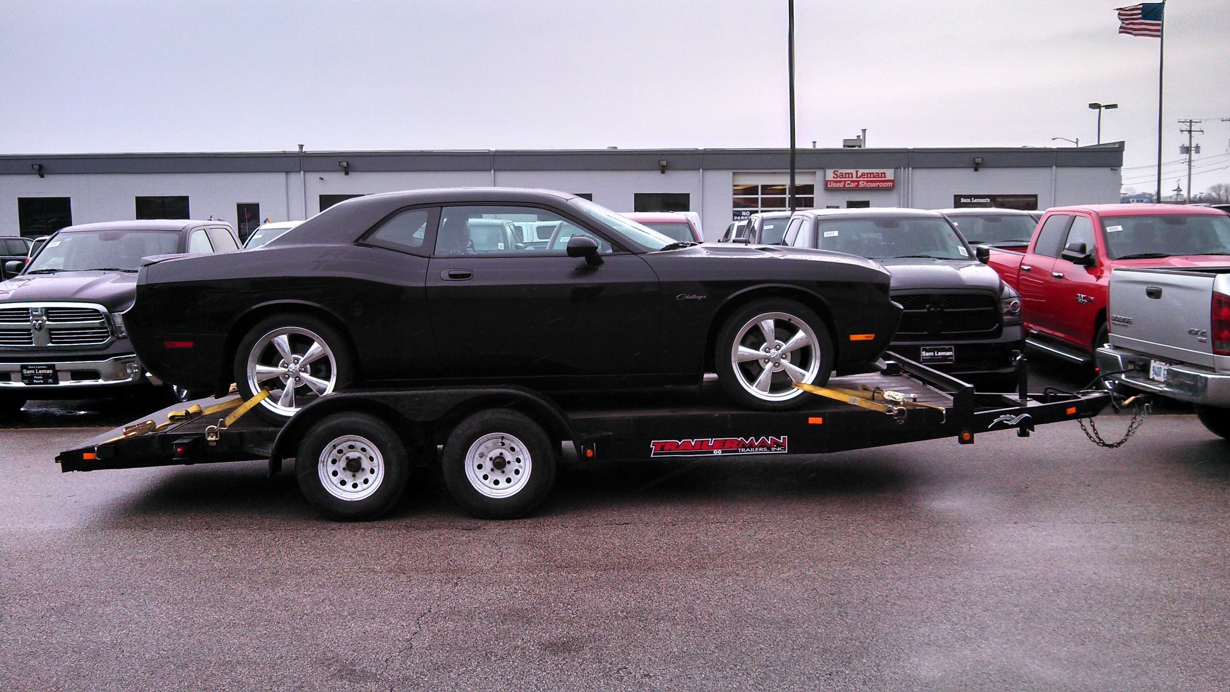

A picture of how I did mine.

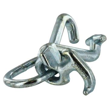

A lot can depend on the trailer design. Does it have rub rail for unlimited tie down locations, trailer fenders in the way and deck length. I carry several j-hooks and TJR hooks that fit oem vehicle frame holes. I also use a standard ratchet strap and cross tie it over the tires when that can work. Wheel nets are nice but expensive if you don't move a lot of cars.

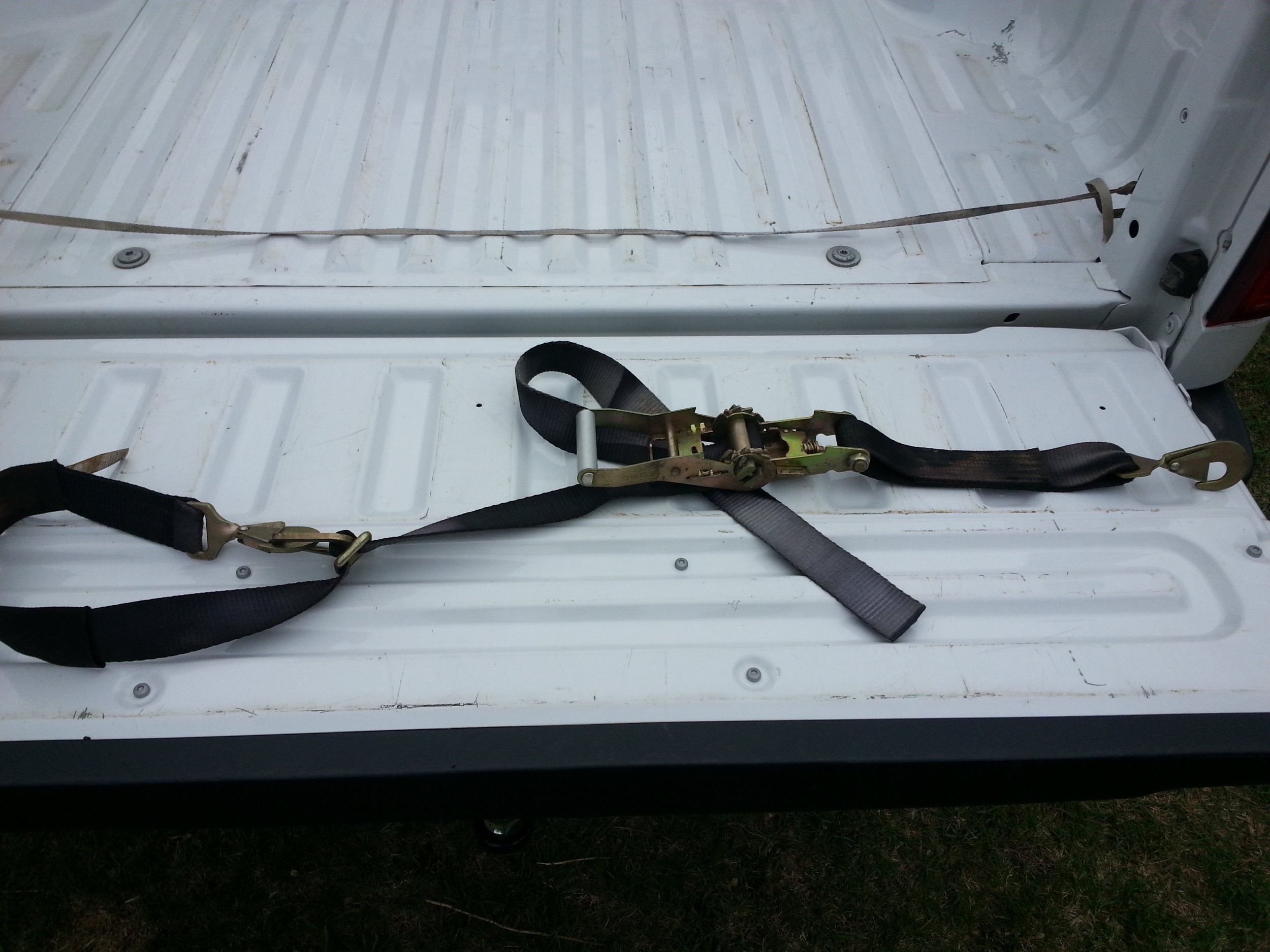

When I ran light-medium duty flatbed wreckers, I almost always used the JTR hooks like nisaacs pictured. Attaching directly to the frame section was always preferred. I would occaisionally have to use the large J-hooks and go to the solid rear axle and lower A-arms on older vehicles (pre-front wheel drive drek-and older trucks, etc). We NEVER ran straps through or over the wheels or tires. Good Gawd. That's just begging for trouble.
When I'm hauling cars for myself or others on my own car trailer, I use axle straps on all 4 corners.
Strap:
Sounds just like it should, the axle strap portion (on the left in the picture) wraps around an axle or lower A-arm at the corner of the car (or truck). On a classic or exotic car, it limits the chances of chipping paint or finish on something high end.

How about wrapping straps around axles?
Maybe? The problem is there is often something that will get damaged that is attached to the axle such as brake lines or wiring.
As far as sharp edges on wheels, some have them some don’t. In my picture of the Challenger above there aren’t a lot of sharp edges.
I've always been able to run the strap in such a way to avoid it snagging anything it shouldn't. Sometimes you have to study it for a bit to "see" how to run it.

is there a length of axil strap that you use most often for hauling cars, pickups or CUT's?
I've only used axle straps on cars, myself. For my old trucks, both were old solid axle 4x4's, and they were "unpolished" (not restored), so it was chains and binders on each corner.

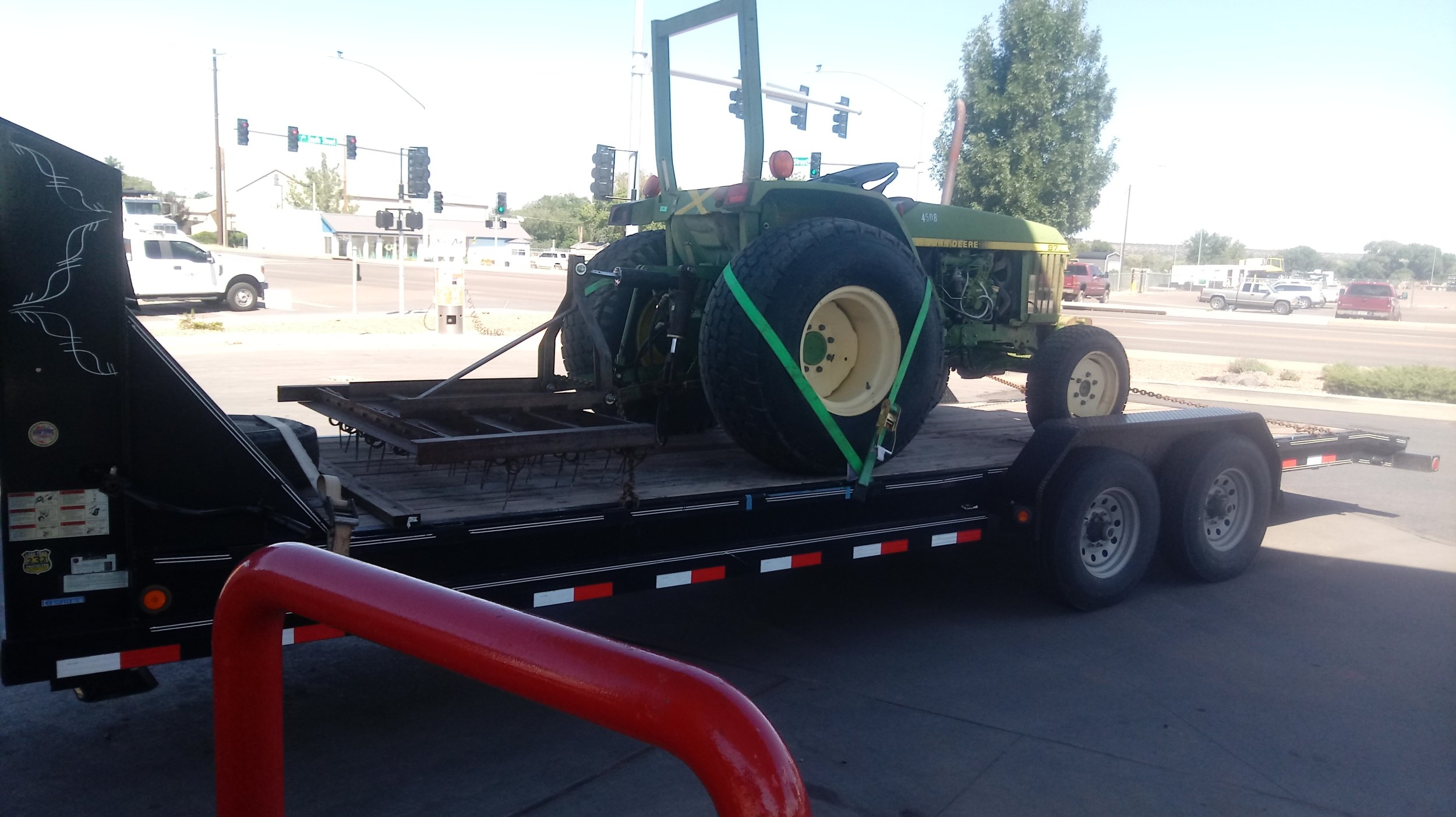

I run the same, chains and binders on each corner, when I haul my tractor.
The axle straps I bought from the picture, were originally for a 69 "B-body" Mopar (larger car). They will still work for hauling smaller modern cars, like my daughter's Corolla (emergency roadside towing, aka "Dad's Towing, Inc"), but they are on the short side on such a small car. It can also depend on where and how many tie downs your car trailer has on it. My enclosed trailer only had 4 (for the B-body). My flatbed trailer has stake pockets down both sides. I would measure from the car's suspension corner, to where your tie down point is on the trailer you intend to use, once you have the car sitting on the trailer where you want it (weight distribution).
