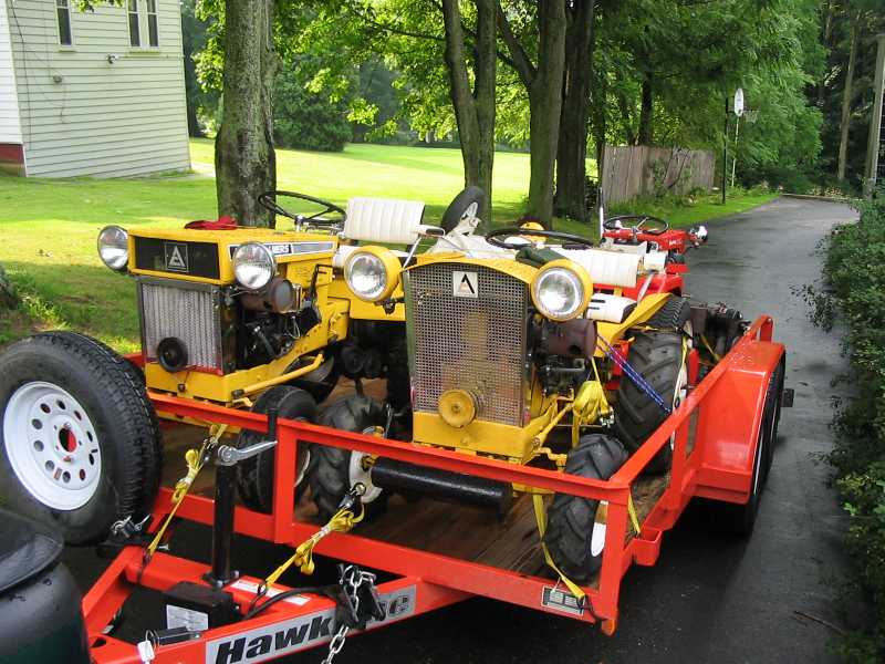

Then you should like this shot of my trailer enroute to the "Gathering of the Orange" show in NY last year... /forums/images/graemlins/smile.gif
That's a 1969 Allis B-210 (now 'customized" with a late-model hydro tranny and 16 HP) on the left, a 1966 Allis Big Ten on the right that I assembled from 3 parts tractors. On the back is the cherry, original 1968 Simplicity Sovereign 3012V that prompted me to go to Minnesota and haul it back. It actually came from SW Wisconsin, nust across the river, but I went on over to MN to visit friends and pick up more stuff to help pay for the trip...
