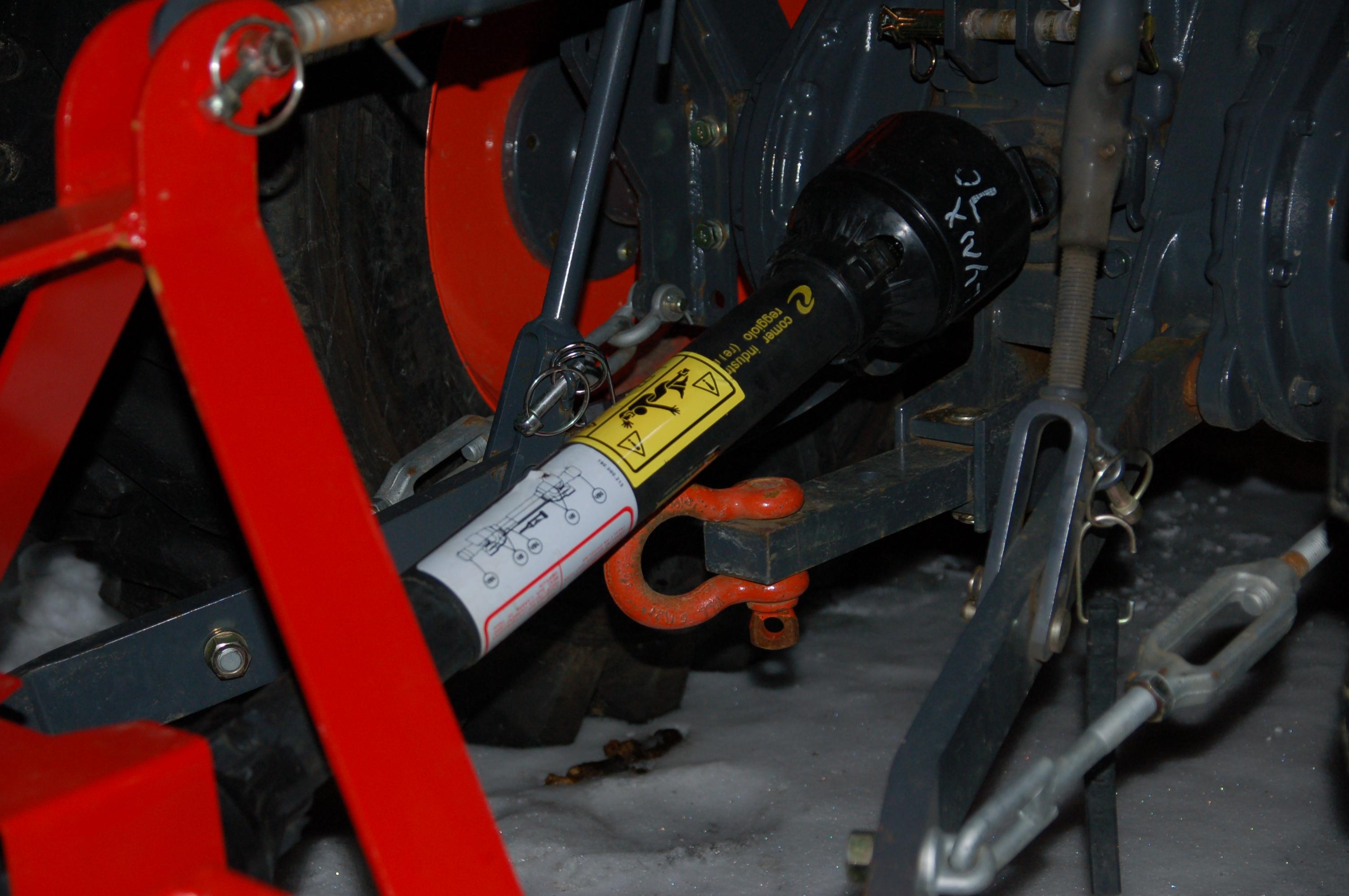

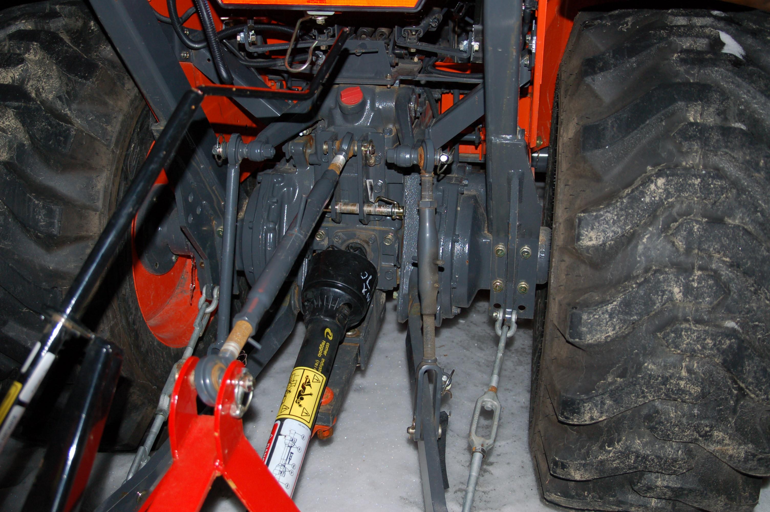

I have searched the state website in vain looking for the regs on trailering equipment and have yet to find anything. I'll probably give the SP a call after the new year unless the good folks here could give me some insight. I was told that all equipment must be tied down, separately, on all four corners, plus one tiedown for each attachment/implement.
My current chain setup has been as follows which I feel is safe, but if the lawman does not agree.... I have been using one chain either run through the tube on the FEL or between the grill guard and the grill and another chain through a clevis shackle on the draw bar in the rear.
If my understanding of the law is correct I will need to rethink my chaining options. I am thinking I can chain off either side of the front grill guard by either wrapping the chain around the guard and onto itself OR installing mounting some type of D-ring or U-bolt through the two factory holes in the guard (perhaps that is why they are there??). See the attached picture. As for the rear of the tractor, I am at a complete loss. I honestly have no idea where to chain the tractor on both sides unless running two separate chains to the draw bar would satisfy the legal requirements. And, for the "attachments" I would probably use ratchet straps over the FEL just behind the bucket and weave a ratchet strap over/around/through whatever 3PH implement happened to be on the back.

IMHO, unless there are specific tiedown points, the outer axle areas are the best place to chain to. Used fire hose if you can find it is nice to slip over the chain to minimize dinging the paint up.
Cross tieing the chains is perfectly acceptable and is about the only way to chain from the outer axle area down to the deck tiedown areas while keeping the chain off of other parts of the machine.

This is the general rule. Technically, if your load is under 10K you only need one chain front and one back but if you follow what you've been told above using 4 tie downs (one each corner) plus a tie down for each implement you can't go wrong and your load will be more safely secured. Check the Federal laws someone posted.
