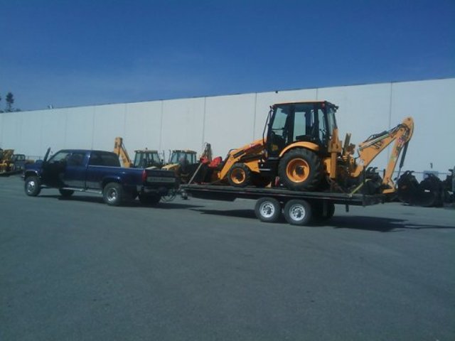

well, heres the JCB equivalent on my 18 foot deckover.

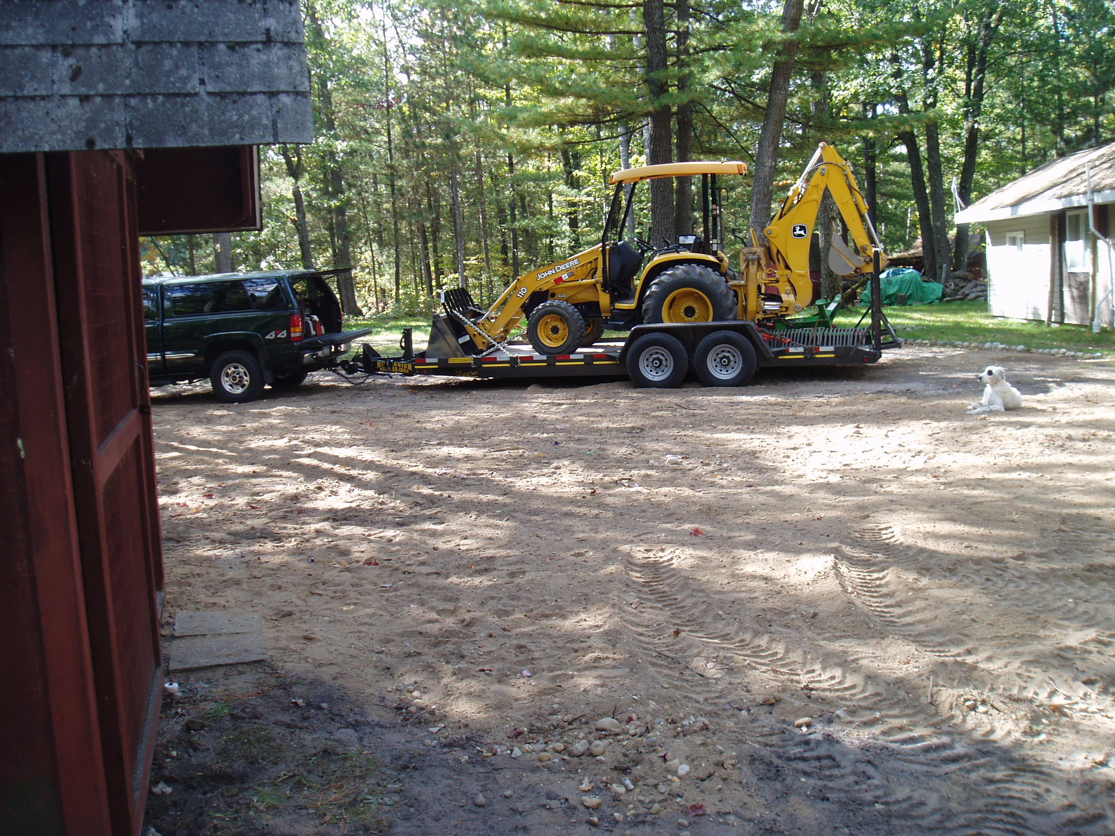

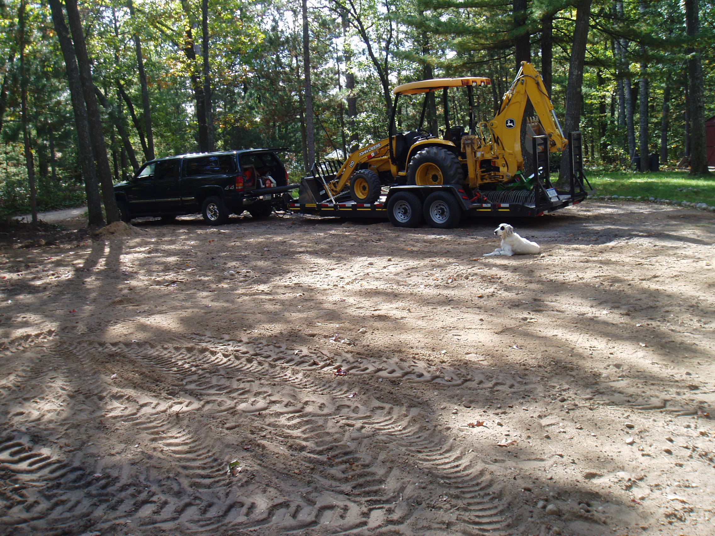

Here are a coulple of pictures of a 110 on a 20 foot long Millenium trailer. In these pictures I have taken the bucket off of tractor and turned it around on the trailer to give me a little more room. I also have taken the forks off of the mount for the pallet forks. When all was securely loaded on the trailer I then used the backhoe to slide the landscape rake under the tractor.
/ Trailering a 110 tlb
Paul, thanks so much that's exactly what I was looking for. Is your truck a Dmax? It looks like it's a tight fit. Are you able to adjust for load placement? It looks like your runnig a WD hitch. How does the whole rig ride?
Matt:D

Looks really stable with the trailer sitting low like that. Ever have any problems dragging bottom?
/ Trailering a 110 tlb #9
All it takes is a little hill and my 16 footer scrapes, but never had it dig in on the road, only leaving my driveway or other tight parking areas. My driveway is stones, gets a good collection caught in the back shelf (where the ramps are stored under the deck) Having an adjustable hitch is a must for a low trailer.
/ Trailering a 110 tlb #10
Truck is an 01 Dmax and it does a good job of pulling this load. The trailer does appear to be somewhat small but I have not had any problems getting all the implements on that I needed. Bear in mind that I usually don't take more than 1 or 2 implements at a time partly because of the room but also because of the weight. I have never had any trouble balancing the load and it trailers amazingly well considering the size of the load. I do use a WD hitch and that seems to help a lot. I have pulled the whole setup on the xway ( a couple hundred miles each way) several times now and it has pulled very well. Last time I pulled the tractor was the first time I dragged the bottom of the trailer even though I have pulled it 2 dozen times. The hill was a short but steep dip and I realized to late that I should have gone over the hill at an angle to avoid the dragging (I was going slow pulling in to a gas station). The low trailer seems to make the load more stable but you do need to be aware or small hills to avoid dragging.
