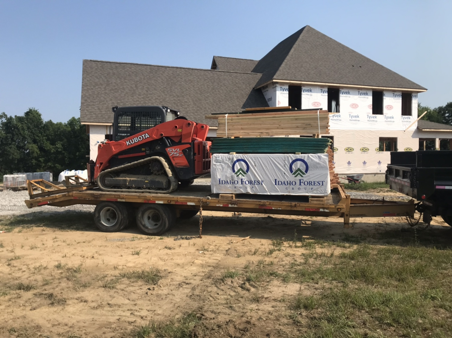

yep. most of us learn the hard way that you should err on the side of more front weight.
Load all of it on the front. Only part way kidding.
